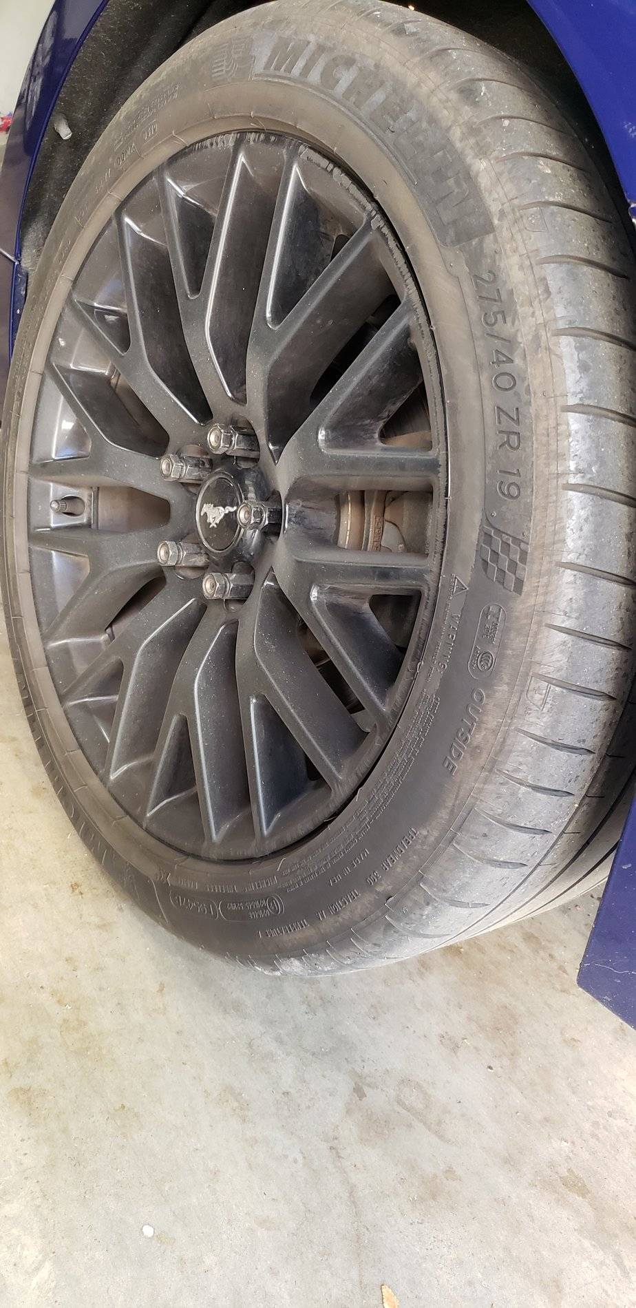

The answer I got from [email protected] when asking was:
"Thank you for contacting us in regards to your inquiry on the MONSTER LUG NUTS in M14x1.50
We recommend that the Torque spec is 90 - 95 ft lbs."
At that point you should be asking "what test methodology was employed in reaching that conclusion?"

Are you sure about that? The answer I got from [email protected] when asking was:
I understand the Mustang is 120+ but we recommend 90 ??? 95 with the conical seating."
Whoever this guy is, he has no fundamental understanding of how bolted joint works.

Thanks, that was some interesting reading. I'm not stupid enough to use my own "this should be fine" torque setting in lieu of one from the manufacturer just for fun, but in this case, there are two two manufacturers with conflicting recommendations (Mackin Industries for the lug nuts, and Ford for the studs and wheels).
Obviously the wheels and studs must withstand the Ford specified torque, but it's not obvious to me the third-party lug nuts will too. I've emailed Mackin again, since I did not get an answer last time on why their recommendations differs from Ford. Will update here when I get the answer.
Michael_vroomvroom
Dec 6, 2019
816
736
Spain
Michael
Mustang GT 2020, MT, EU (not quite PP1), Magneride
Actually I did, but I did not get a reply. I'll try asking again.
Unfortunately it seems I will not be getting any confidence inspiring answer regarding the Monster lug nuts.
I've sent them a handful of requests, and in reply they upped the recommendation from 90-95 ft lbs to 85-120 ft lbs. As to why that is still a lot lower than what Ford specifies, the last answer I got was that it was "so you wont have any stripped studs or lug nuts when tracking your car and removing wheels more frequently than just daily driving your car and only taking lugs off for tire rotations every once in a while. The specified torque spec from manufacturer is max torque that can be used on a lug nut when not being removed as often. ". From "Tony Rodriguez <[email protected]>".
I thought that sounded a bit silly, so I replied that "Ford does not list any alternative torque for the Mustang in case of taking wheels frequently off and on as far as I know." and asked for some clarification on how they had determined that this lower torque was correct to use on the Mustang, but even though I've tried more than once, I have not got any further reply.
I've re-torqued up to 120 ft lbs for now, up from the max of 95 that I got first time I asked a month ago, but not yet sure what I'll do. a) Throw the Monster lug nuts in the trash and go back to the OEM Ford ones? b) Try to torque the Monster lug nuts to 150 ft lbs first and see if they hold up? Unfortunately I'm not a mechanical engineer, so I'm not sure if them not immediately stripping on the way to 150 ft lbs means they will not strip while going around a corner while driving later. I'm thinking them not stripping immediately means nothing.
I'm thinking I'll do a) and consider the Monster lug nuts as money wasted on nothing, as I can't make sense of what they're saying, though if more knowledgeable people here think differently I'd like to hear it.

The correct torque will be 150ft/lbs for steel lug nuts (like the monsters) and stock studs, just like Ford says. The studs are 14x1.5 and larger than most cars people are used to, and that larger stud does imply a larger than typical torque value. Ford didn't make 150ft/lbs up, if you look that bolt up on a standard engineering chart, you'll see 148ft/lbs for that thread and diameter.
Pretty much the only time you'll lower that is if there is a special coating involved that reduces friction. This is not typical and usually only found with certain aftermarket studs. Lubrication means you will reach that clamping force with a bit less torque required. Unless you know this applies to you, it doesn't.
As someone who has swapped wheels literally over 100 times over the last 5 years, has owned 3 different sets of wheels, and 4 sets of lug nuts, and who autox/tracks regularly - 150ft/llbs keeps them snug for street and track, and you won't be at risk of breaking any studs. Its important to not torque or loosen lugs when the studs are hot such as right after you get off track (let the parts cool first), and don't crossthread anything. That's the only time you're really at risk of breaking something.
