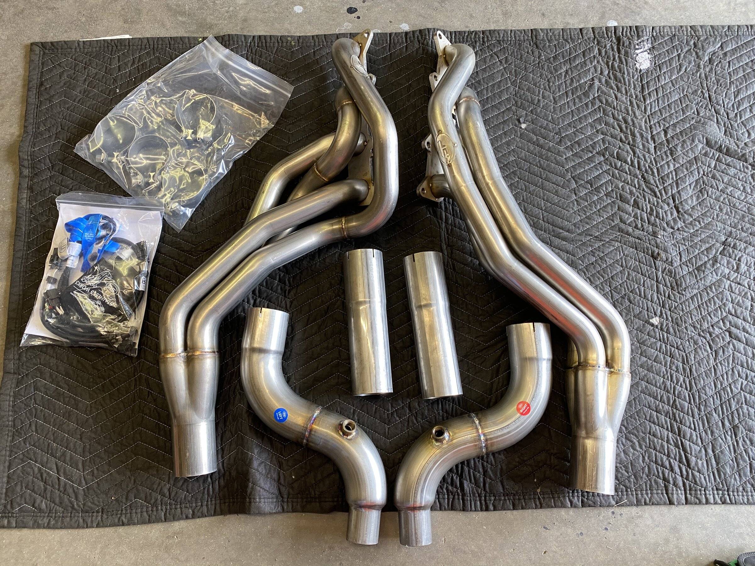

Stainless power longtubes I got were excellent fit n finish and didn’t break the bank. Installed on jackstands in the garage. Very happy with them. Did a quick write up somewhere on here.

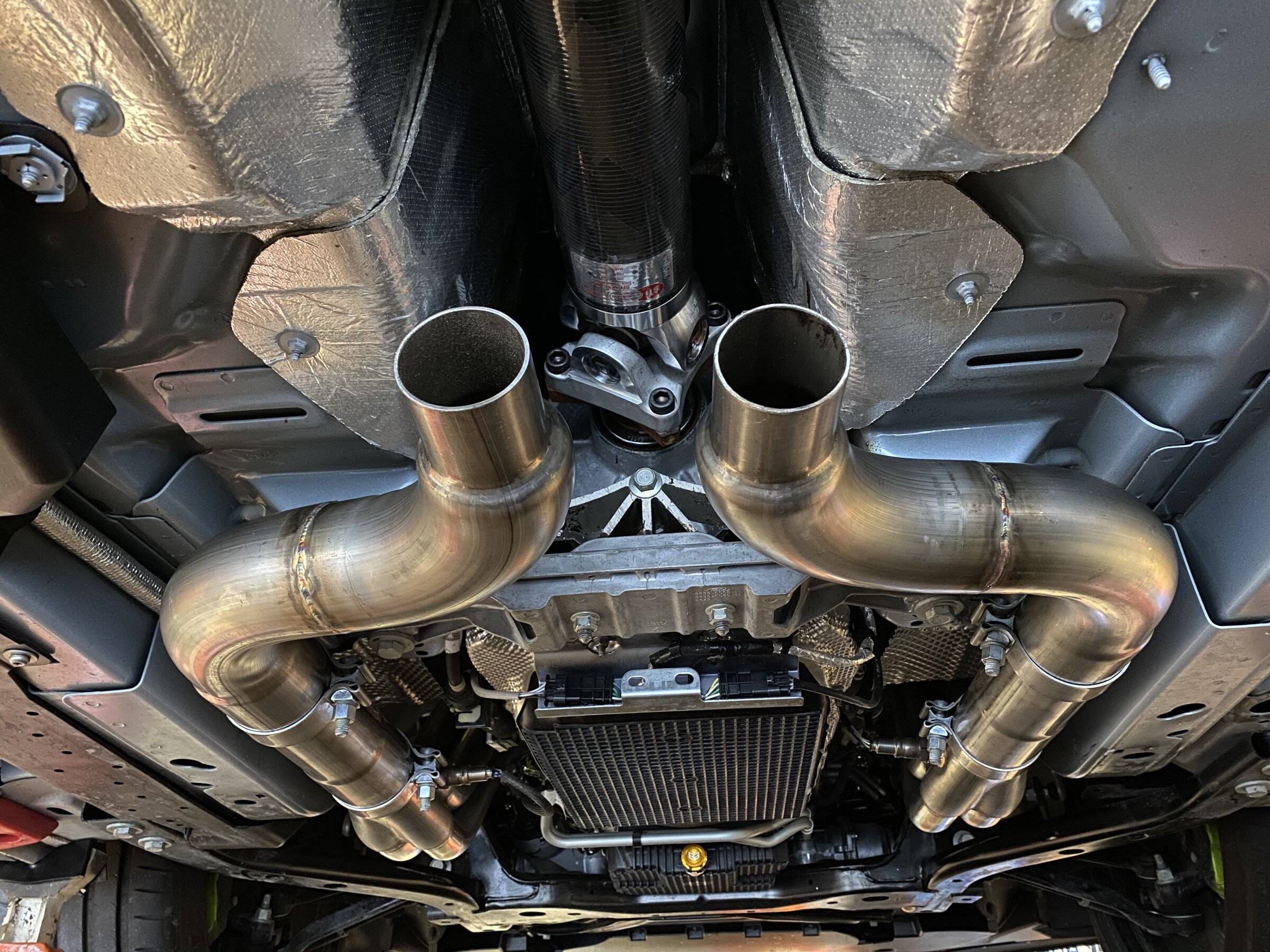

I had Corsa Xtremes paired to ARH long tubes but due to the trumpety tone cut off the rear Corsa section and added AWE Touring rear paired to the Corsa double x mated to the ARH long tubes. Full ARH Touring catback will sound a bit deeper and likely a tad quieter with the resonated H but this may at least give you an idea.
rocky5oh_eu
Dec 21, 2021
Unknown
Nabeel
EU 2019 Mustang GT PP1
You definitely get performance increase with long tubes. More efficiently when tuning for them as well.
Oh lord, she SCREAMS!! How’s it like cruising at highway speed? Can it be uncomfortably loud at times?
Nice set
0 drone. Cruising is mellow. But the fun pedal is instantly loud. WOT can be bonkers but nornal throttle has nice character in the low rpms without it being overbearing.
