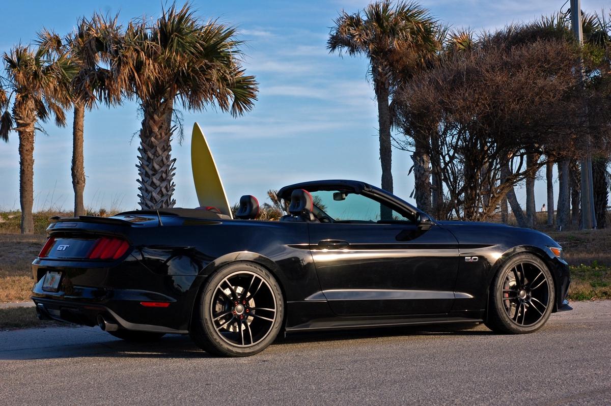

What size tires are you running. And can you get me a copy of the alignment specs?
I'm running a 285/35-20 front and a 305/35-20 rear, wheels are MRR in 20x10 @ ET35 front, 20x11 @ ET50 rear, the fitment is perfect (more offset that stock, but still tucked in so no clearance issues, even at that ride height).
Note those sizes are the same front-to-rear ratio as the stock PP setup.
Alignment is just a really exact stock specification.
Love the drop, wheels, setup...but that yellow spoiler coming out the back is just plain bad....:D
Well, the rear end was getting a little light at 165, so I had to do _something_.

I love that wing....what brand is it?

The wing or the "wing" ? :D
The larger yellow product is a Zap Pro custom, the smaller black, more permanent wing is an MMD by Foose.

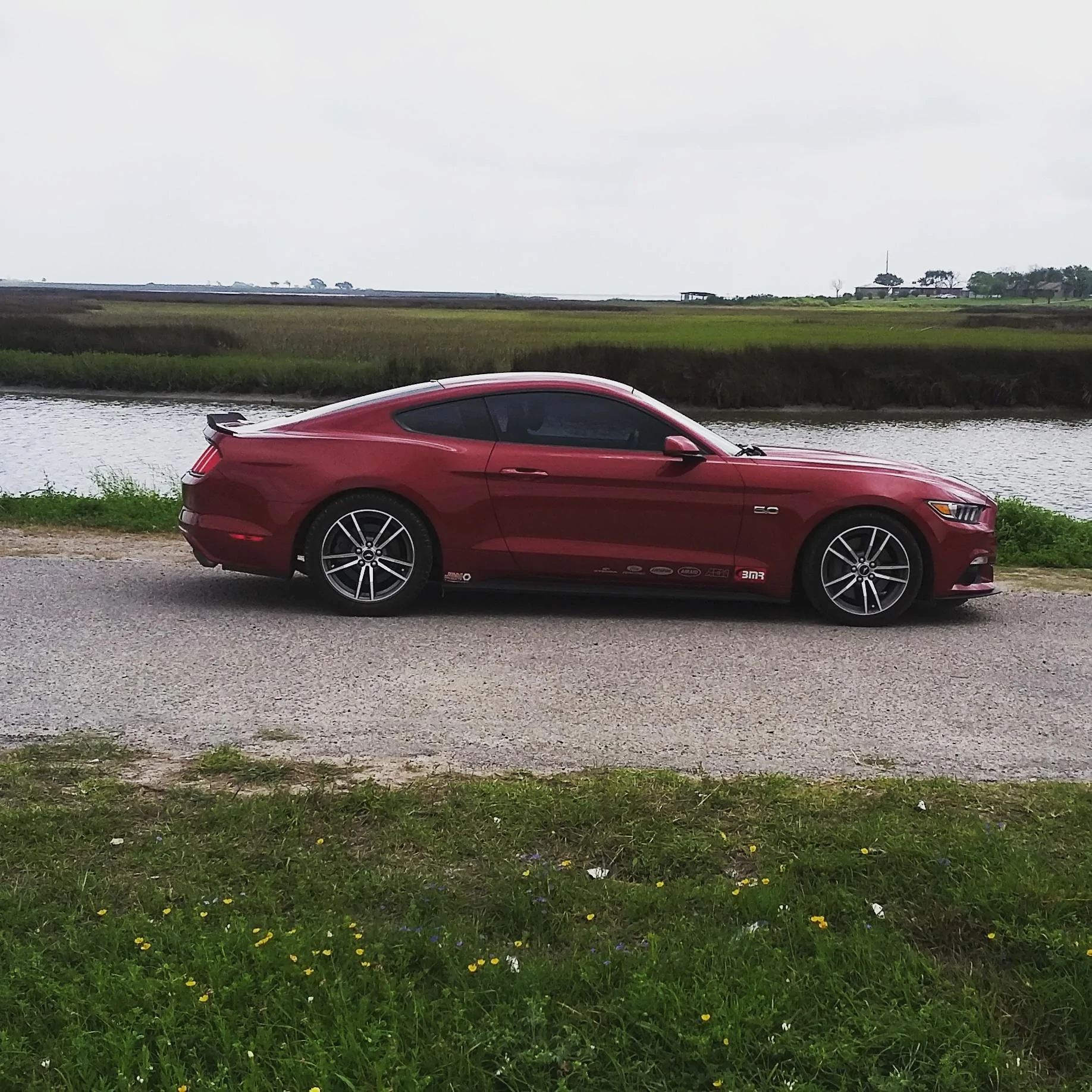

I wanted progressive springs so BMR was out of the considerations. I finally installed SVE which are Eibach pro kit spec or close. I drive 80-100 miles 5 days a week in many different situations. City & Hwy. With the OEM shocks & springs they work well at 26,500 miles.

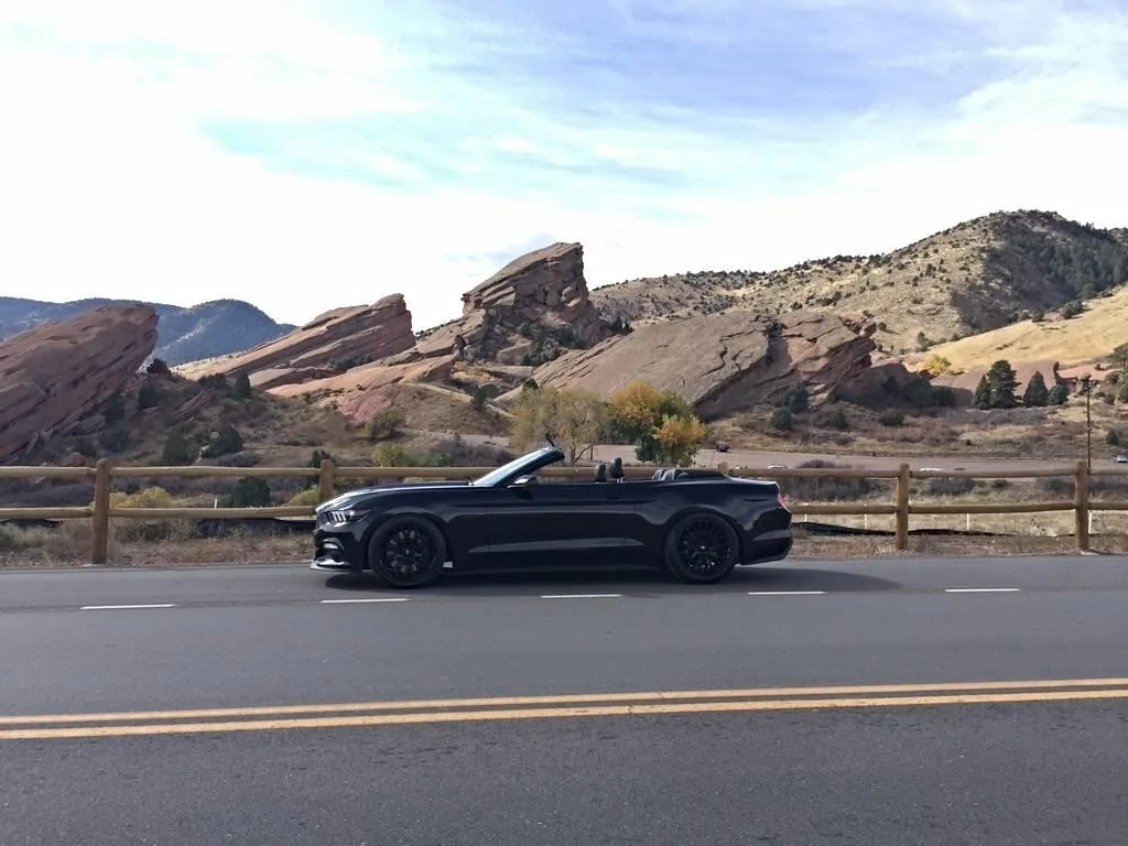

I have been very happy with my Steeda Progressives.
Really noticed the increased rate when I was driving up the mountains to Estes Park. It was smiles the whole way!
