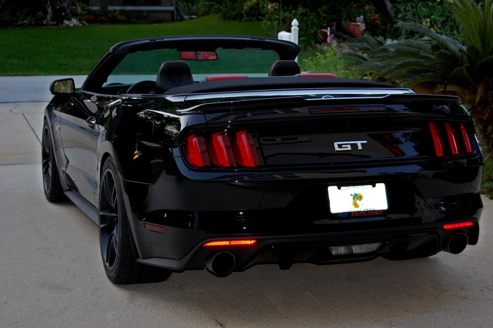

OK, here's a spring + wheels fitment shot for you guys, better photos of the wheels to follow, but this shows how _nice_ it looks with a really proper setup.
16 GT PP
BMR SP080 springs
MMR M600 wheels, 20x10 ET35 front, 20x11 ET50 rear
Nitto G2 tires, 285/35 front, 305/35 rear
Alignment to Ford specs
Fenders filled out, but still cleanly tucked, minimal gap, no rubbing ... *boom* :headbang:

Sitting very nice Brotha!!!!! :cheers:
