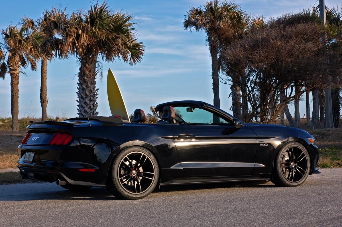

I believe it's just the amount of the drop, they're both spec'ed to 170lb/in Front, 740lb/in Rear (just checked).
My car sitting on the SP080 setup is _low_, it looks spectacular (especially with my wheels/tires), feels great (love linear springs).
