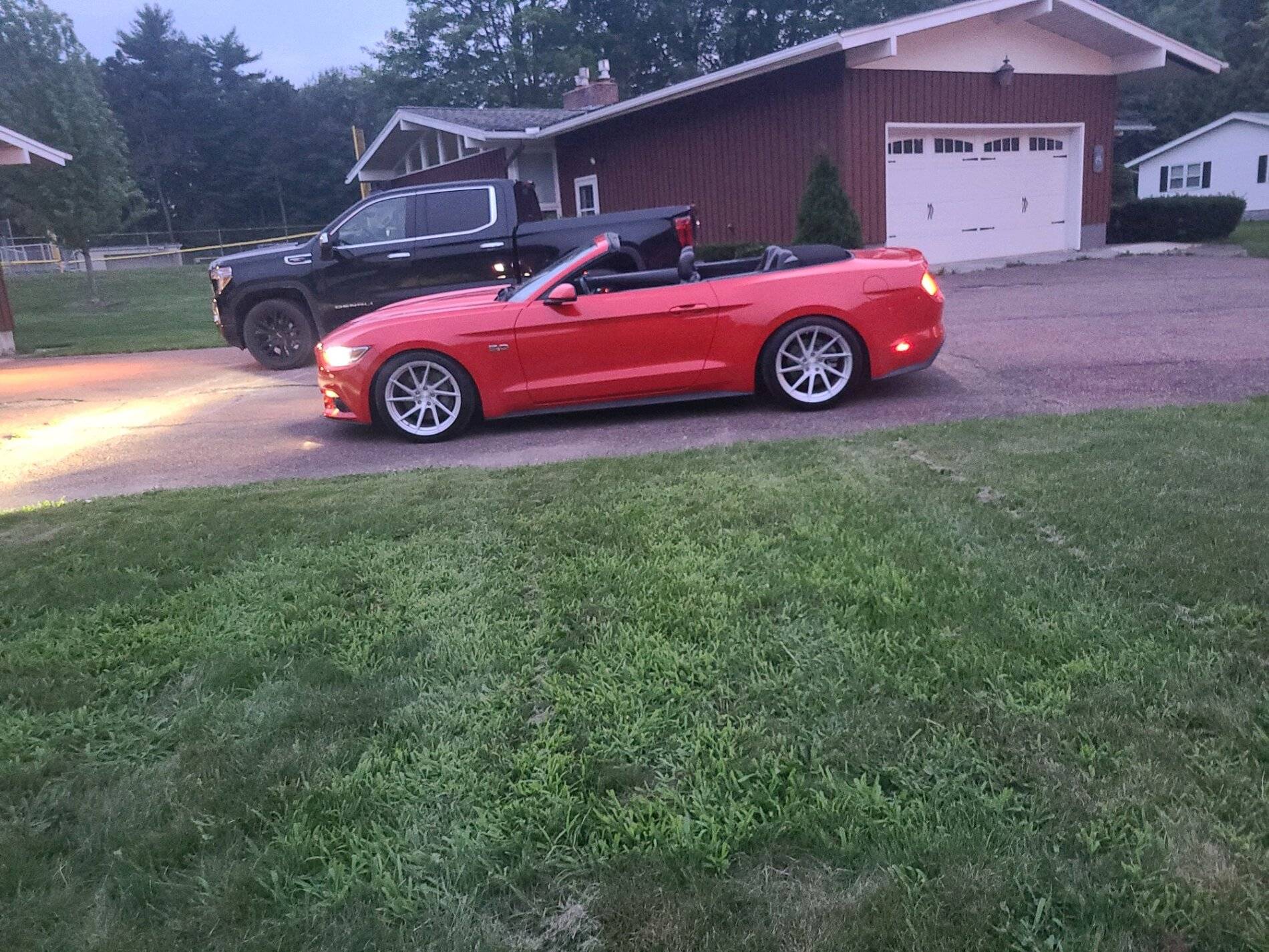

2018 GT PP! w/ magneride. I used steedas progressive with an 1/8 billet spacer in back. The verts sit lower in the back than a coupe due to the extra weight and the spacer made the wheel gap line up perfect with the front. The car looks great but there is a sacrafice in ride quality. i know everyone likes to say there isnt, but there is.
