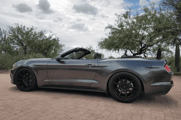

My apologies, some of them are more "specific" to Convertibles - I have a 2019 with the Progressives & the spacer - they are perfect.
This is a customer's car below with the Progressives:
