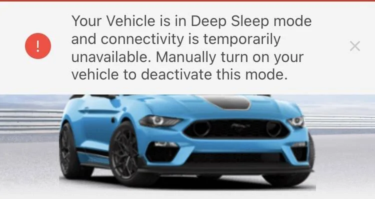

Mine is on a battery maintainer, windows up and unlocked, stored since November 1st. This screenshot is what FordPass showed 3 weeks after that date.

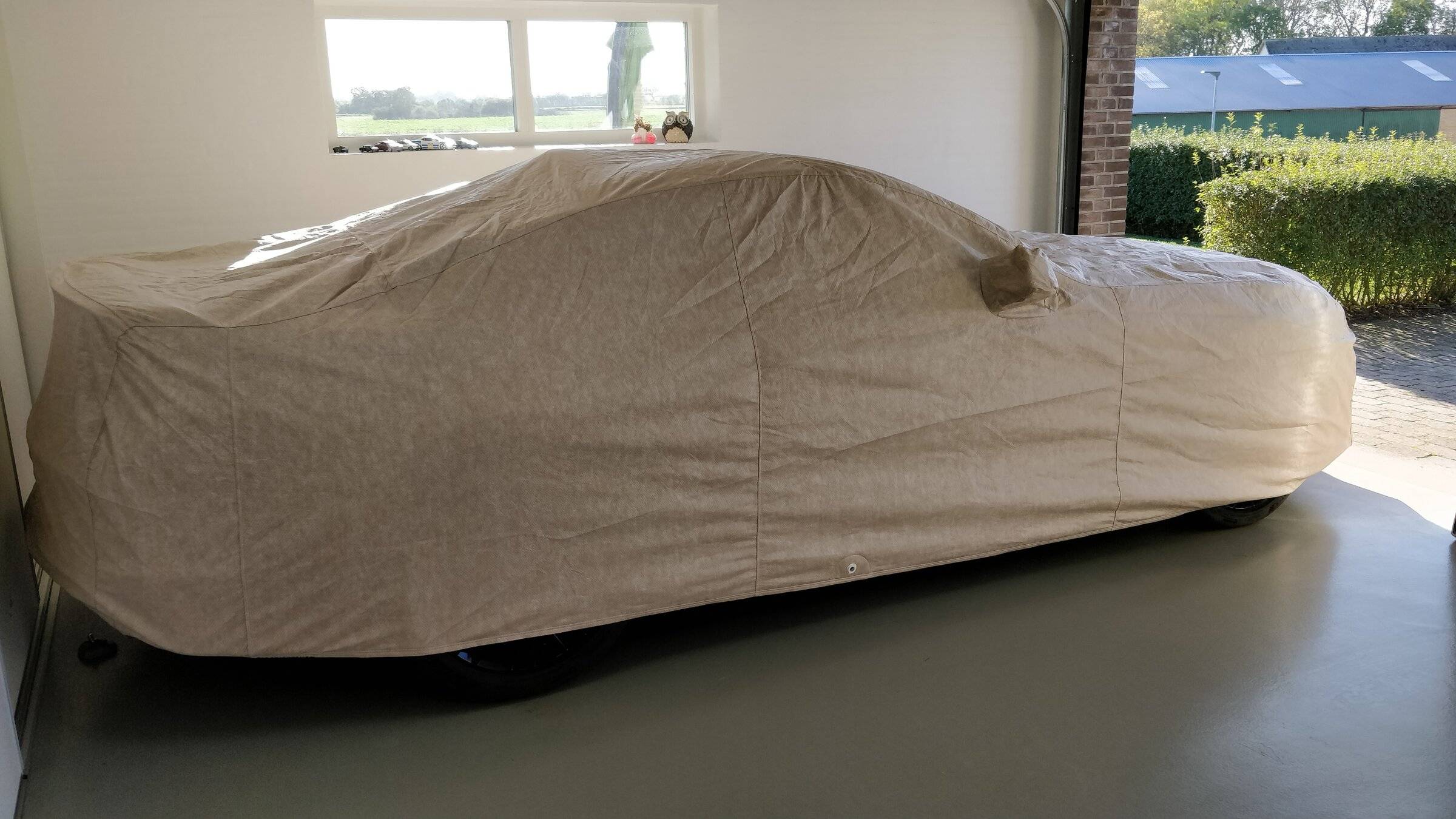

Battery tender, unlocked with hood popped and only soft closed
Windows are opened an inch for ventilation and then Covercraft cover
Stored in heated garage at 68⁰F
Was put away October 25th and will probably see daylight again in late March
EDIT: I forgot to add that I put stabilizer in the fuel tank and fill up before storage.

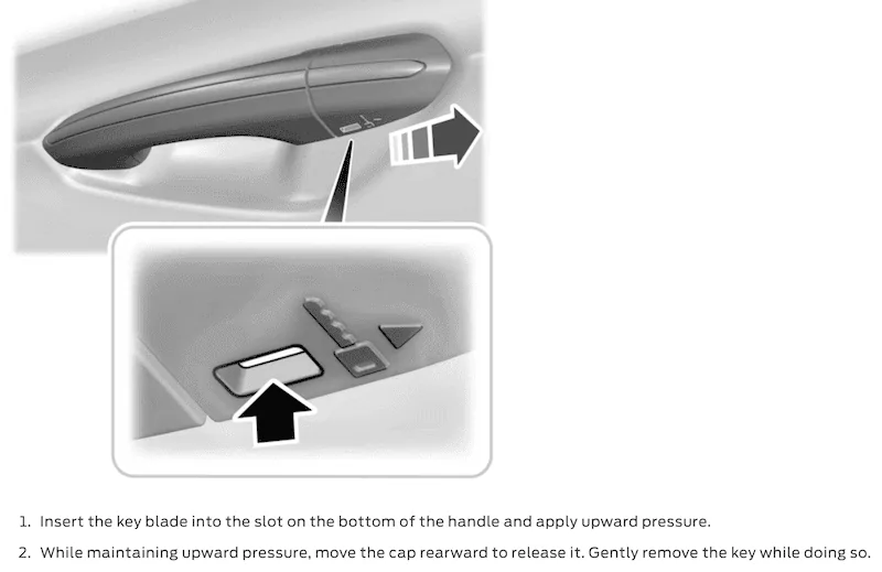

I'd be leary storing it locked. If the battery were to die it would be a real pita to gain access.
There is a manual access to a door, lock, user manual, reading required.

Yes, I know, I've used it before.
Doesn't negate it being a pita.
Mine felt like the key was going to twist off...
