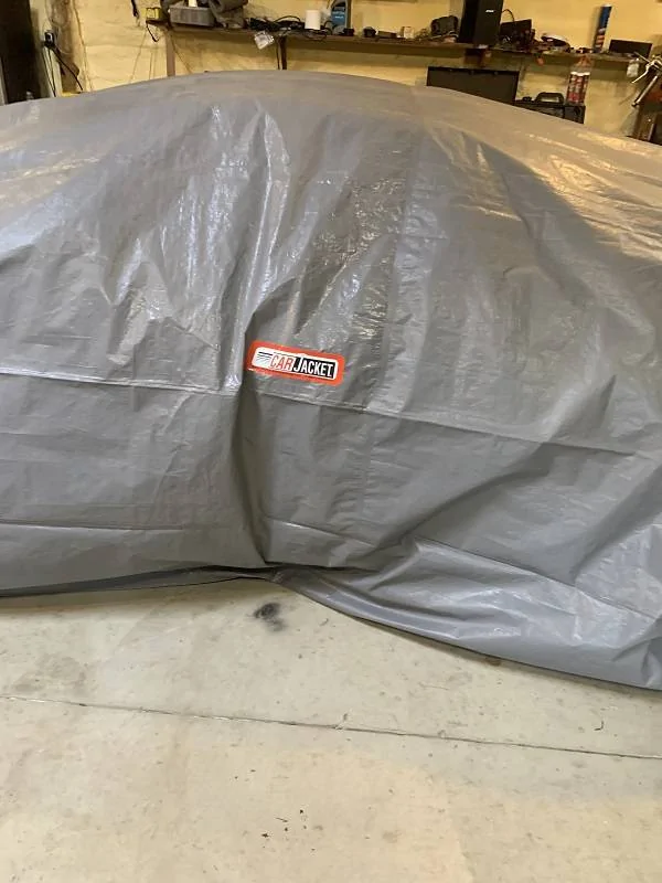

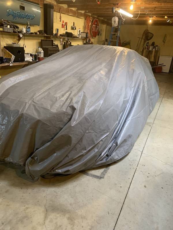

Change oil, fill tank with 93, add fuel stabilizer, inflate tires to 50lbs. Open both doors, pop hood, pull battery, soft close hood and doors. Add dryer sheets under the hood, and in the trunk and inside and under car. Cover the car, zip up car Jacket with a bucket of DampRid Hi-Capacity Moisture Absorber inside. Return May 1st weather permitting.
