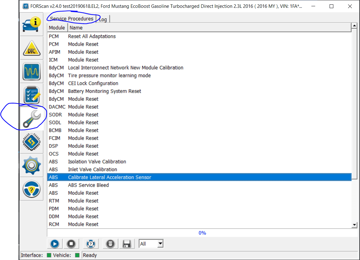

This is where you can find the place to calibrate the ABS module's lateral acceleration sensor:

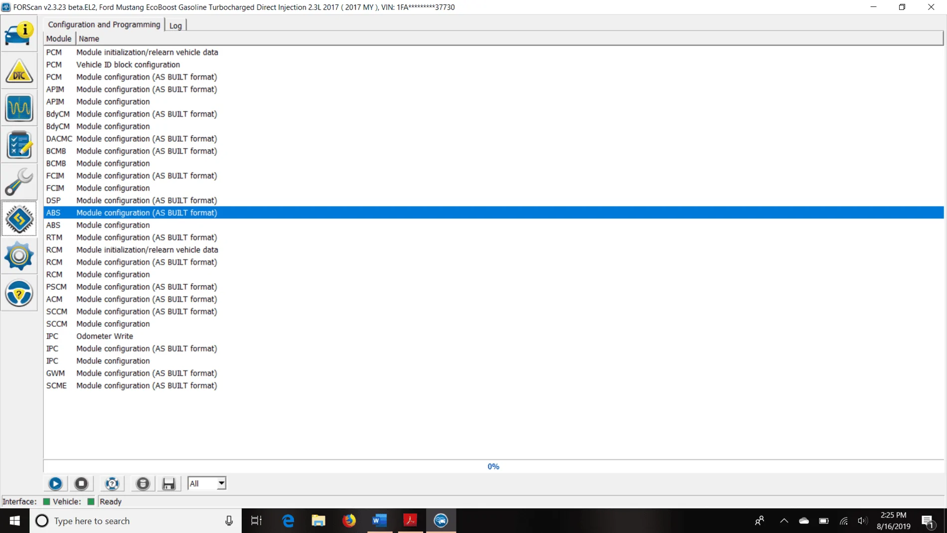

Downloaded the ForScan and started it up - connected to car and while I can see some information that is all it lets me do. I had to put the stock tune on also. The first time I got it to communicate it asked if I had an aftermarket tune on the car and said it couldn't read anything. Went to stock and it communicated and read data, but that is all. No way to get to those other screens everyone else sees and change parameters.

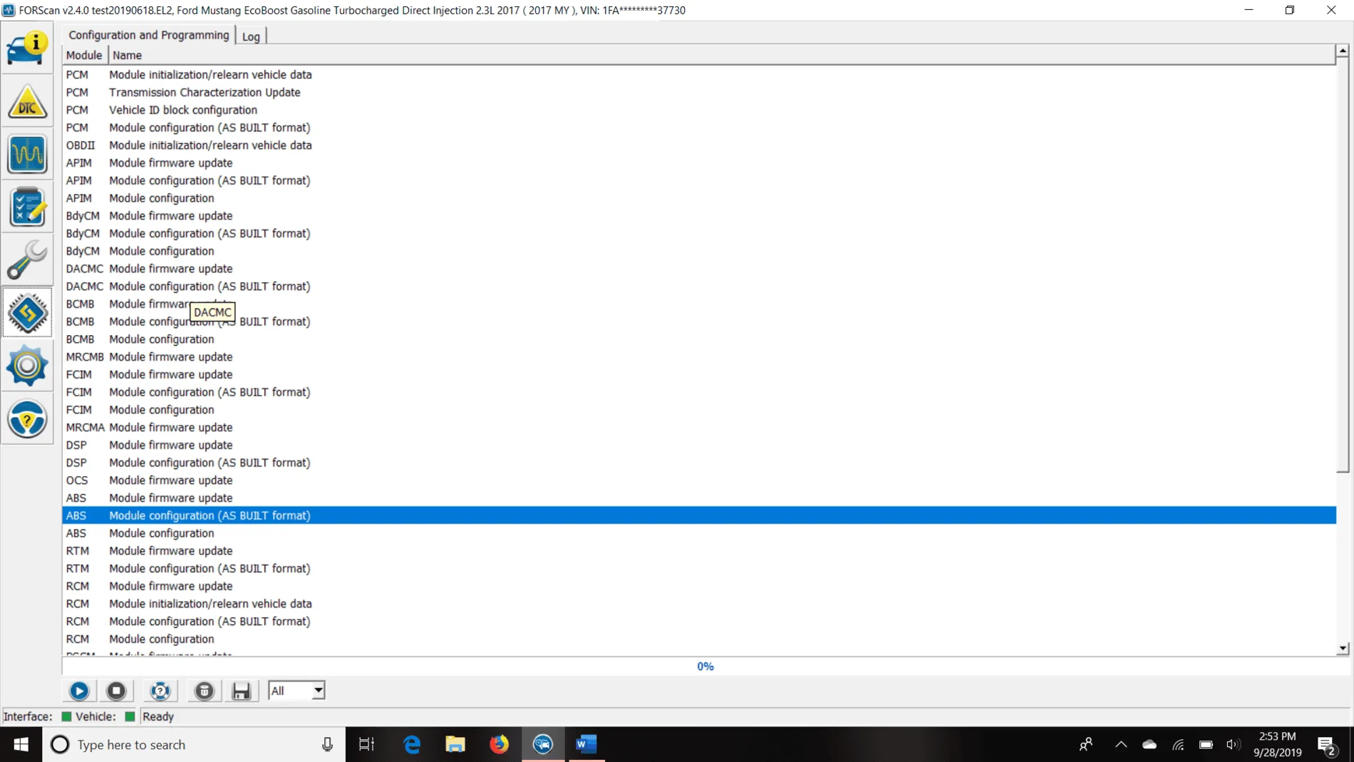

It was mentioned a few times in this thread that if you want to update firmware on the abs module with forscan, you need to request the 2.4 test version from the developer, but from your screenshots you are still running 2.3.

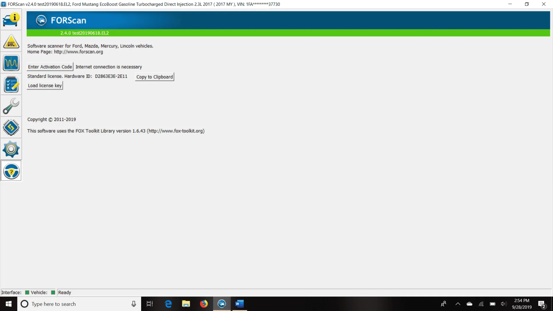

I thought that I downloaded 2.4 but apparently not. Still trying to figure out how to download it from the email they sent.

I downloaded 2.4 but still can't get to the programming for some reason

Do I need to get some activation code?
