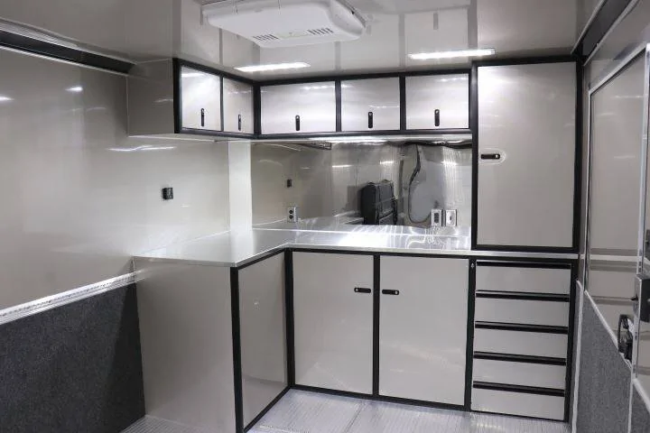

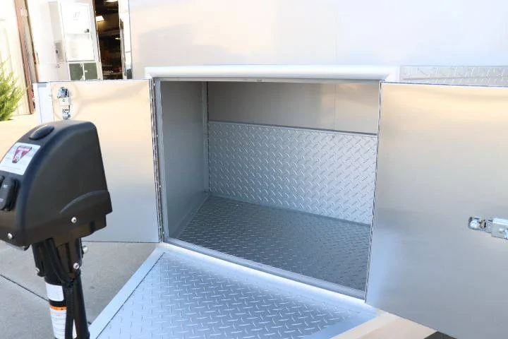

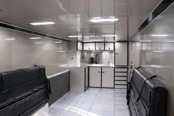

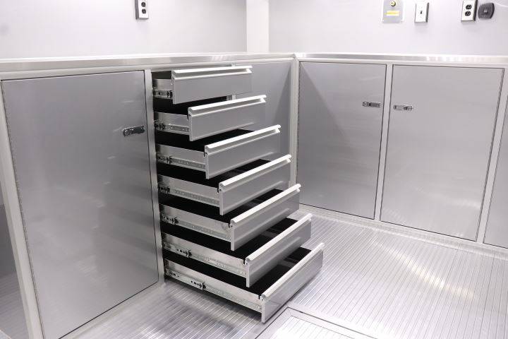

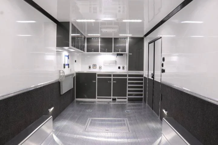

After years of using your typical steel/plywood trailers that come empty, I'm finally in a position to build a custom-spec'd trailer exactly to my needs. I spend about 30+ days a year at the race track (most of which I'm double-duty instructing), so I'm really focused on making my life easier, the trip safer for the car and its arsenal of tires/fuel/parts, and more comfortable in-between sessions.
I'm just starting a build process and would love to hear from those with experience...what are your must-haves, regrets, and would add on next time?
Currently, I'm looking at a 28ft tag with cabinets up front, gen box on tongue, storage for fuel in front cabinets, airline track on road side to secure tire stacks, couch on curb side with overhead cabinets, AC prep, insulated, and a couple other pieces.
Hit me with what ya' got (or friends)!
Some of my inspiration is below

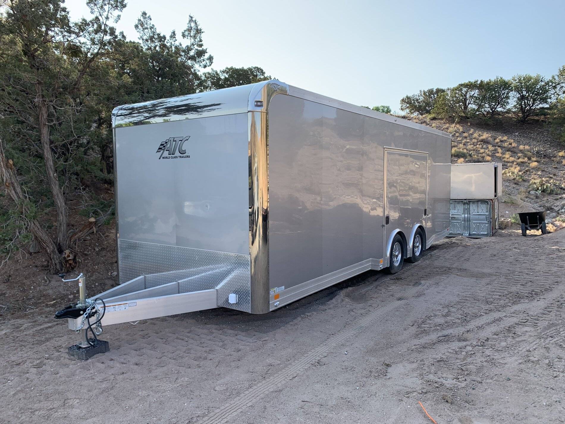

I have an Atc Quest 305, 24’. Happy to answer any questions. Absolutely awesome trailer.
Are you happy with the way your GT350 loads into and fits in that trailer ? plenty of room from the bottom of the door to the top of the tires after the car is pulled inside and you open the door to get out ? load angle works well ? Real nice trailer !! iam shopping for my lowered gt350 ... thanks for posting pic !

My 350’s are lowered to. I do have to use Race Ramps for the car to clear. Even with the fender removed and the side escape open its tight with the car door and the trailer tires. I don’t load mine with a winch but could. It might be easier for some then trying to get out. These trailers are about as low as any of them. Race ramps will be a must in my opinion for any of these trailers.

Beautiful trailer! Do you have either or both AC/insulation?

It is insulated and pre wired for the ac. I would suggest the spare mount as well. I had to order and add that. The down side to these trailers currently is price. I purchased mine in Jan for mid 20’s, new, there up 9-12k in price from then. As nice as these are I don’t think there worth mid 30’s.

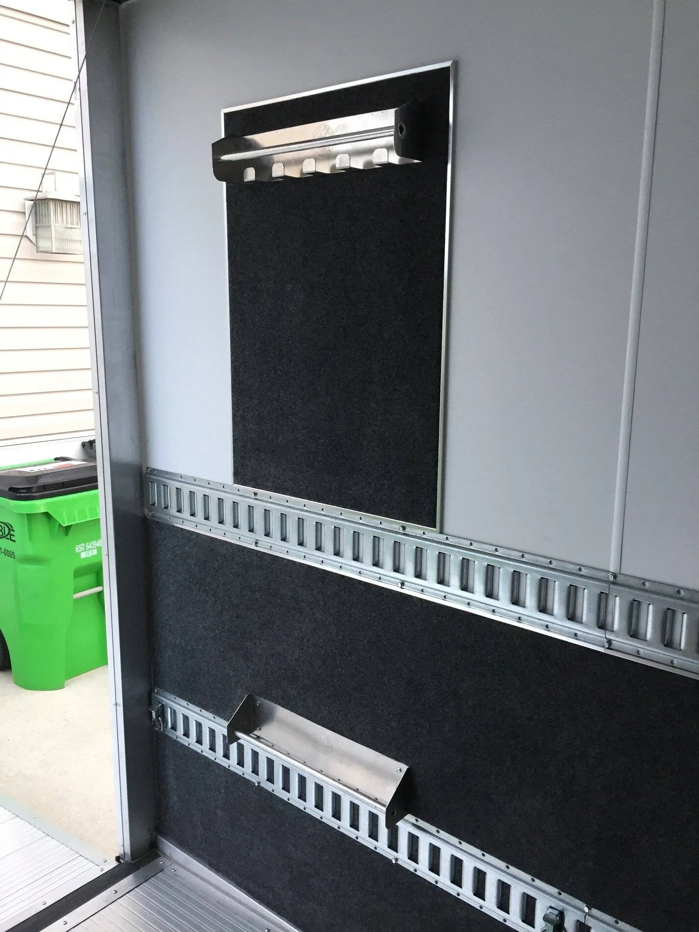

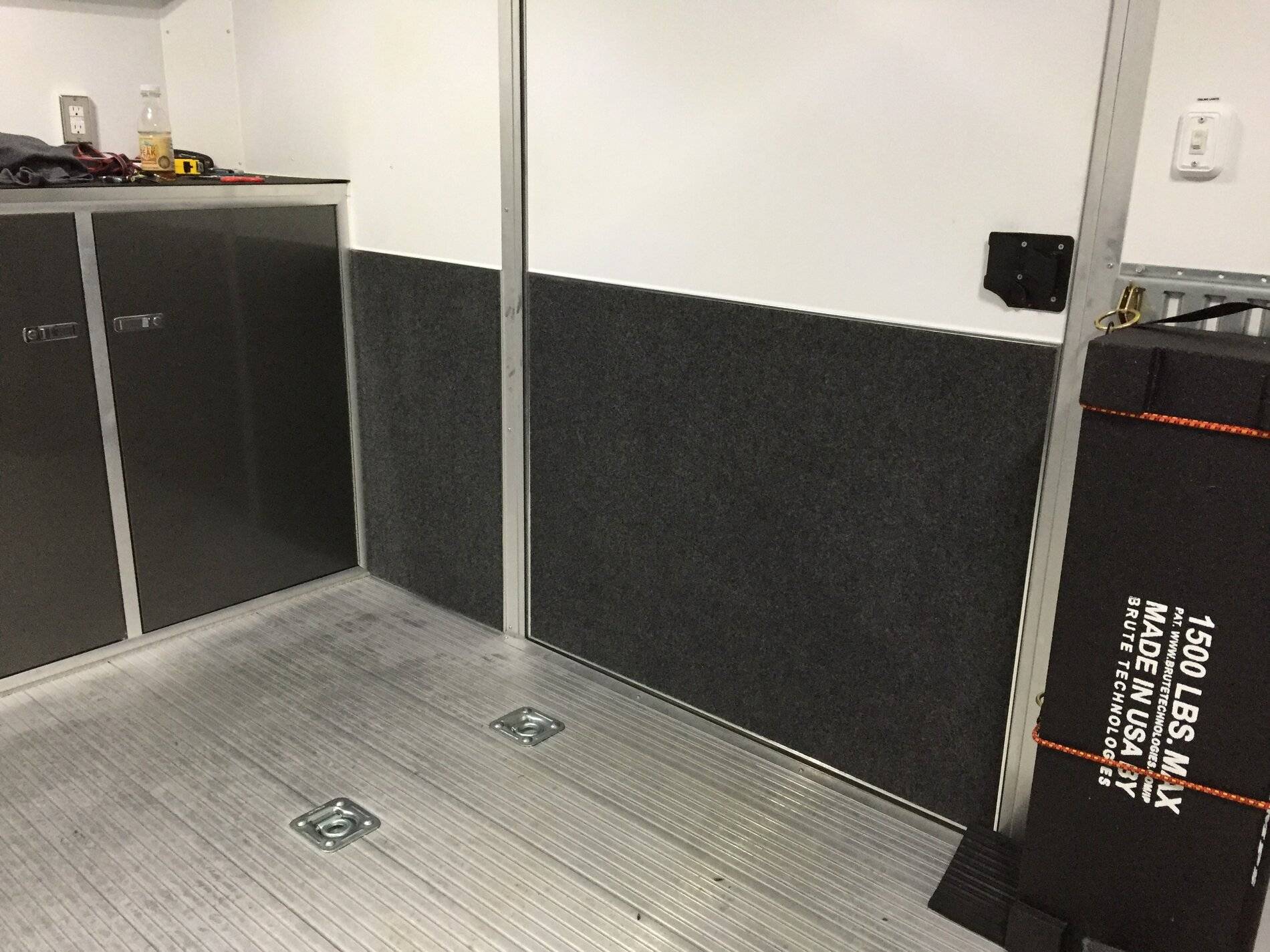

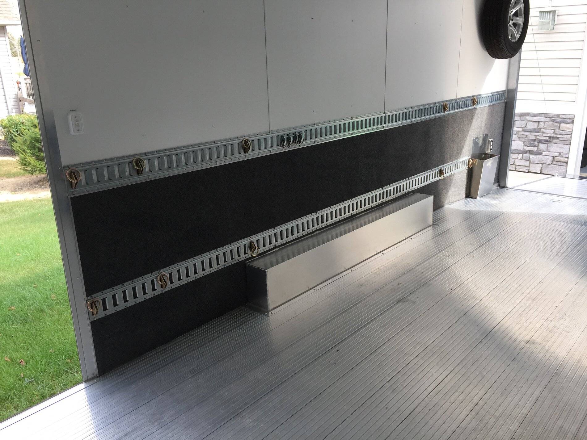

I have a 24’ Intech (similar to AC Tech design) Lite. It’s a great trailer. The Lite version has limited options. I upgraded to front cabinets and thicker exterior panel (same color as inthehighdesert‘s). I added winch, carpet, etrack, jack cradle and tie down hooks. I like etrack better than aircraft channel because it uses two fasteners per stud instead of one. It doesn’t look as nice but definitely stronger attachment.

Because you added all the goodies :shock:. To have Intech add carpet to walls would have been almost $2k IIRC. I spent ~$300 for carpet, J channel, fasteners and double sided tape.
Plus aircraft channel is way more expensive than etrack.

Ha, I won't deny that. Normally I share the sentiment. But ready to just pay once and have it ready without me needing to spend a bunch of time and effort tweaking it. I'm there with the current trailer and it's been a fair amount of work. I can barely keep up with the race car these days.
You DIY carpet walls and e-track look great. Where'd you source the carpet?
How do you like the extruded aluminum floor? I'm leaning that way due to no plywood, but do like the rubber coin (softer on the feet).

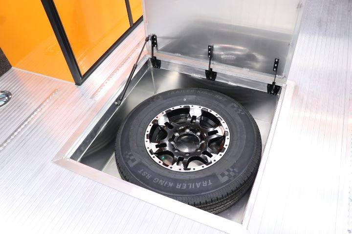

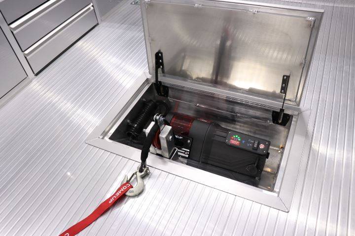

Added inspiration photos to the first post.
As a side note, anyone have experience with the following:
  1. Using nitrogen for tires/nitrogen bottle
  2. In floor storage (can spec custom in floor storage compartments - right now I am just thinking spare tires
  3. Above wheel well storage - specifically those large cabines that are only 6in deep (what are you using storing in those)
