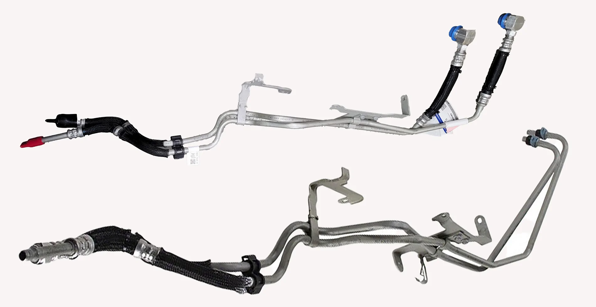

...and it involves 3 components. A new rear line assembly (actually two lines in tandem) and two stubs that attach to the lines, run into the case and are secured by new design flanges.
I'll try to illustrate as best I can for those that may not be that familiar with the hardware I'm speaking about. In the following photo you see a side by side view of the older 2020-2022 rear line section beneath the new section, designed for the 2026 Dark Horse SC. This new part(s) will also be specified as the service components for the aforementioned GT500 cars. Again, new part on top, old on bottom...

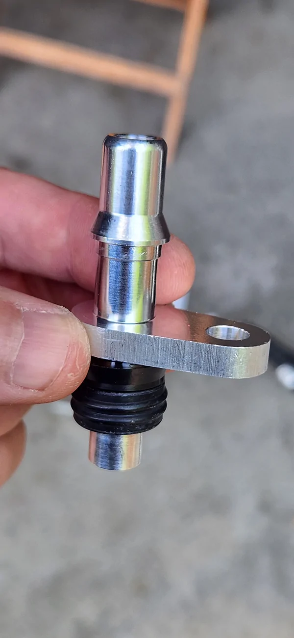

The blue caps attached to the end fittings on the new assembly attach to a pair of stubs that then go into the transmission case.

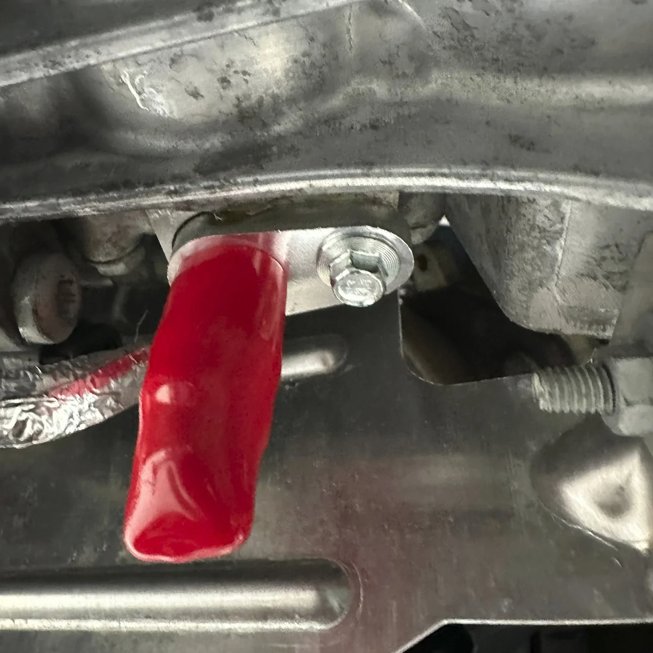

You saw it here first, a legit factory fix for failure prone lines that could save you a pretty chunk of change if your GT500 is now out of warranty and your lines shit the bed. The stub inserts fit the DCT case perfectly, as they well should. The only potential question at this point is should you substitute a slightly longer bolt instead of reusing the original factory bolt. I would recommend you do. Factory bolt is claimed to be M6 x 15 in the catalog. I would suggest a longer fastener and I'll address that in a subsequent post down below. You lose some thread engagement on the original bolt due to the increased flange thickness. Beyond that, this is a simple install where you may just need to add some fluid. Install in this case required adding about 3/4 of a quart that was lost due to cracking the lines open and what was in the lines themselves.

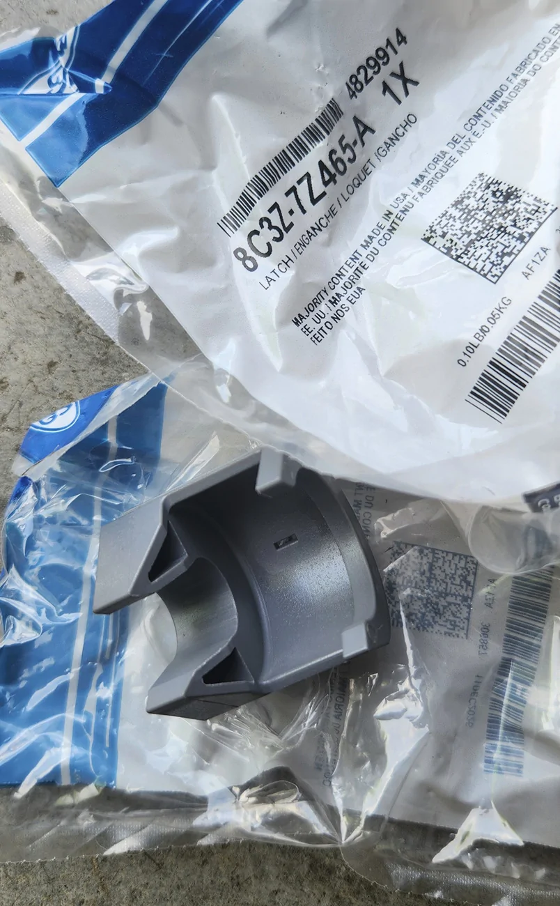

Two other small pieces of hardware complete the installation. In the photo above you can see them between the square aluminum head at the end of the line, and the case. They are in essence, a "kind of" backup latch to the spring loaded clip that retains the hose end assembly in place.

Cooler Pipe Retainer Clip (two).......................... 8C3Z-7Z465-A List $11.68 Disc $9.11
