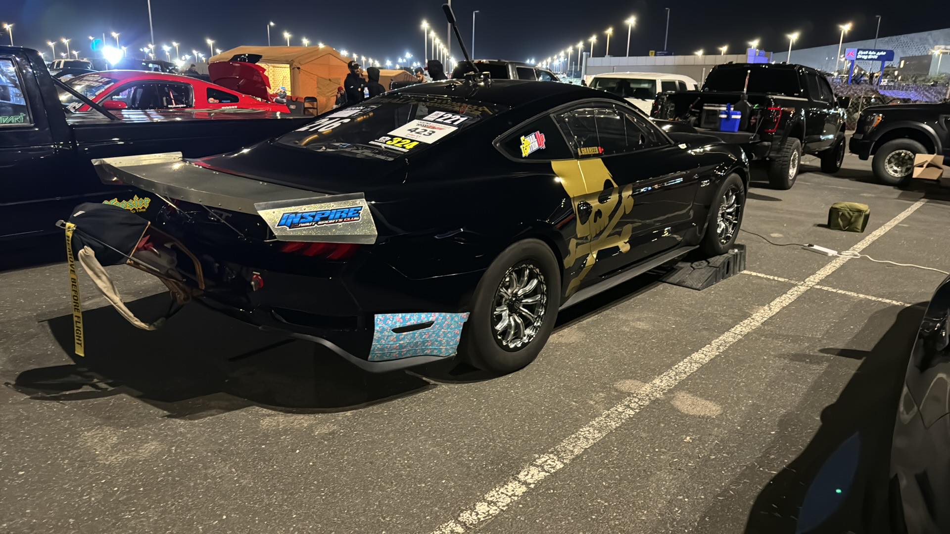

In our case on our 2018 GT which was posted above the car was calibrated by Lund Racing to be able to launch in 2nd gear. This helped us quite a bit due to the power level and gearing of the car to get it down the track quicker and not have the car shift into another gear at the top end. This allows the car to stay in the gear at the top end and rev out properly instead of losing momentum from a shift into a higher gear. It also prevents tire spin at such a high hp levels in a very aggressive low gear.

Circle D converter, Mcleod steel and friction kit upgrade as well which was installed by Jake@Power By the Hour. Never had an issue with the trans. I cut consistent 1.27 60fts with that car and it was on the stock magneride shocks and struts.
The car is still running over in the middle east. Here's a pic of it from a few days ago.
