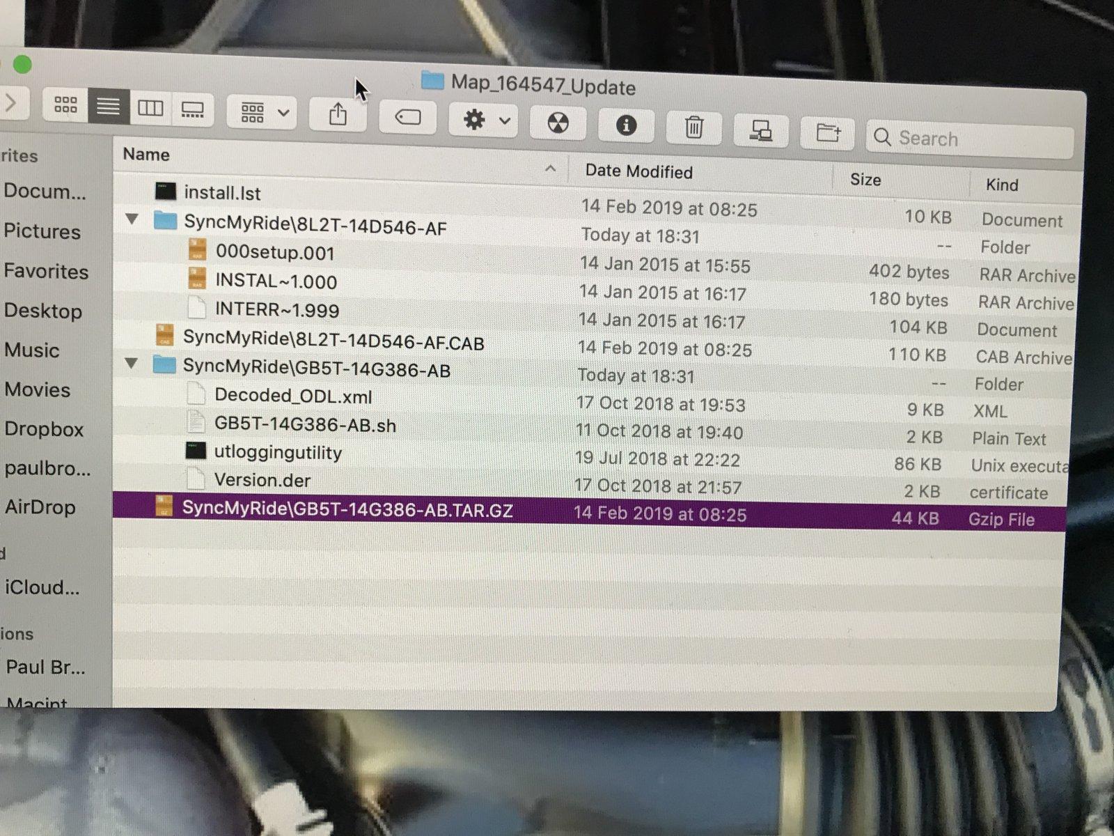

Just downloaded The Unarchiver for Mac free and it’s opened everything but I still think it’s not going to work. I downloaded some form of winrar for Mac earlier and saw my keychain of passwords had been opened so I binned it and I’m doing a full virus scan. The Unarchiver is ok and downloaded free from the apple store. Yep didn’t work, same error code

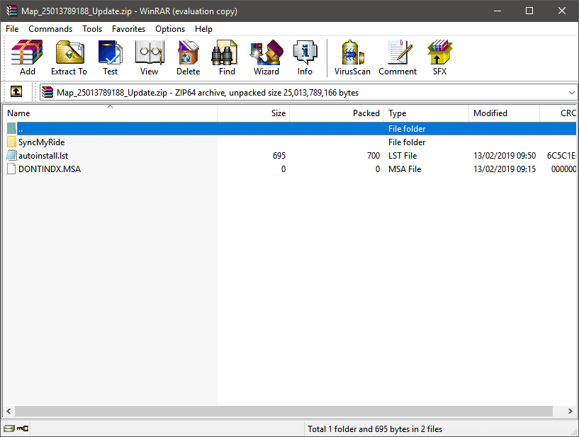

Seriously guys go to this link - https://s550.guru/how-to-update-ford-sync-3-navigation-maps-europe-f8-2018/
It tells you exactly how to do it. If you can't get the Ford downloads to work there are direct links at that site.
If you are on Sync3 v 2.2 'jord79' you MUST update to V3 (18025) first before you install the updated maps. Ford should offer this first when you put your VIN in as long as it is a UK car and not a US direct import. Don't try over WiFi as even the Sync update is a couple of Gb and will take forever. The good news is you can update directly from 2.2 to 3.0 and then maps from F4.1 to F8

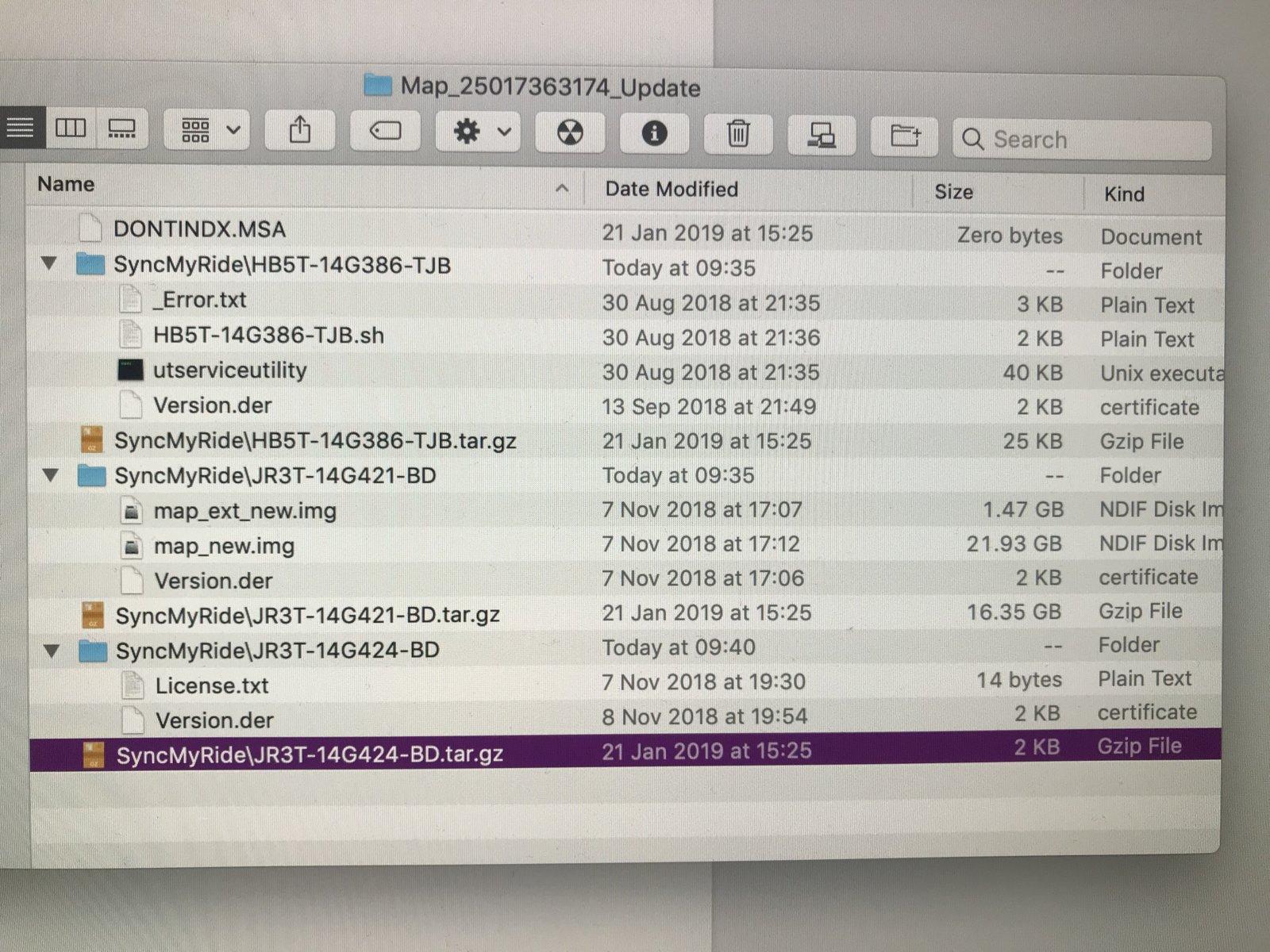

Flamesey - that archive is NOT the maps update and WILL NOT WORK ! You can download it as many times as you like from Ford, but if my VIN is anything to go by it is presenting the wrong file for download for some reason on the Mustang. It is far too small. use the maps link at the site above (23.3Gb). When you have the download (zip archive) extract it to the root of a USB drive which should leave you with 2 files (install.lst and DONTINDX.MSA) plus the folder SyncMyRide containing the tarballs (tar.gz)) as shown below. This is what the USB drive should look like it when you browse to it's root after extraction. As mentioned before the update takes about 40 minutes x 2 with an ignition cycle in the middle.

Well I’ve downloaded it but this time although I did get the .MSA file, I got 3 syncmyride folders I’ve opened but no .lst file . I’m thinking maybe of taking the .lst file from the ford download and stick it with the Guru download ?????

No it didn't work. When I added the .lst file it did recognise that there was an update but got the same error message. When i deleted that file and tried again, it didn't recognise any update. Just spoke to a dealer, they don't deal with it at all. I guess it will wait for Map 9 and see if they get it right then.

Something is damaging the download there. You don't have three syncmyride folders your zip program is just expanding the tarballs to make it look that way. The install.lst cannot just be swapped (the one you had was not correct for the full map download) The problem may be Mac related. I'm just downloading myself from that link (which is the Ford repository anyway) to see what it looks like.

Yes, all downloaded fine with complete collection of files and folders. I think your Mac is causing the problem in the way it is dealing with nested archives. You need to use a PC if you have access to one and don't use native support for zip files use a dedicated bit of software such as WinZip or WinRAR
