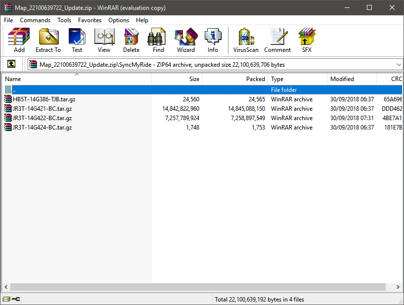

This is what should be in the syncmyride folder - you have got some missing files plus not sure what the cab file is. The msa file just tells sync not to index the USB stick - it has nothing in it .

If you connect the car via wifi it will update at Ford and show the correct downloads via the website. Don't try the update over wifi as it is 25Gb. Download will take a while even over a good wired broadband connection. Once downloaded (zip archive in my case called Map_22100639722_Update.zip) you need to open the archive and copy the exact files and folders to an ExFAT formatted USB stick. Use something like WinRAR so as not to damage any of the files. You should end up with two files, DONTINDX.MSA and autoinstall.lst plus the syncmyride folder containing the files in the screen grab on the post before. If you don't have these exact files and folders then the update will not work. There is no xml file generated by the map update.

I updated mine the other day. The download consisted of the 3 files as above, although I had 5 tar.gz files in the syncmyride folder. Loaded onto 32gb exfat stick and plugged into the dash usb slot. All went according to instructions, including the timings, except for the last bit where the pop up says you can remove the stick but the instructions say don't.
