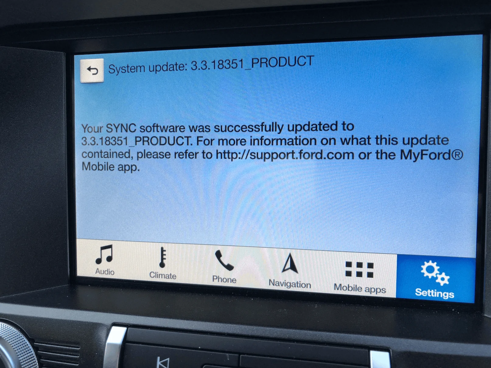

Updated my Sync software this morning...took 18 mins to upload.
This is the screen I got....I uploaded the xml log file to Ford so presumably I can now update the maps ? Not sussed this bit out yet though the sync update was very straightforward (using Mac OS)

Yes that has updated fine and yes you can now do the maps. They will take a lot longer to install with an ignition cycle in the middle

How large should the map update be ? I have downloaded a file but it’s very small, something like 160k, so I’m guessing somethings not right
