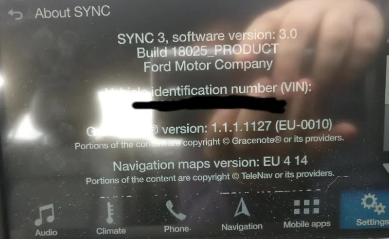

Mine also shows EU 4.14 for the maps.

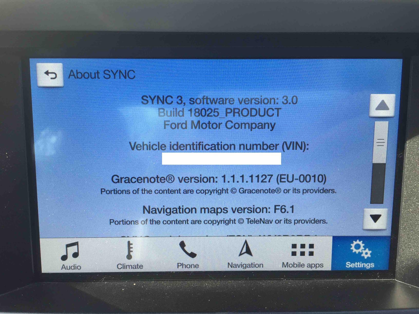

It works but bloody hell is it a pain. After following some trouble shooting advice I split the installation into two, one for the new voice file, the second for the check file and maps.
I did the upgrade to Sync3 3.0 first, then the voice update, then the map update to F6, re-using the memory stick between each stage. Sync 3 update took about half an hour, Voices took about 50 minutes, maps took 10 minutes. The Sync system seems sensitive to the type of USB drive you're plugging in. Not just that it should be ExFAT formatted, but some memory sticks it just doesn't like and throws up errors. Initially I was using one memory stick for the sync update and another for the maps but it maps always threw up errors after the Sync update had worked fine, so from that point on I did everything using the first USB stick which had worked.
Stage 1 should come pre-formatted in the Ford download - just check that the data files are in a subfolder and the autoinstall and DONOTINDEX files are in the root folder when you copy across. For stages 2 and 3 you need the autoinstall file in the root folder and the *.tar.gz data files in a subfolder called SyncMyRide each time.
My auto install files were:
Stage 1 - 2.3 to 3.0 auto install comes with
Stage 2 - Voice
[SYNCGen3.0_ALL]
Item1 = Navigation Voice
Open1 = SyncMyRide\JR3T-14G422-BB.tar.gz
Options = Delay, AutoInstall
Stage 3 - Maps
First edit the name of the licence key file to remove the suffix, so it just reads JR3T-14G424-BB.tar.gz and then matches up with the autoinstall open1
[SYNCGen3.0_ALL]
Item1 = PartNo Reference
Open1 = SyncMyRide\JR3T-14G424-BB.tar.gz
Item2 = Maps
Open2 = SyncMyRide\JR3T-14G421-BB.tar.gz
End result is:
