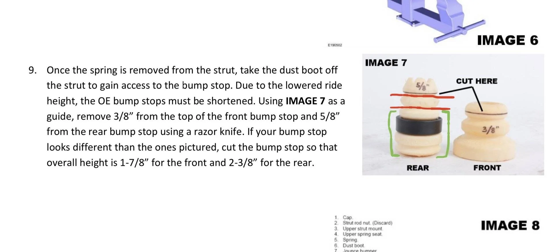

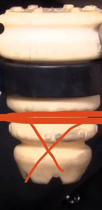

This is what I trimmed from the stock rear bump stop and I’m wondering if I should trim them back one more notch to the height of the black piece.

When I was at my dealer having the tech look things over he said there was a “finger width” so 6/8ths of an inch space between the top of the shock body and the bump stop while on its wheels.
  • The rear OE bump stop is 3 inches tall
  • I cut off 0.625” (as per BMR)
  • Total bump stop height 2.375”
  • We cut off 0.5” worth I believe (another section in red)
  • Total bump stop height: ~ 1.875” (in green)
  • Amount of exposed shaft: ~ 1.2” (can’t check this weekend)
  • Steeda’s rear short stack bump: 1.5” (for reference)

No worries Ryan, I recall my 'ah hah' moment re bumpstops. Thanks for posting up the data, interesting that the BMR height is greater than the Steeda height but IIRC the Steeda spring might drop a little more?
Also BMR says to trim the cone, one of the cone's functions is to provide progression in the bumpstop compression although it's not hard to see why BMR recommends this in the case of the front bumpstop given its design. Where it's not possible to trim the square end some folks suggest drilling small holes in the top of the bumpstop to try and replicate the rate that's represented by the cone end.

Why not also cut the black ring off? It's probably just plastic but it's nullifying the ability of that section to compress.

Matt I’m concerned about the impact of cutting off the black ring. However, if I do cut off the section above it I might have to get rid of the black piece otherwise bump stop impact could be harsh.
