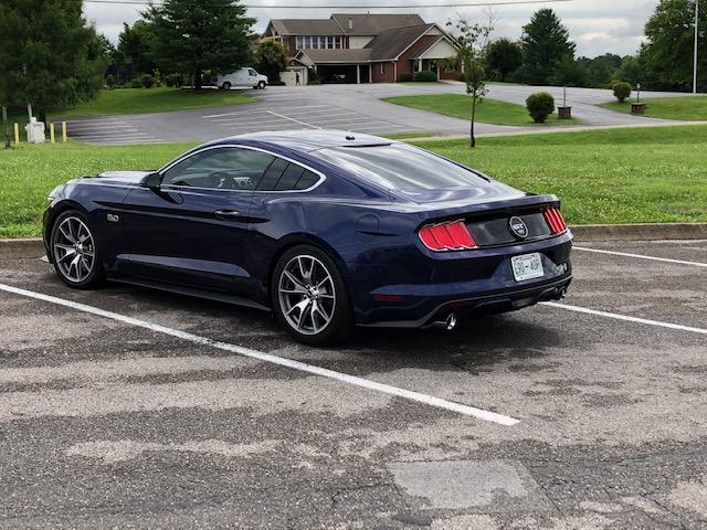

After much deliberation I decided to go with the Steeda Pro-Active along with progressive springs on my 2015 LE 50 year Mustang GT. First, I got a great price on the combo from jigar and 2nd my equipment was on my doorstep in two days after ordering. Here are my impressions good and bad after three days of mixed driving over smooth, rough, asphalt and concrete roads.
The good......I like the look of the lower stance much more than I anticipated I would. It handles great, and I was not terribly disappointed in the way it handled with the stock set-up, but it is much flatter in the corners now......much closer to the way the German cars I have owned (BMW Audi) handle IMO.
The indifferent.......Does it ride better....yes....is it still a bit too harsh, yes IMO. Here is where it is definitely better. On roads that have been patched, have small dips and cracks in them, it is much more compliant. You still feel them, but they are much less bone rattling now. On the sections of concrete roadway that have seams in them, you don't feel the seams nearly as bad, but it still bounces way too much on the uneven concrete sections that aren't smooth. In fact I can't tell a lot of difference in that aspect from stock to the Steeda set-up.
The bad.......it's a pretty good chunk of change to spend between the cost of the product and the cost of the install if you aren't able to do it yourself.
In the end I am very pleased with it and would do it again. If you are like me and plan on keeping your ride for a good many years I highly recommend it as it is a much more pleasing place to be over the long haul. And BTW a shout-out to Lethal Performance in Jefferson City Tennessee for the install. They went the extra mile and stayed after hours to make sure it was spot on and had zero squeaks or rattles.
