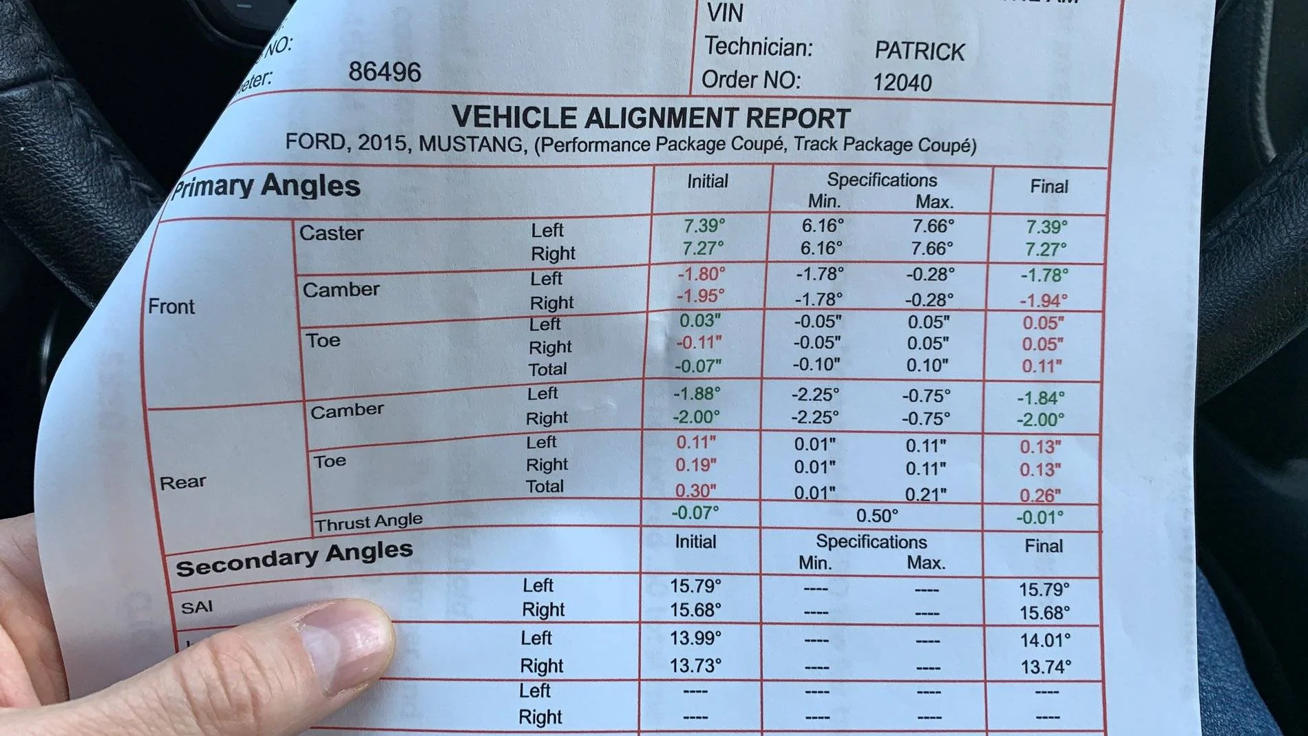

Something else that might put my BMR drop on the Konis into perspective is something I didn’t really think to mention before: my alignment. I had a very reputable shop that has seen a few S550s do my alignment after indexing/clocking the bushings. I stupidly didn’t buy front camber bolts. I regret that choice because I asked to have the alignment specs that Kelly of BMR recommended in another thread https://www.mustangecoboost.net/threads/alignment-specs.18895/ scroll down a few to OITexastang post.
Just to be clear I asked for the toe in front and rear as per Kelly’s recommendations. What surprised me is how much negative camber I’m seeing in the rear. Maybe it’s because of the toe in I requested because I was told the toe and camber impact one another.
Obviously there’s very little camber adjustment on these cars so here are my final numbers. Thoughts?
