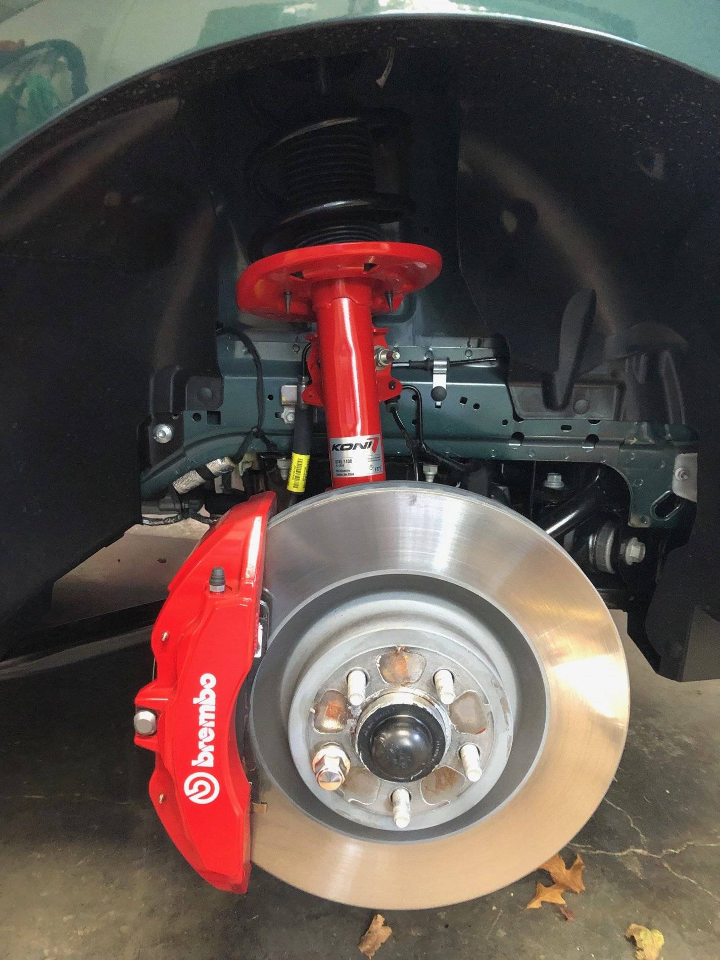

Got them on but car is now stored for the winter. Drove about 10 miles on them and could feel a difference, especially on rough road, but will not be able to really evaluate until next spring. I only have 150 miles on the car, but it is my 3rd S550 so I am very familiar with ride characteristics.
