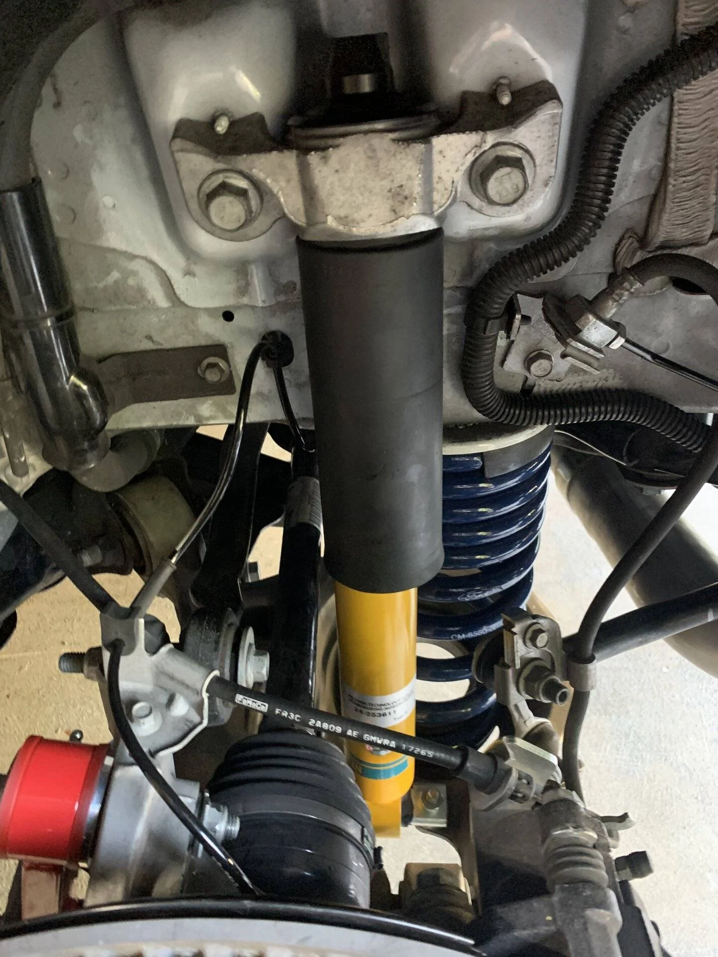

Dumb question time... Is that the stock shock mount or a different item? From my reading there is a FRPP top mount available with a different sized hole in the centre for FRPP and other after market shocks. Before buying the B6's I want to know if they will work with my stock 2017 PP mounts or if I also need to invest in a different mounting solution. Many thanks
Mine are stock 2018 PP mounts.

2018 Mustang GT PP1
Also, the B6 rear shock rods are little over 5mm thicker than the stock pp1 shocks. Just FYI..
