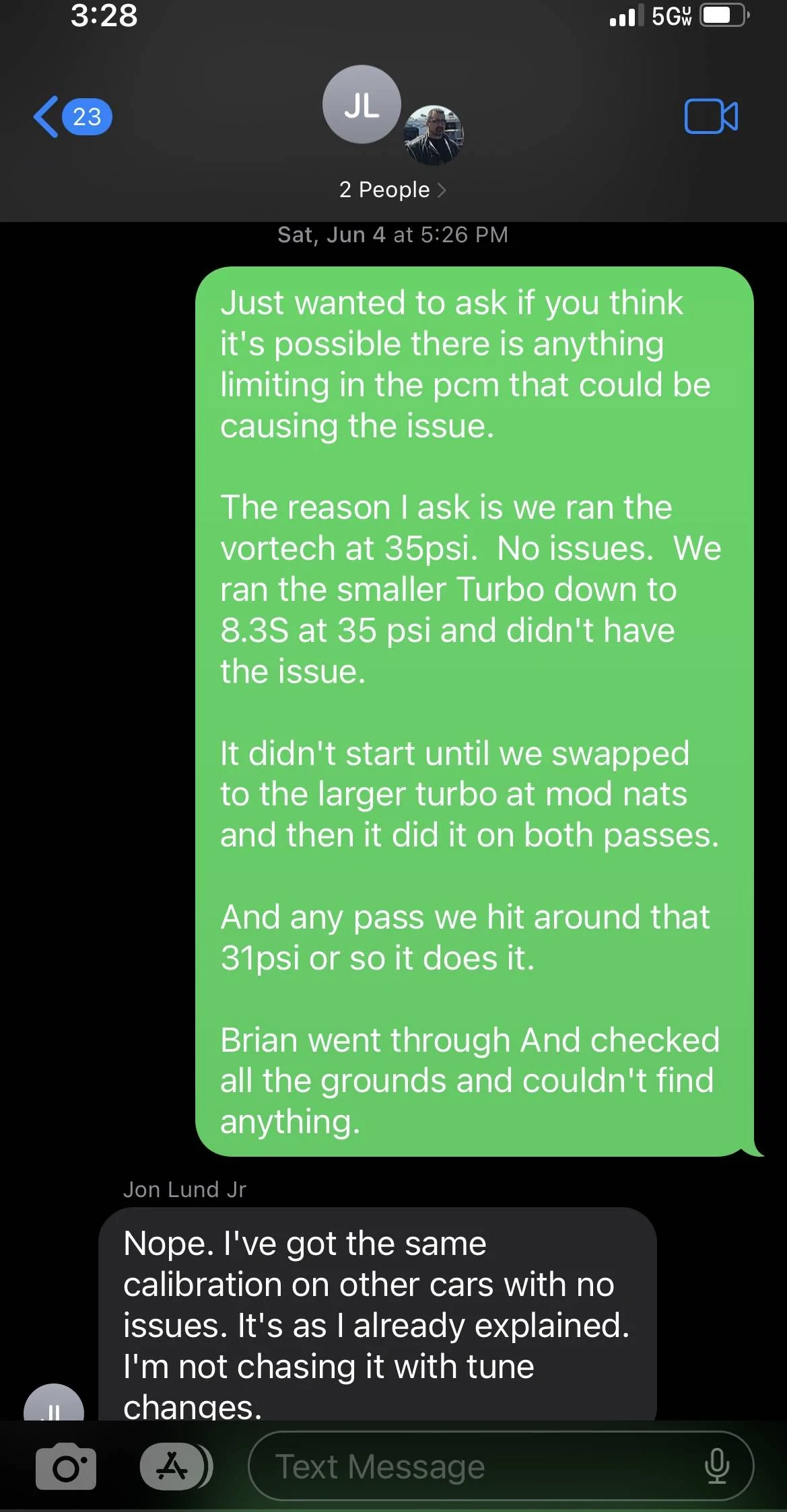

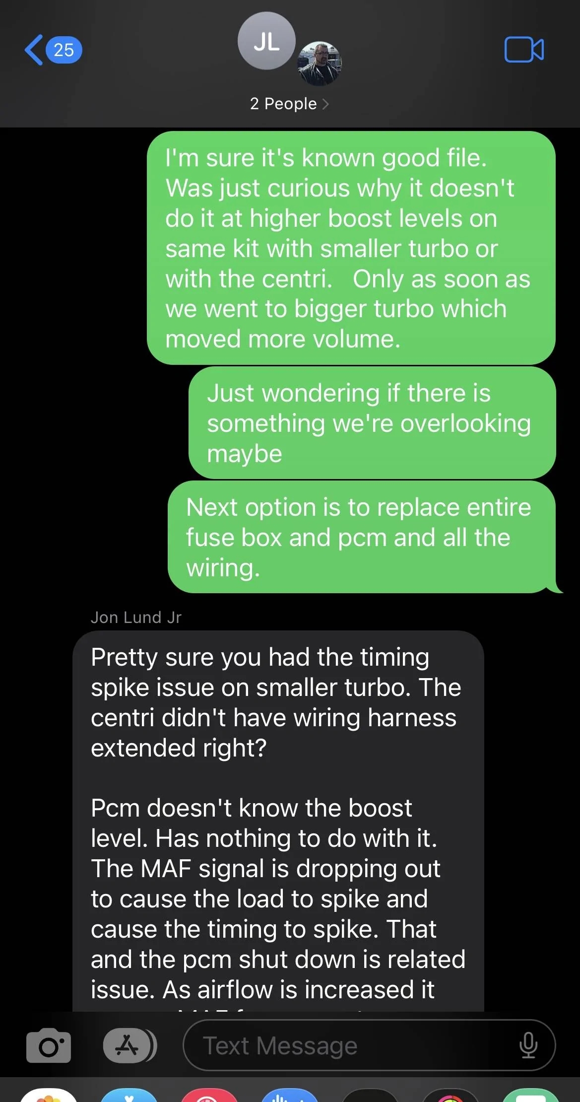

so I wasn’t really going to post hear more but I did see where somebody mentioned both sides to a story so I’m going to send a few screenshots to put in context the idiocy from over there
The first thing you have to remember again my car was running perfect at the track where Lund racing was on site to see everything. We overnight a larger turbo, bolt it on no other changes other than the larger turbo, and the computer starts resetting itself. now keep in mind this text is from June. This is eight months since this issue first started.
Every time the PCM resets itself you see the timing spike to like 35° you see the air fuel go to like .90 lambda.
Keep in mind the car is making 1400 wheel
How many people think that of cars making 1400 wheel and you should’ve 35° a timing at it and lean it out, it’s going to live more than a pass? it wouldn’t.

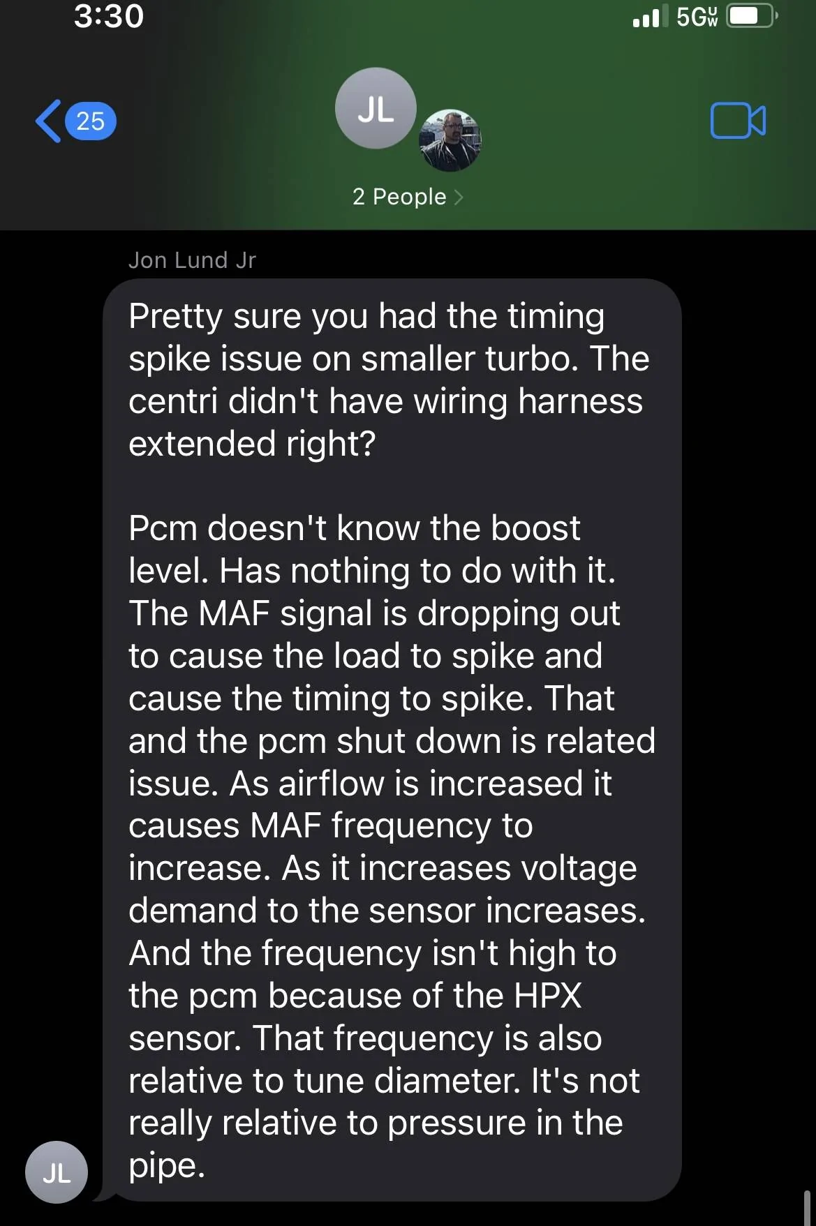

As soon as Matt, looked at the date and he said that’s false data
matt said your PCM is not seeing those air fuel ratio’s. He said your PCM is in a reboot process. It’s nothing like what Lund is saying. for him to even think you could make that much timing with that lien of an air fuel ratio together is just retarded.
If you look, Jr also said that the maf signal is dropping out causing load to spike. all of which was not the case. Just shows for people who think they’re so smart and know everything that they didn’t have a clue what was going on with this car they just spent 10 months telling me to keep throwing money at it and it’s a mechanical issue and to deal with it
in addition to say that the PCM does not know boost is also retarded
No, it doesn’t know exact boost numbers, but it does no airflow because the math is increasing so it does know boost
By adding the larger turbo, we were moving so much boost/airflow same thing. That the PCM was reaching a limiter that Ford said it could not reach.
Same thing I’ve been talking to Lund about for months and he just kept totally dismissing
So the tuner that had not tuned in 10 years was exactly right different guy than Matt, but was exactly right with what the issue was and he never even seen one single log on the car a simple 30 second conversation. He knew what it was. , not the exact issue parameter, but knew the issue was the PCM resetting for hitting a limit
once Matt was able to figure out the issue, he was able to ride a patch into the software to wear that parameter could be changed
Similar to this last issue with the transbrake, where they found a parameter that had not been mapped out, figured out what it was, and changed it
But we share that info with the tunin companies so that they can add it as a parameter that everybody can use now
there are always two sides just in this case their side is complete morons amd dismissive and “known good file”. “not chasing with a tune
but here’s the funniest thing at the end of the day if they had just said well I’m glad you got it figured out, we were wrong. We probably should’ve spent more time with it. We all could’ve just moved on.
But instead they sent their lap dog out online to start bashing me, they went behind my back to Hp Tuners try to get me cut off. All because they were upset that someone fixed something they couldn’t fix
It’s childishness at its best
