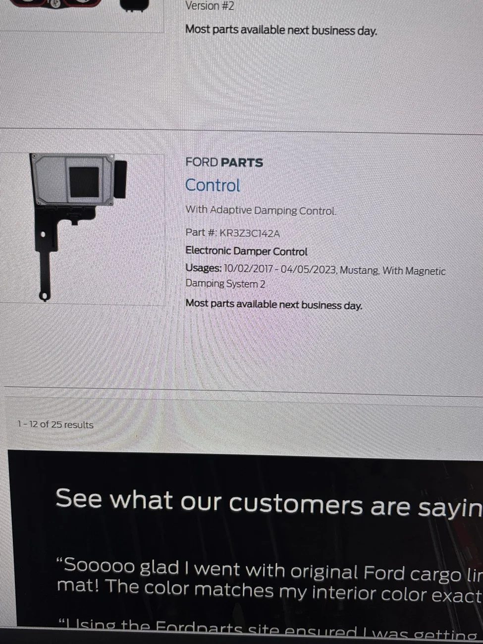

I looked up the parts based off the VIN number for the Bullitt, and it looks like it uses the same control module as the 350/500 since it only recommended the same part number that your search generated. The KR3Z3C142A
Maybe the lowering springs just make the ride much more rough. Who knows.

The module is the same, but the file loaded on each car is different. When you buy them, they’re esentially ā€œblankā€. The file has to be loaded based on VIN through the Ford software. If you buy a used one out of a 350, the file is already loaded.
There are a few other threads floating around the Gt350 and Gt500 sections where people have confirmed there are different files / dampers for each car. At one time Ford also had a ā€œperformance calibrationā€ file that came with one of their handling pack parts kits that could be loaded in place of the factory file.
