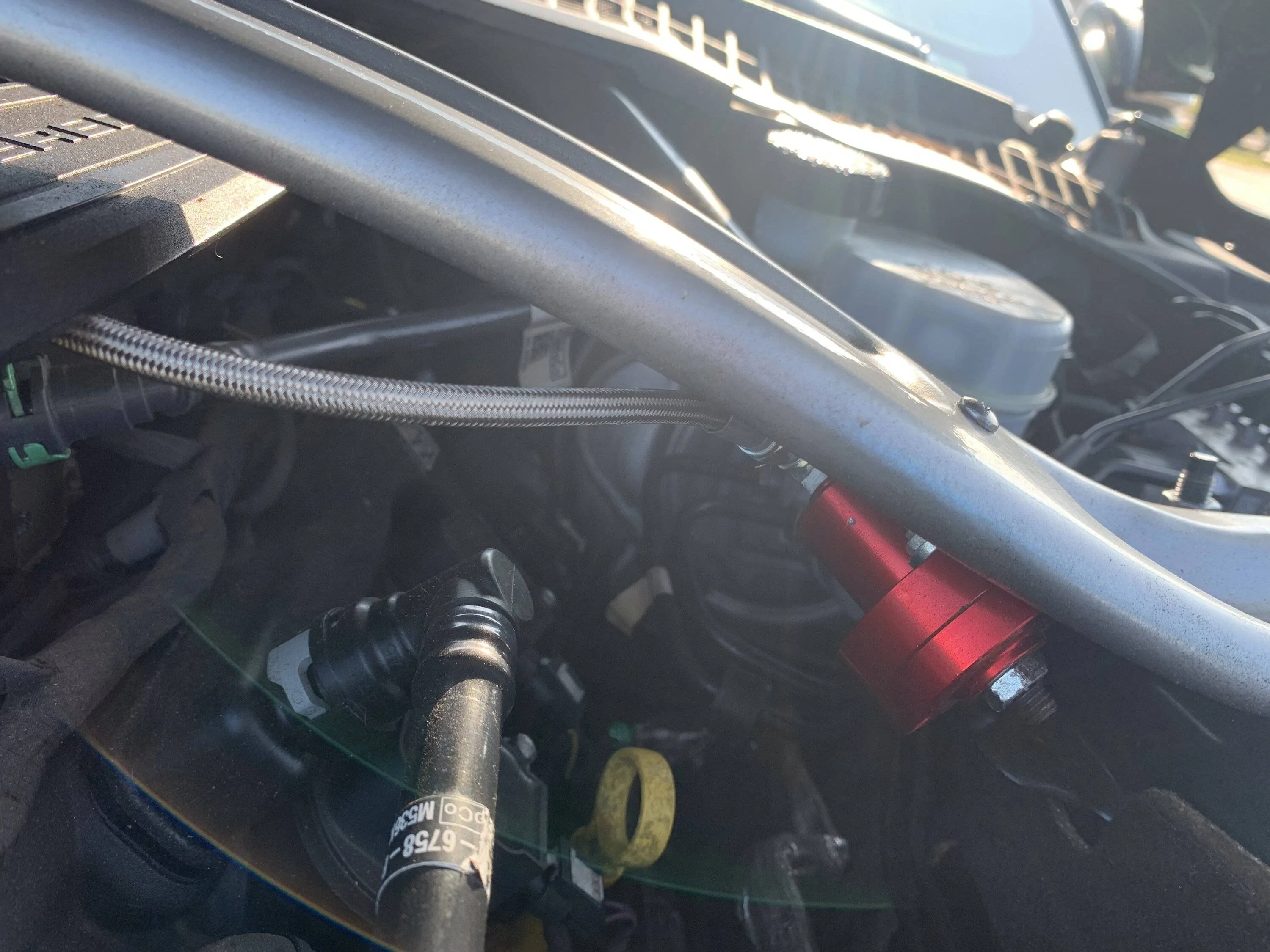

As an aside, does anyone know what this is? It’s on the bottom side of the strut brace.

Looks like some kind of PCV maybe?

It is an accumulator for the clutch. Someone likely installed a twin disc clutch, and it limits the travel of the throw out bearing so as not to hyper extend the pressure plate springs.
https://ramclutches.com/hydraulics-accessories-repair-parts/

Wow thank you for finding it so quick!
Do you feel a dead spot at the top of the clutch pedal travel? Like 2-3 inches of no resistance?
