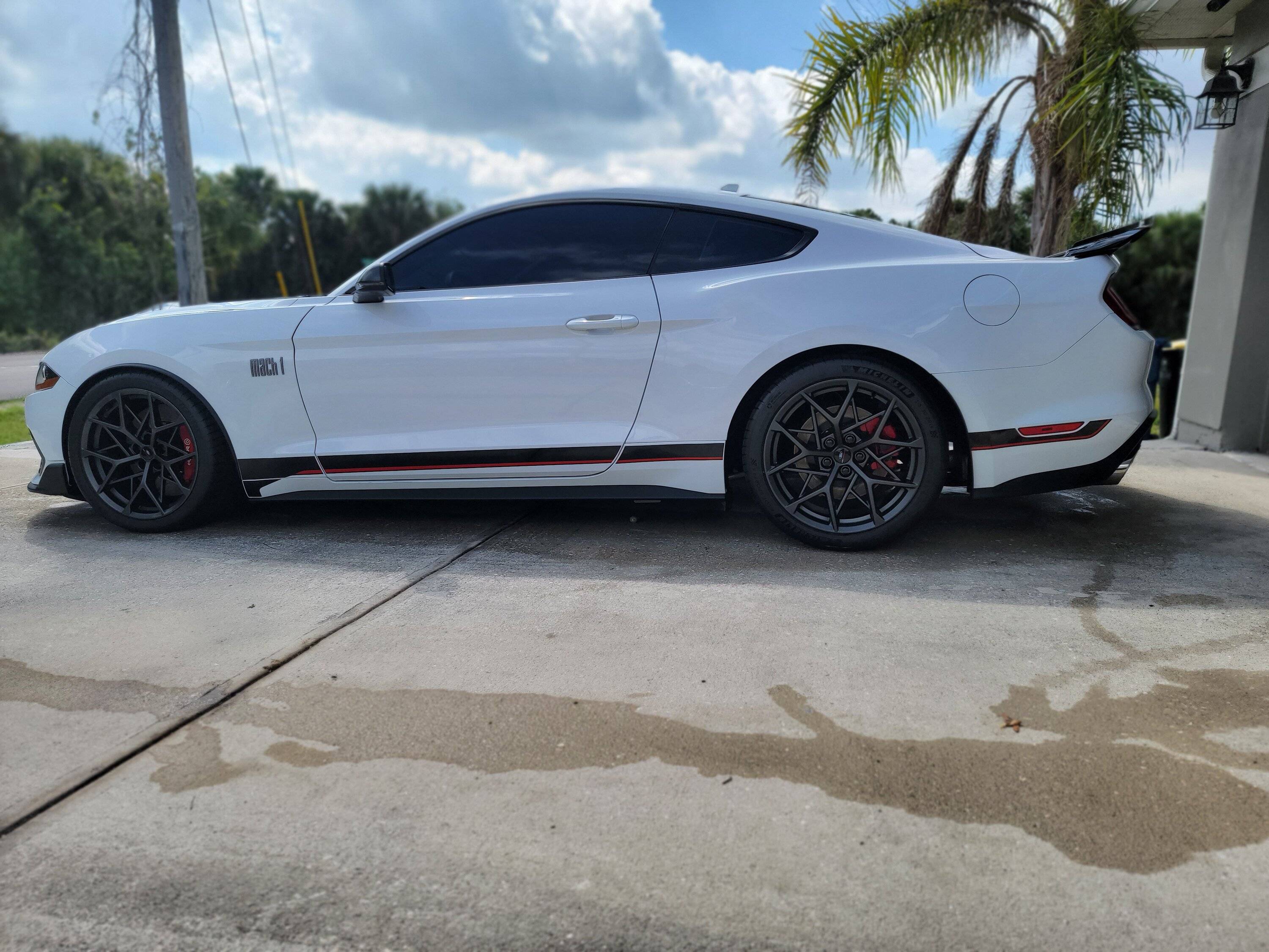

Ok so I've been searching the internet and I'm wondering if I'm going to have a tire fitment problem. This is a NON factory Handling pack car, with aftermarket Handling pack wheels added. All the vendors state on their websites that there could be a fitment issue with these wheels on non HP cars....🤔
So do Handling Pack rims fit on a non Handling pack M1 WITH the correct size tires? Will it effect the speedo? I'm starting to worry these are going to rub with the correct size tires, especially with the lowering springs on it. Maybe that's why it has undersized tires on it now...😬
I have a non-HP car, and I have 305/315's with the handling pack OEM wheels. No fitment issues. Alot of non-HP owners have done the same. Your speedometer will have to be calibrated though, as the non-HP's are calibrated for the 255/275's. Forscan will correct that issue. I also have Steeda Dual Rate springs and no rubbing/clearance issues.
