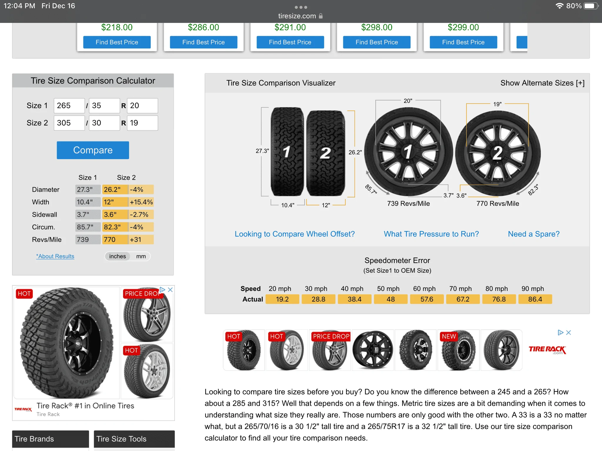

This is what I show when plugging in the 2 tire sizes. The 4% variance is enough to throw things off internally. I’m not savvy with Forscan so I’m not sure why it’s still off after you recalibrated using Forscan.
Paging @Cobra Jet , he’s good at finding all the various issues and fixes for said issues.
