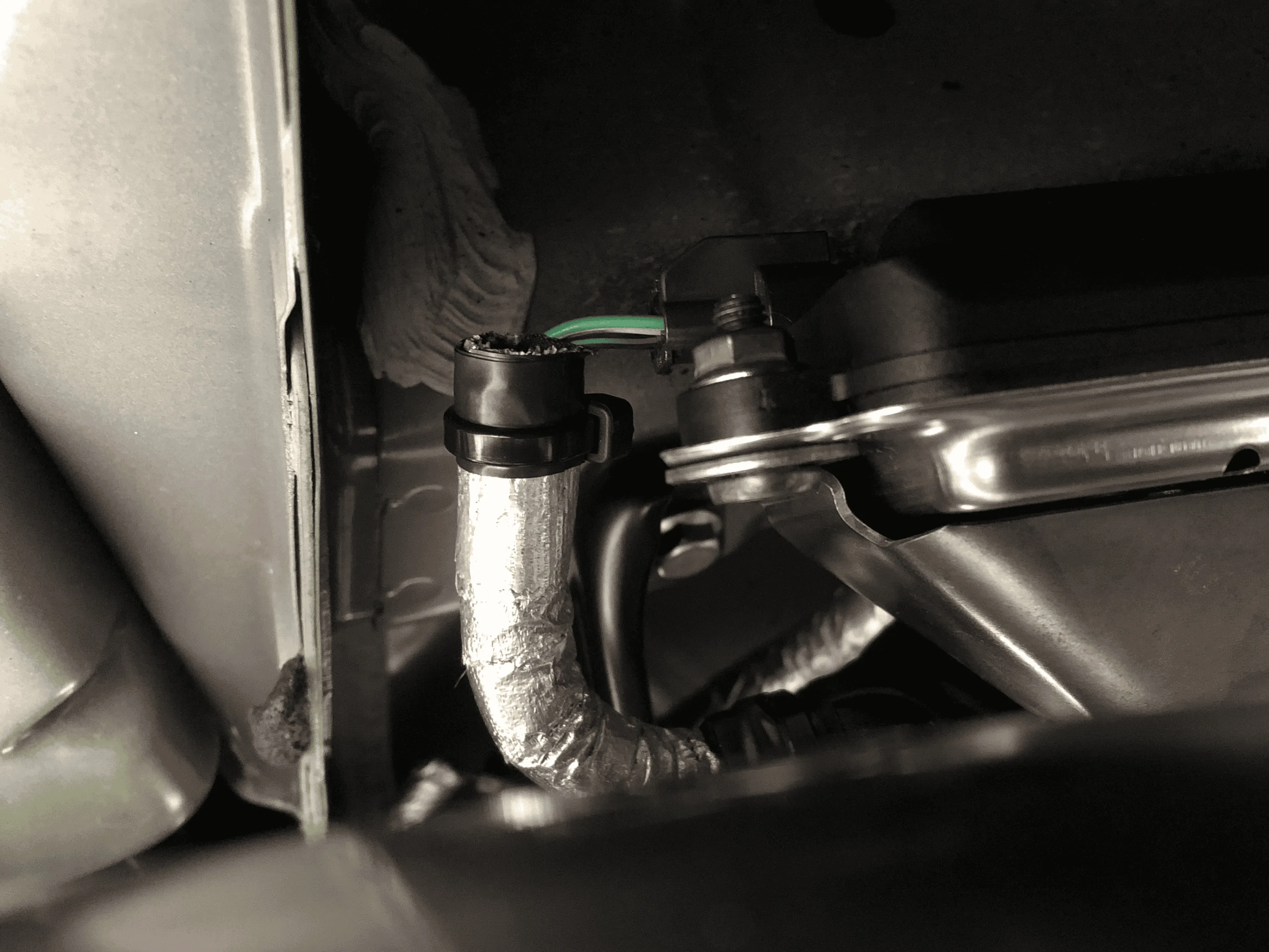

The wiring damage problem (sometimes from Ford / sometimes aggravated by poor resonator delete fitment) occurs on the right side of the car, just above the tailpipes, where the active exhaust valve wiring runs close to the frame.
It's this area :
But it may be harder to see on a Mach due to the tailpipe and valence design etc :like:
