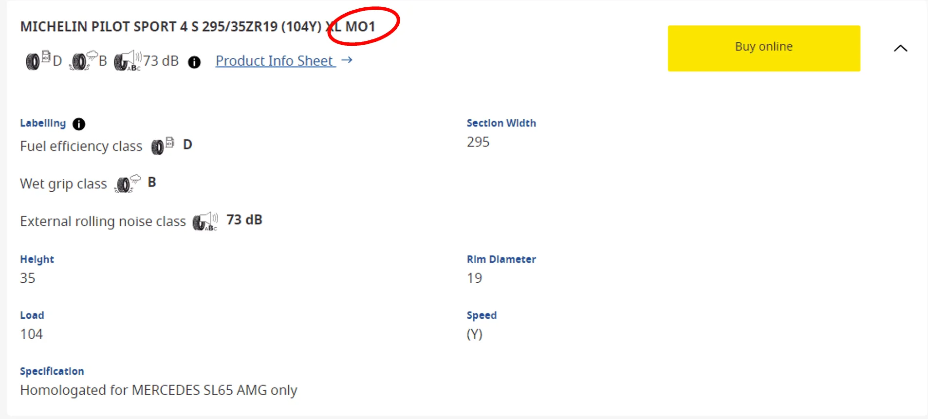

Alright...so MO1 is for Mercedes...great. thanks for telling me Owen.
Looks like the pilot super sports are BMW specific? Is that a problem? If so looks like Continental is the only option.

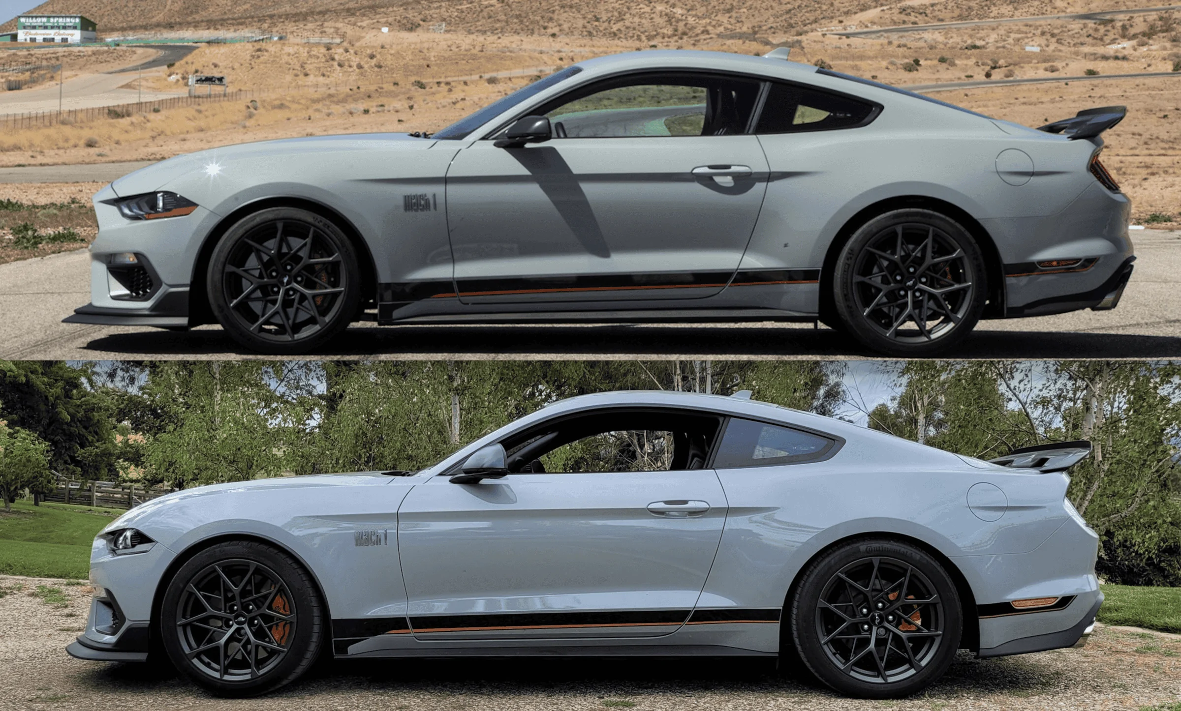

Not dead on from the side but might give you more of an idea, HTH!
If you're on the Steeda springs I'd probably say the 30 profiles are a better bet as you will be lower than me with taller sidewalls on the 35 profile but that's just what I'd do.

Thanks! That actually looks pretty good. You swear the ride isn't much different? I think my Steeda sport springs will be just slightly lower than yours. I'm trying to decide if I should just go with the original plan (HP tire spec) or get the 285/35 & 295/35 Continentals.

This might help.
Stock 30 series tires at the top and 285 and 295 - 35 series Contis at the bottom.
Both cars on HP springs.
Apologies the picture has doubled up for some reason.

This might help.
Thank you!!!
With my car be slightly lower, I'm thinking maybe just stick with the HP set up.

As for the MO1 code... that's denotes a manufacturer specific compound mix and/or pattern, in this case Mercedes. You can find this info after the weight rating of the tyre.
They've usually been developed for a specific application and tested for that car, so might not be the best match for others. Tyres that don't have these codes are more general purpose.
This is the info on the 295/35 from Michelin's site. I couldn't find any others in that size so you might want to check with your tyre supplier, better to do that and get the best tyre for your M1...?
-0.
