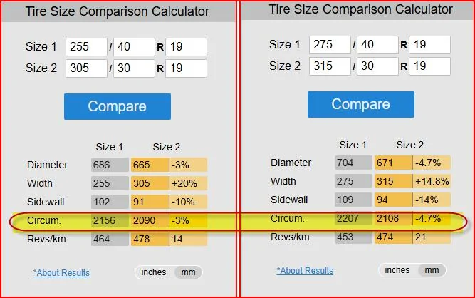

You don't need alignment, but you should change the tire sizes with Forscan because the diameter difference is quite big (-3% in the front, -4.7% in the rear).
I was told that the diameter difference is so minor (similar to normal wear and tear, also resulting in the diameter getting smaller) that there is no need to do anything else, and the computer will simply adjust for it.

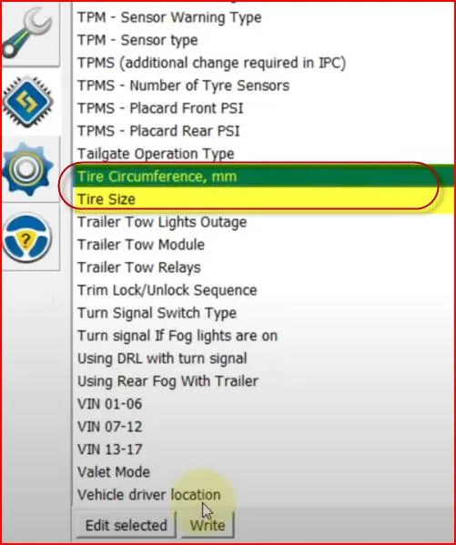

I can confirm that after swapping non HP for HP wheels – my speedo is now off roughly 4-5 miles with respect to Waze via Apple CarPlay… I confirmed Waze shows speed correclty and that is in sync on my other two cars – so no issues with Waze as some have suggested in other posts.
Now, I read some people recommend going to dealer, some advise against it and some recommend to recalibrate with Forscan.
If I go with Forscan, can someone who actually did it confirm what values needs to be updated?
From watching a YouTube video, my understanding is that the below two values needs to be changed:
  1. Tire Circumference, mm
  2. Tire Size
From https://tiresize.com/comparison/ - I can get my old values and new values. Is it as simple as updating them via Forscan and save/Write?
And if so, which mm values do I use. For the Front ones I get 2090 mm and for the Rears I get 2108 mm

No confirmation needed. HP tires on a non-HP car will cause the speedo to read 4.5 slow everytime.
I had the dealer use Forscan to reset mine. The circumference of the HP rears is 2108. (there is no value input for the front, as the speed goes off the rear tires).
Now here's the rub. Ford factory settings already run about 2 MPH slow in all vehicles from the get go. So, when you enter the correct circumference of 2108, IT WILL MOST LIKELY STILL READ 1-2 MPH SLOW. Don't be surprised!
I changed to 295/35-19s on the back, and now my speedo is spot on. So if you're really anal, maybe you can calculate the circumference of that tire size and use it to get closer.
Also note that any dealer reflash, like the recalls for the fluid light and power steering, WILL reset your tire values back to factory. Ask me how I know.
