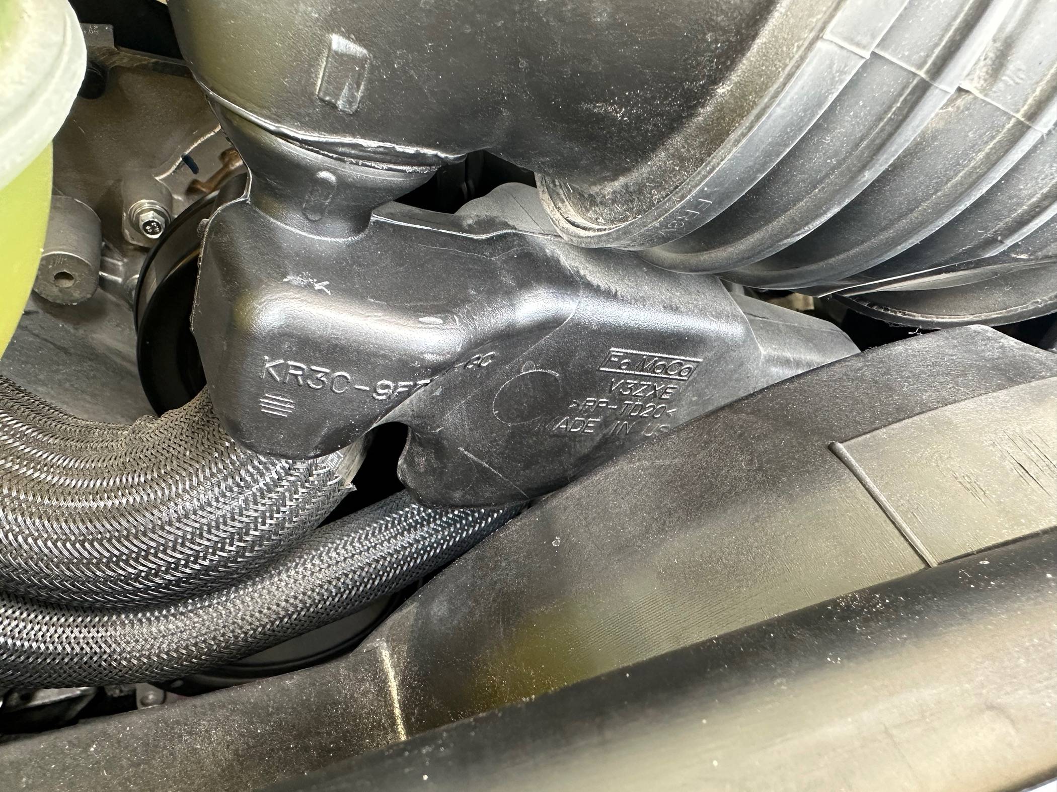

Been looking and can’t seem to find anywhere this is talked about for the Mach 1. Hoping someone smarter than I can explain if this would cause any problems or not. On our intake we have a resonator, I think the standard s550s have the version where it pipes to the cabin and there’s a delete kit, however, not us. Anyone know if I remove it if I’m going to cause issues other than a louder intake noise?

I guess then that bears the question of if it’s beneficial for the stock setup, why is it not also used for the aftermarket intakes? Kinda odd to me if that’s the case. I’ve always taken these off my cars, but the Mach’s isn’t removable without permanently modifying the tube.

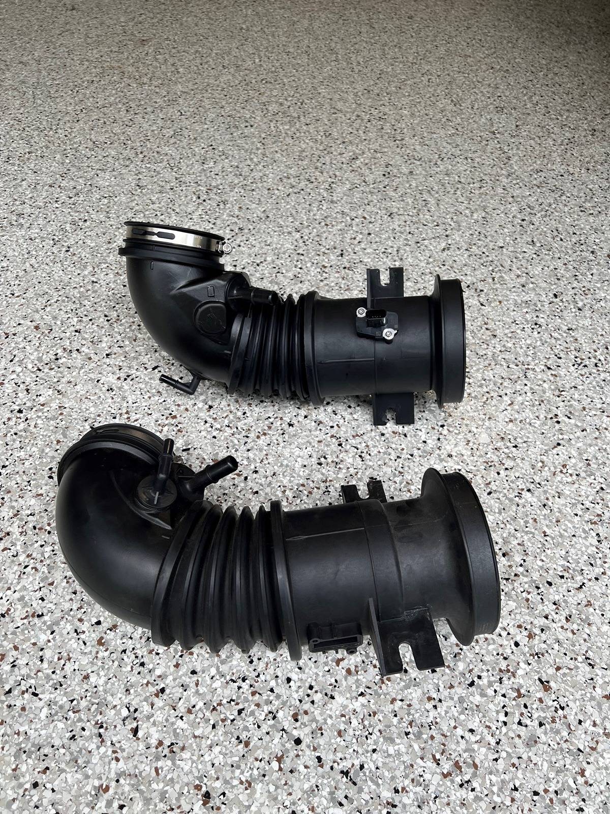

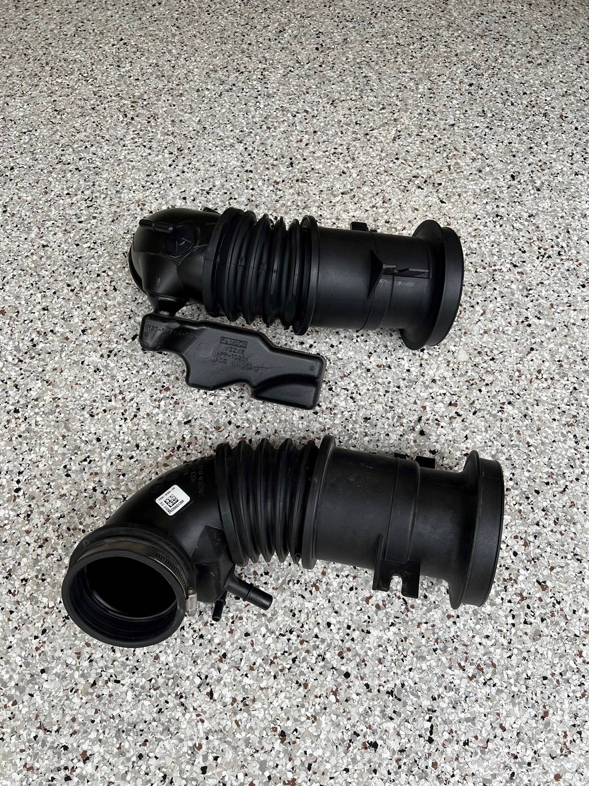

You can swap it out for the factory gt350 tube, I ran it for 2 years with no issues. Unfortunately, I broke one of the hose connections on the tube and had to return the stock one.
The only difference is the added intake noise that was mentioned, in the original post. When I find another 350 tube, I will reinstall it. It also gives the MAF connection a cleaner look on the 22-23, as they were moved up on top of the tube.
Reference pictures below:
That does make a much cleaner look. Because it’s on the bottom, I had considered just cutting it off and capping the hole.

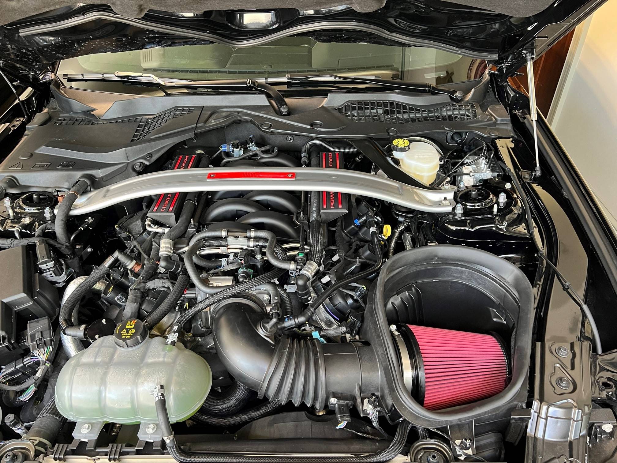

I did the same, I found a complete GT350 CAI on fleabay with airbox and the little snorkle that goes behind the grille.
