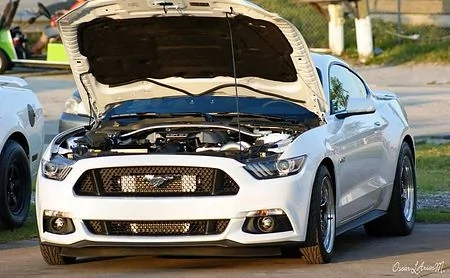

So have you ran yours on pump gas with your supercharger at the track? If so, roughly what time did you see then? Less than 11 seconds?
Ran it once on 93 ..I had to slow the car down for a 10.50 class .. It ran 10.50s / 10.60s on the 93 .. It made 600 hp on pump gas and 660 hp on e85 same day , same dyno ..
