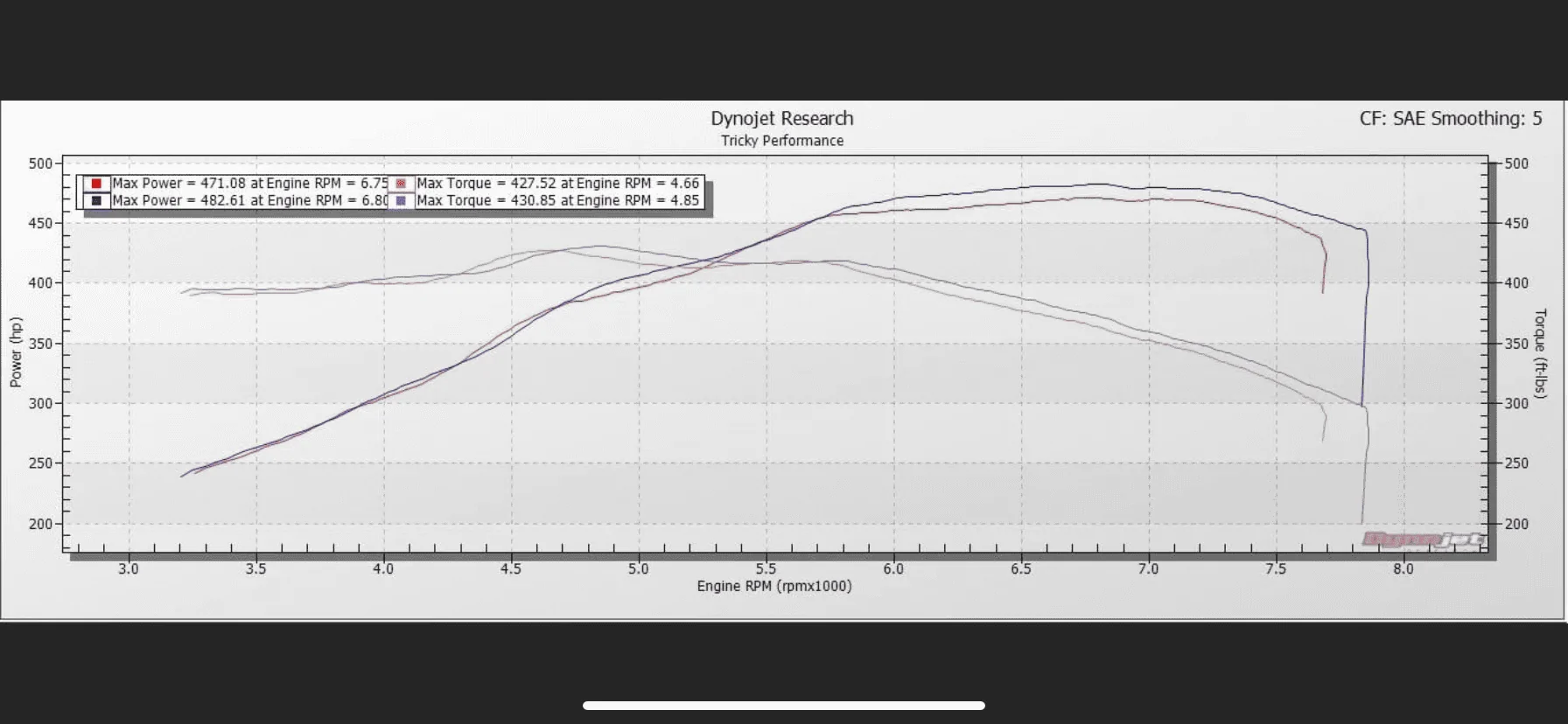

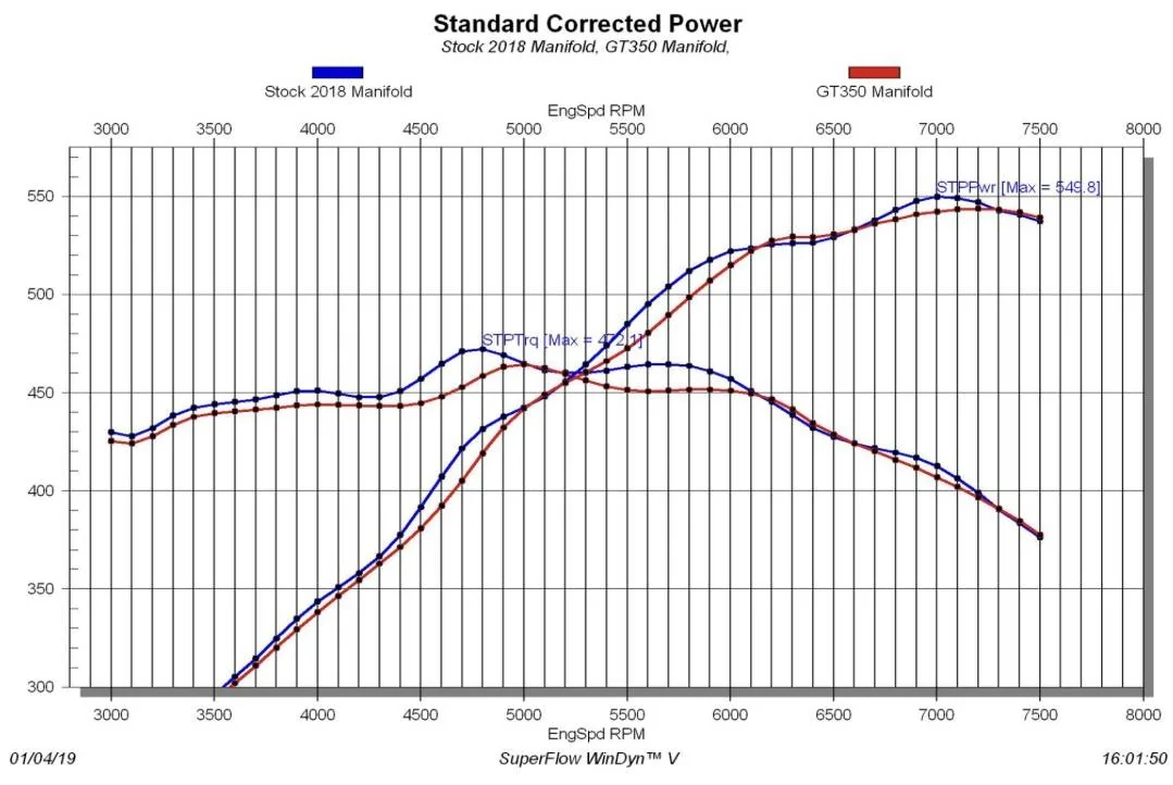

I was looking to swap out mine just to get more out my n/a car. These 2 files were shared with me, one is from Tricky performance, the other from motor trend. My car is a 21 so there isn't much benefit for me even though I was still going to go for a bullit ported one, I opted to get some rear drags instead. But if I had the $ & was going to add a s/c as well as driving a gen 2, I'd definitely do the GT350. These 2 are comparisons of the 18+ mani vs gt350/bullit IM

@Cordero1 thanks for these graphs, they are fantastic! but based on these, it looks like the 18 manifold has more throughout all the ranges, unless im reading it wrong??
Top one the blue is Gt350, bottom one blue is 18+. They both look like they intermingle up to 5700 then the GT350 seems to have the edge & goes up to 7500 where as the 18+ falls off just short of that. Now boost being forced in will that make a big difference I don't know, but I would assume so. I think the GT350/Bullit IM is more for max effort, for when you are trying to squeeze every last bit of hp out of your engine. When it comes down to it, I'd ask myself, what my end goal is for the car, & go off that. You could use that $ to start saving up for a short block or to upgrade the trans for when it gives out. Not saying that it will, but better safe than sorry.
