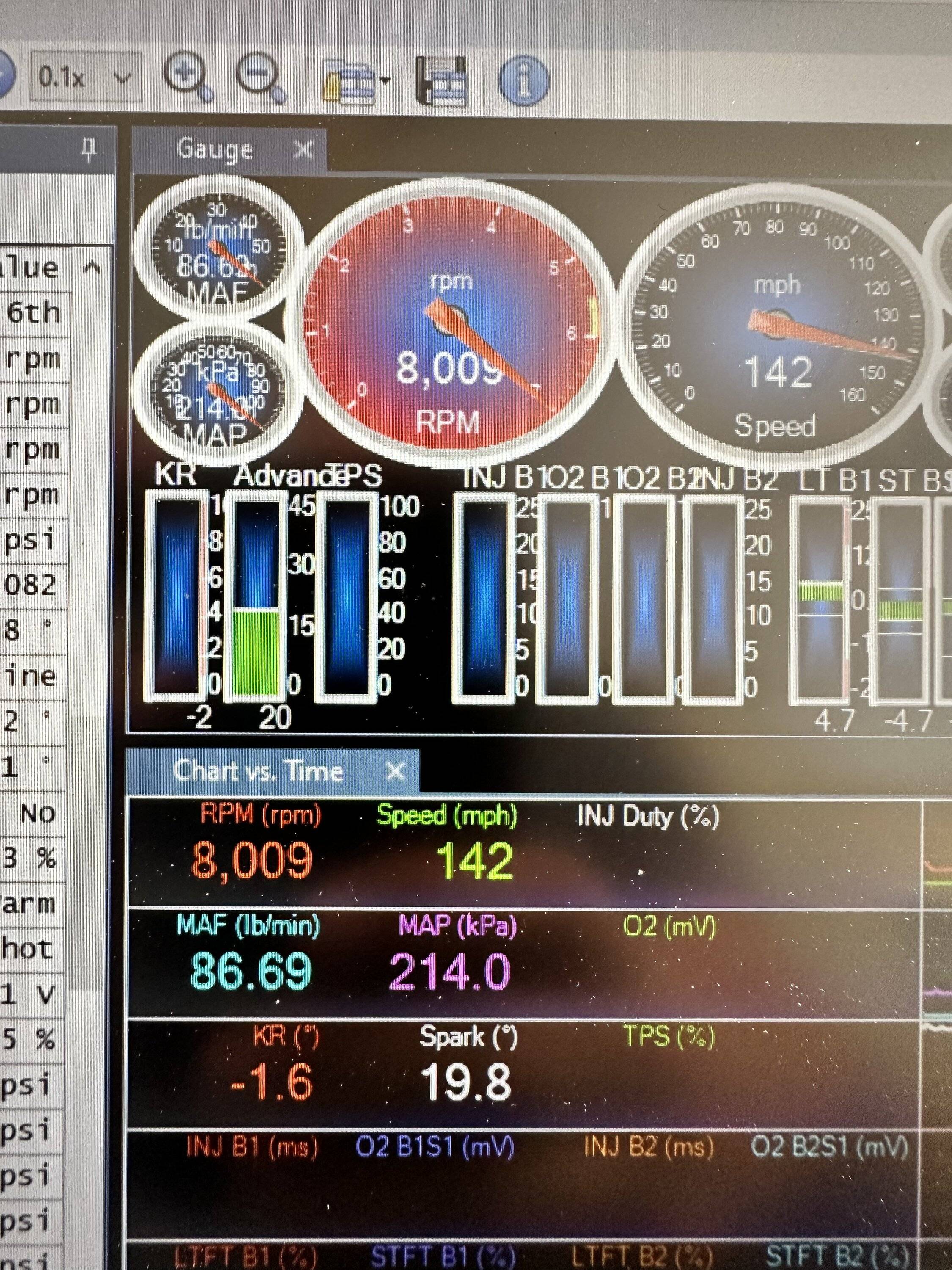

So have you ran yours on pump gas with your supercharger at the track? If so, roughly what time did you see then? Less than 11 seconds?

@PC_GUARD so what is your rev limiter set to? or what would you recommend?
@GregO good news Wengered IS indeed my tuner, and i wouldn't mind upgrading the TB to the 87. yes, this is of course more money, but if i can do it all in one shot and not have to tear the car apart multiple times, that would be nice. how is the GT350 IM more plug and play with the 15-17 cars?
I believe mine is set at 8k, I shoft around 7500 ish, probably hit 7800 between the shift.
I agree with Greg. I was going to do the 18, had it in my shop, and opted for the 350 due to the simplicity.
