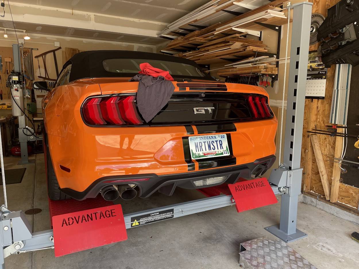

Roughly. What the distance from the roof of the car to the floor when lifted?
gone_n_60
Aug 14, 2018
67
1,209
1,501
Indianapolis
Whit
2020 Mustang GT PP Convertible
It's under a foot but "just enough" according to the guys who installed it. tbh I was lucky enough that for some reason the builder always made tall garages when adding a basement, little over 11'. The Garage folks did the high lift, new side motor and lift install after measuring and getting exact height of the cars. I actually can park my Passat TDI under the GT.
