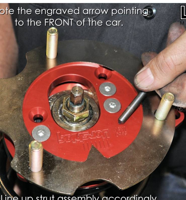

Gotcha. I plan on doing mine next week. According to Vorshlag, we can get -2.8 camber without having to widen the hole on the top of the strut tower. You cannot adjust caster once they are in without dropping them back down so ideally it would be good to know where to set the caster before install. I’ve watched several videos and searched for info on the caster setting but have had zero luck thus far.
From their site this is the closest I can find but it’s not in the car but it is installed on the strut.

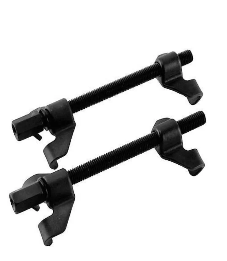

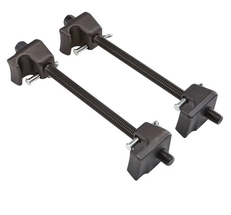

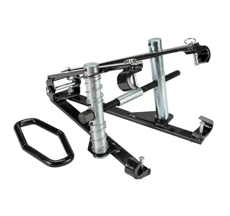

I’ve done several lift kits etc and have a lot of experience using spring compression tools. I go to Autozone and do the free loaner tool program. Just take your time and compress each side a little at a time. The tool I use is two screw driven parts. One goes on each side of the spring. Sometimes the challenge is getting enough compression while clearing the strut top with the wrench or the other end depending on which side you can get more clearance.
I’ve not used this exact one before that Advanced Auto has. Looks a little more stable than the Autozone ones.
Second pic is the Autozone one. Knock on wood I’ve never had one fail or cause injury but I know it can happen.
The third pic seems like an easier tool to use but I’ve not used that style.

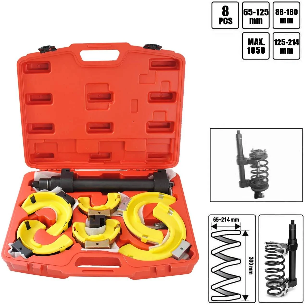

Thank you, the style of the first two photos is what seems most easy/cheapest available, and it's good to hear of your experience. I've seen the one in the third photo also, but seems rare compared to the first style. Also I've seen this one, though it's a step up in price (around double is the lowest I've seen):

The one in red box looks reasonable.
I've used all three from the previous post - first one looks sketchiest but looked the best - I've done Mustang and F150 springs with it, used impact to compress and only slight issue is that the the long threaded rod is being visibly bent once you compress the springs. Not great for something that's supposed to be in tension.
2nd one is same thing but safer, however doesn't fit over thicker diameter coil springs.
Third one in cheap version is absolute junk and useless. OTC's version of it works well but it's expensive.
No free loaner programs here that I know of unfortunately.
Only compressing one side seems very sketchy to me. I would not use that one but I have never used one like that and it very well maybe the safest one. It looks like the the spring could launch itself out the opposite side as the spring bows from only one side being compressed.
I have seen the threaded rod start to bend some and it is very unnerving to see it. It makes me pick up the pace a little and get things switched over and release the tension for sure.
Hehe, I was thinking the same thing, but the reviews are all positive, so thinking it must appear better in real-life usage. I'm guessing the intent is for the plates to be big enough to cover more than half the spring circumference, so that the spring will compress equally on both sides and does not bend like that, but not sure how it will match the diameter of Mustang springs.
