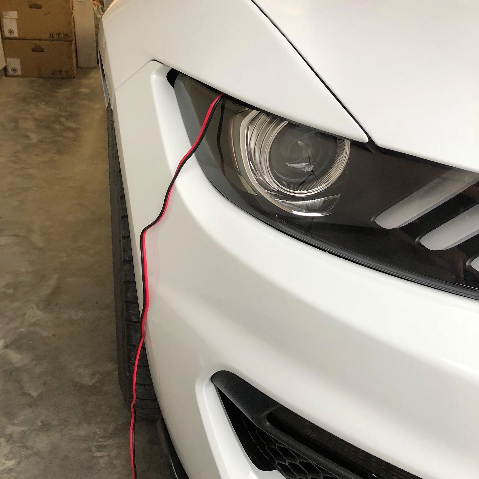

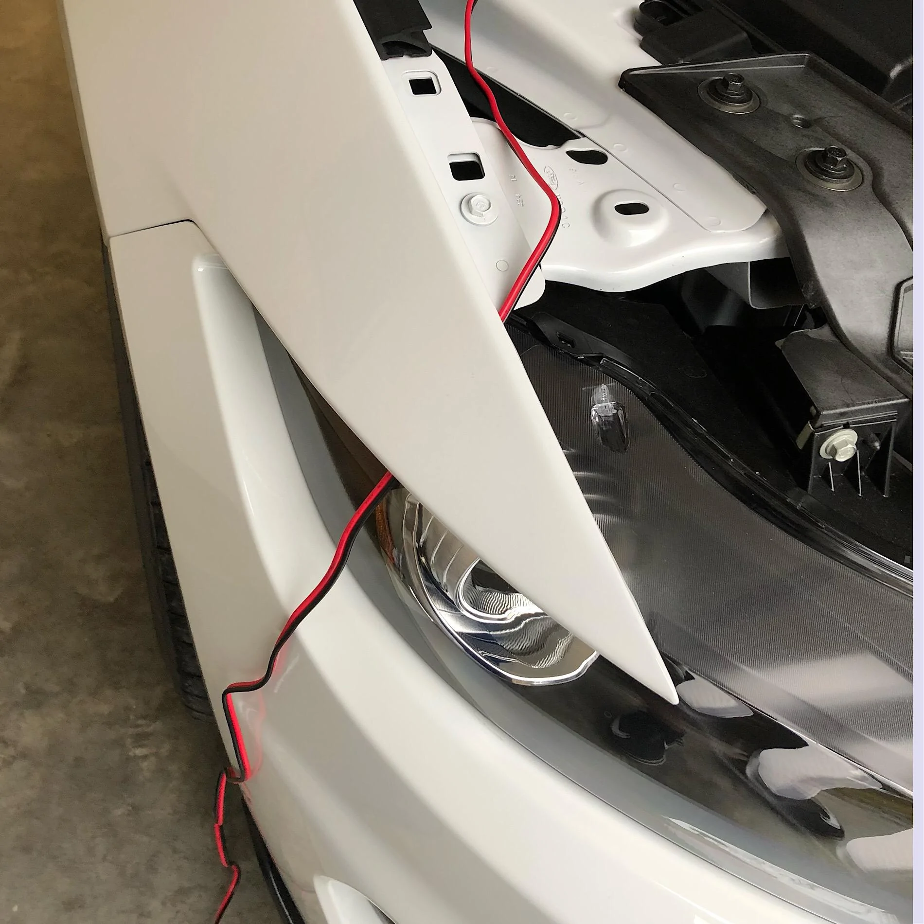

This is how I have mine too. The only thing that bothers me about this set up, is if someone trips over the cord and bends the fender outward there at the headlight. that piece is weak...

Depending on how much slack, you could feed it ip through the hood and down the side....
I have a low traffic garage, essentially just me when it’s plugged in.

I had it the same way on my 16 and 17 with brand Battery Tender. But you can buy an extended cord that is longer from them on there website that might reach through the hood and then down the side.

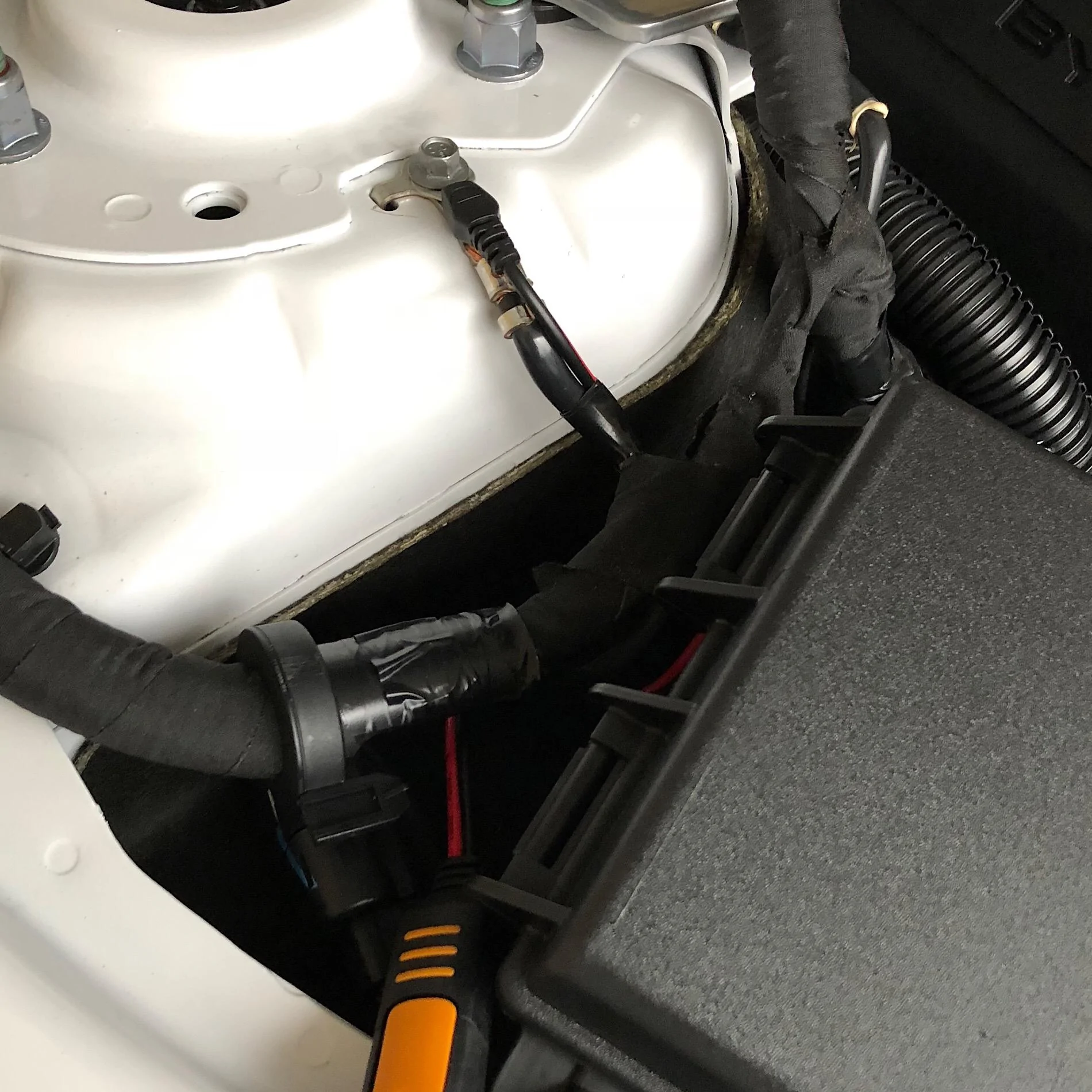

Simple (But Clever) CTEK Battery Tender panel Install

I just used the 2 loop connectors (instead of the alligator clips). Hooked them to the positive and negative on top of the battery (underneath the battery cover) and leave it there. Zip tied the female plug to the shock tower. Plug the tender in when needed. When not in use cover the connection. You don't even notice it's there.

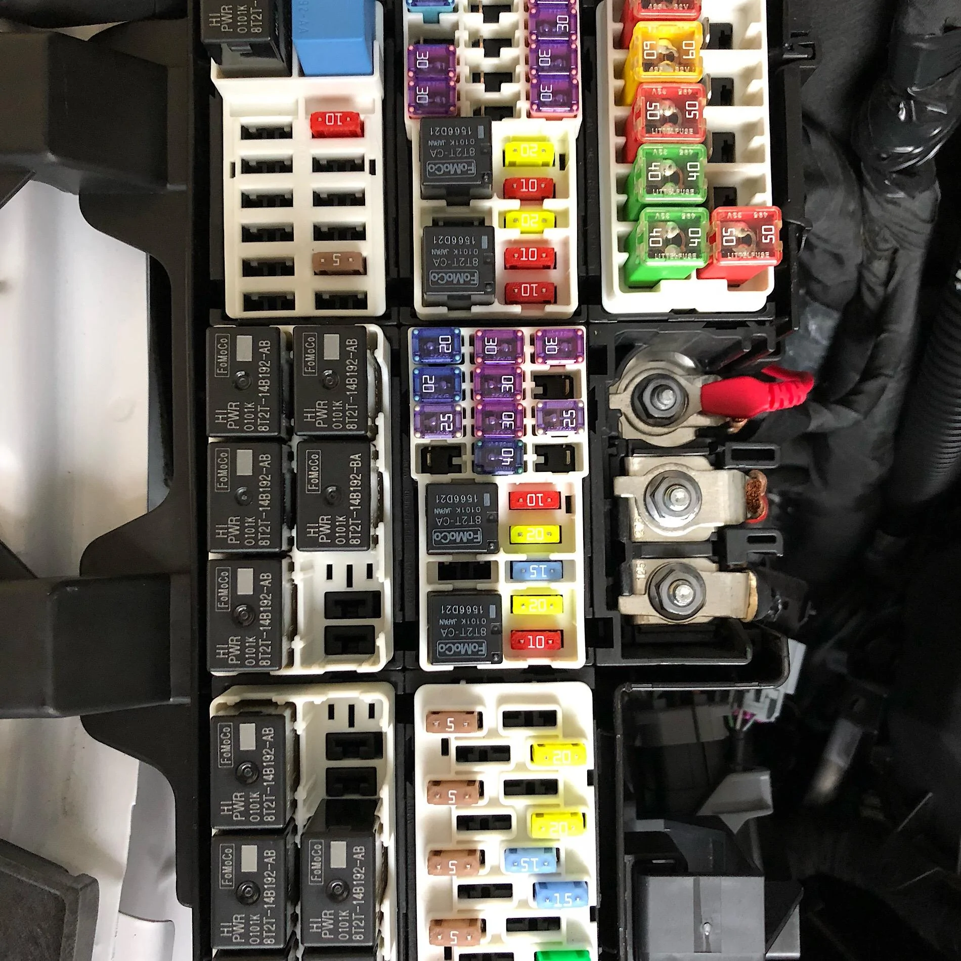

What are the pros and cons of directly hooking it up to the battery vs. the fusebox and ground point?
