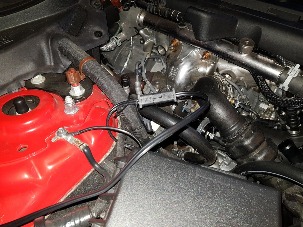

A 2017 miraculous little beast

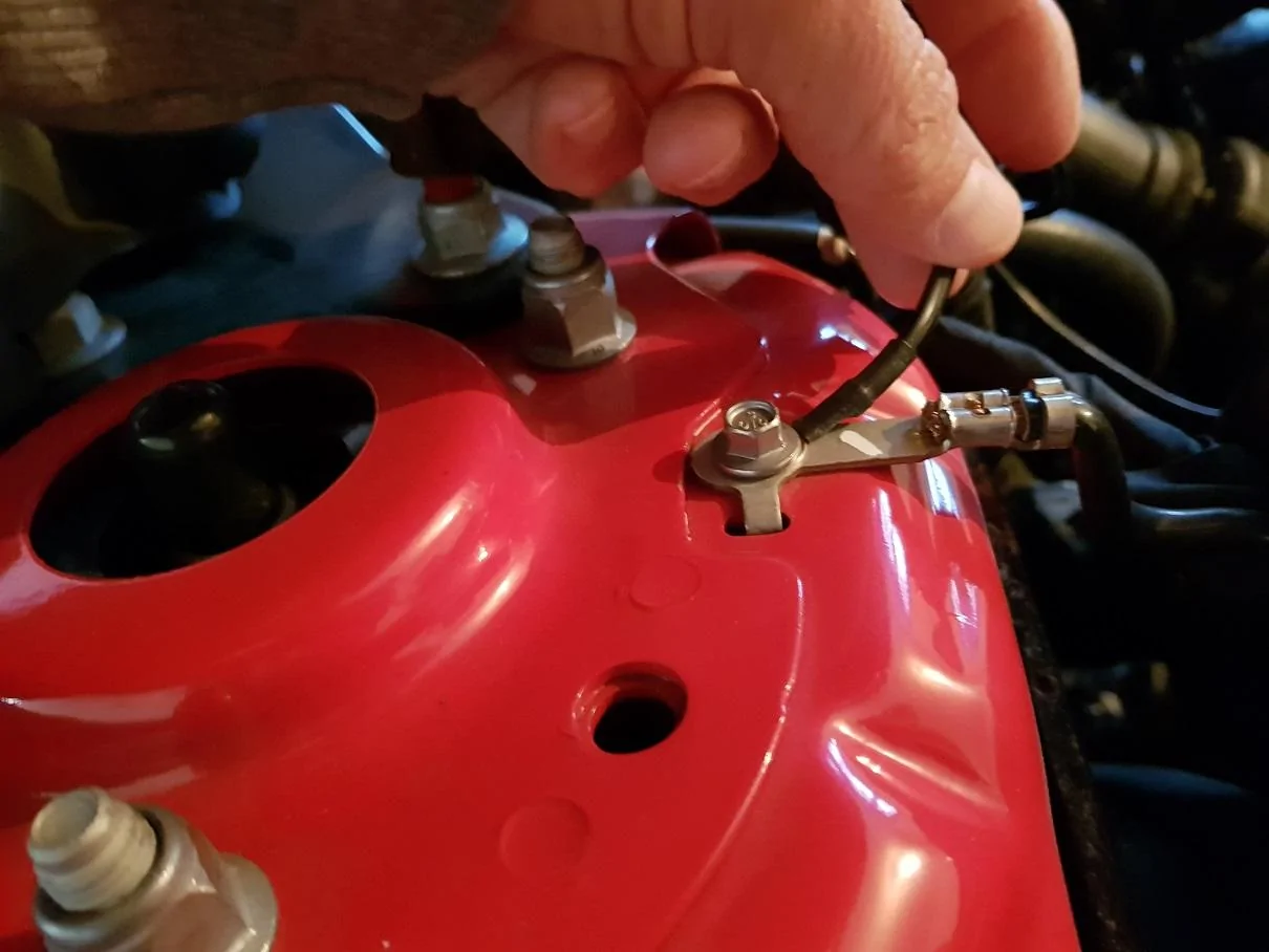

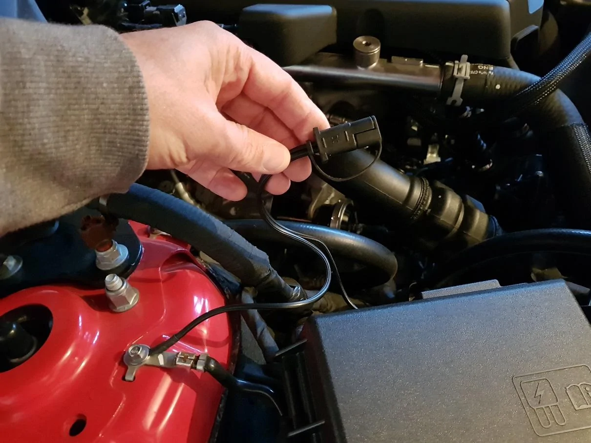

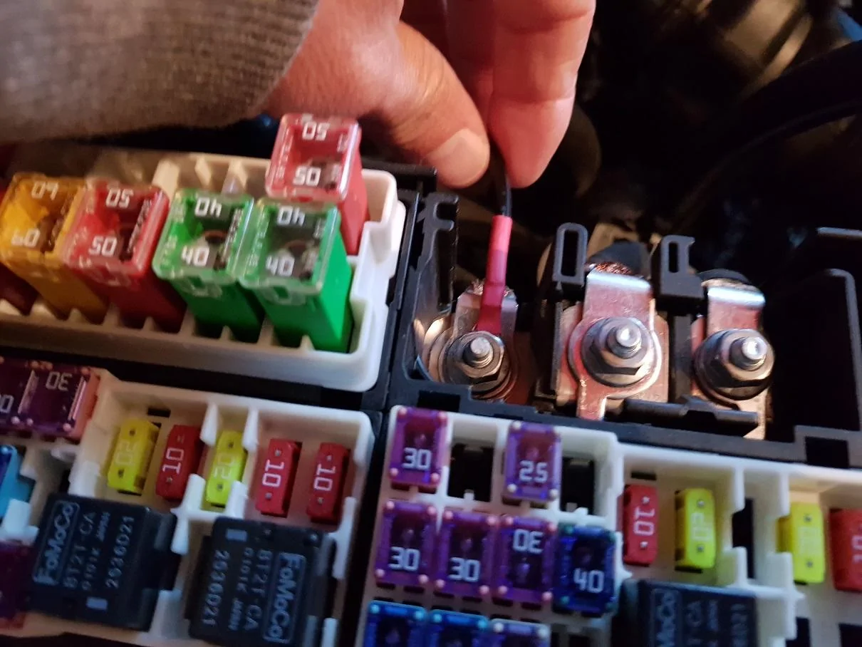

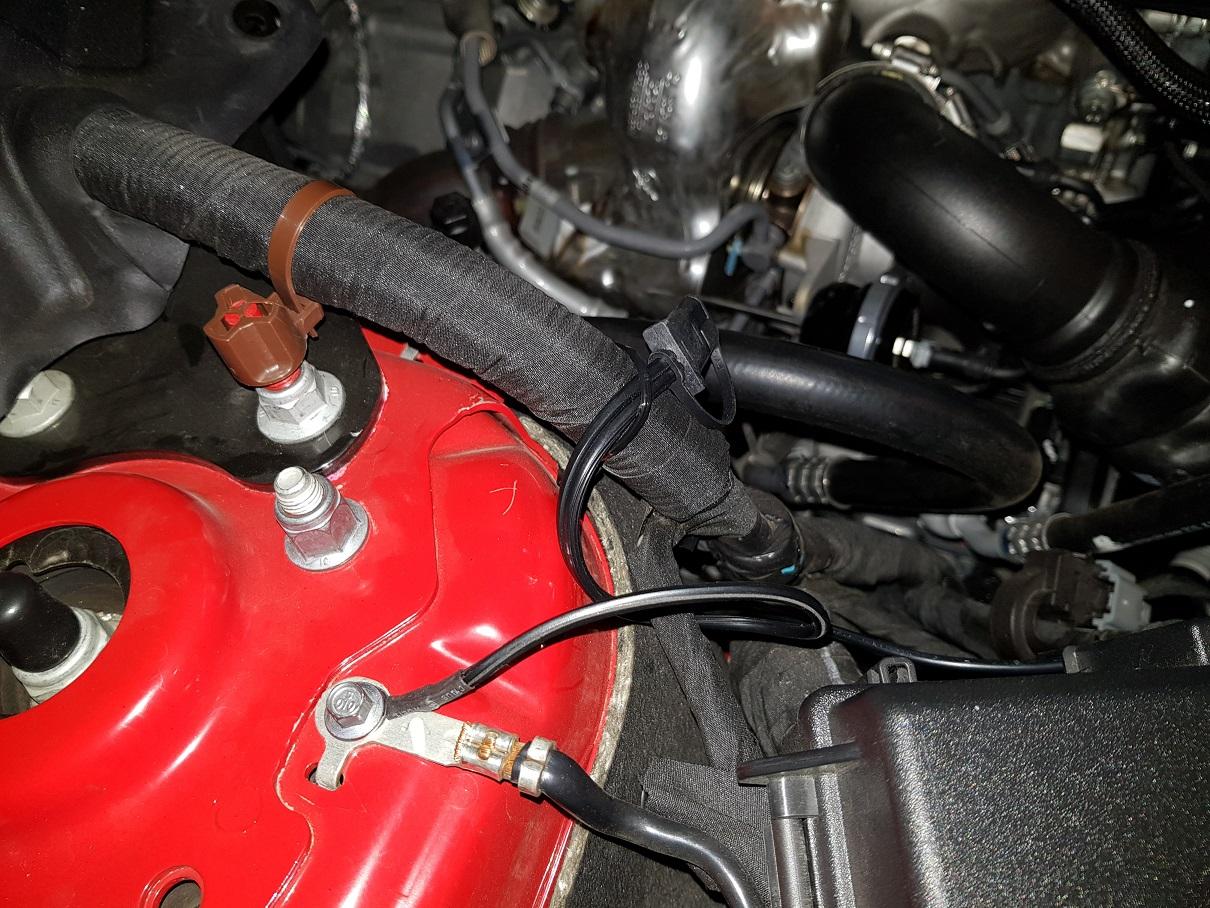

I did this as well. Instead of connecting the alligator clamps to the battery every time (risking to knock them off when I close the hood), I installed a permanent mount kit which is now permanently located in my engine bay, waiting to be connected directly to the battery tender. For that, I used a power connector cable with ring connectors. I connected the red wire to the positive terminal on the fuse box and the black wire to the nearby ground on the strut tower (see photos). I secured the quick-connect plug with a zip tie, et voila!

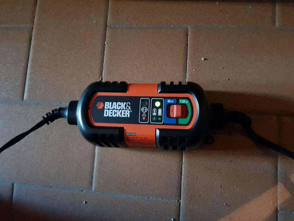

Now, every time that I plan to keep the Mustang parked for a long time, or even for a few days (especially during the winter), I simply connect the Black & Decker maintainer (model BDV090) to the quick-connect plug. Fast ‘n easy!
Photos in order of installation, as described above.

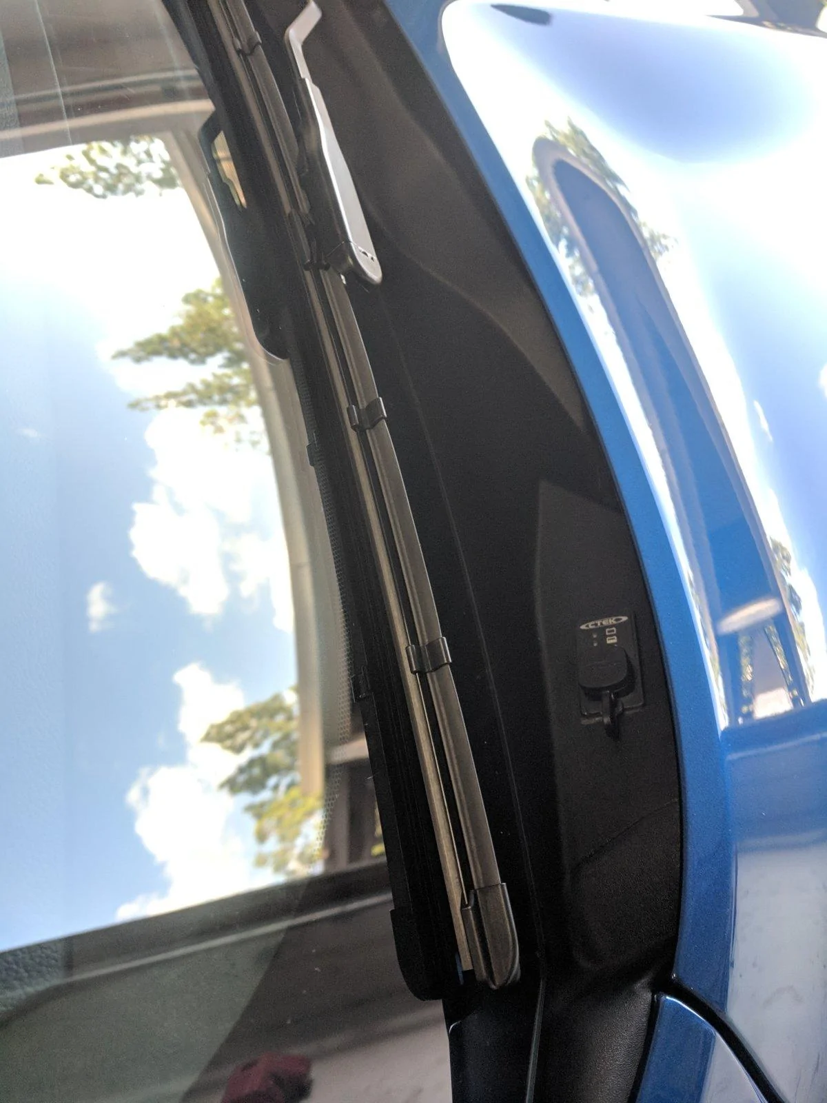

I installed the NOCO G7200, the connector tucks under the hood by the right windshield wiper, easy and out of the way. It has a water proof cap, when I am charging the box sits on the windshield just above the wiper, can be without or without car cover on. The device works great
