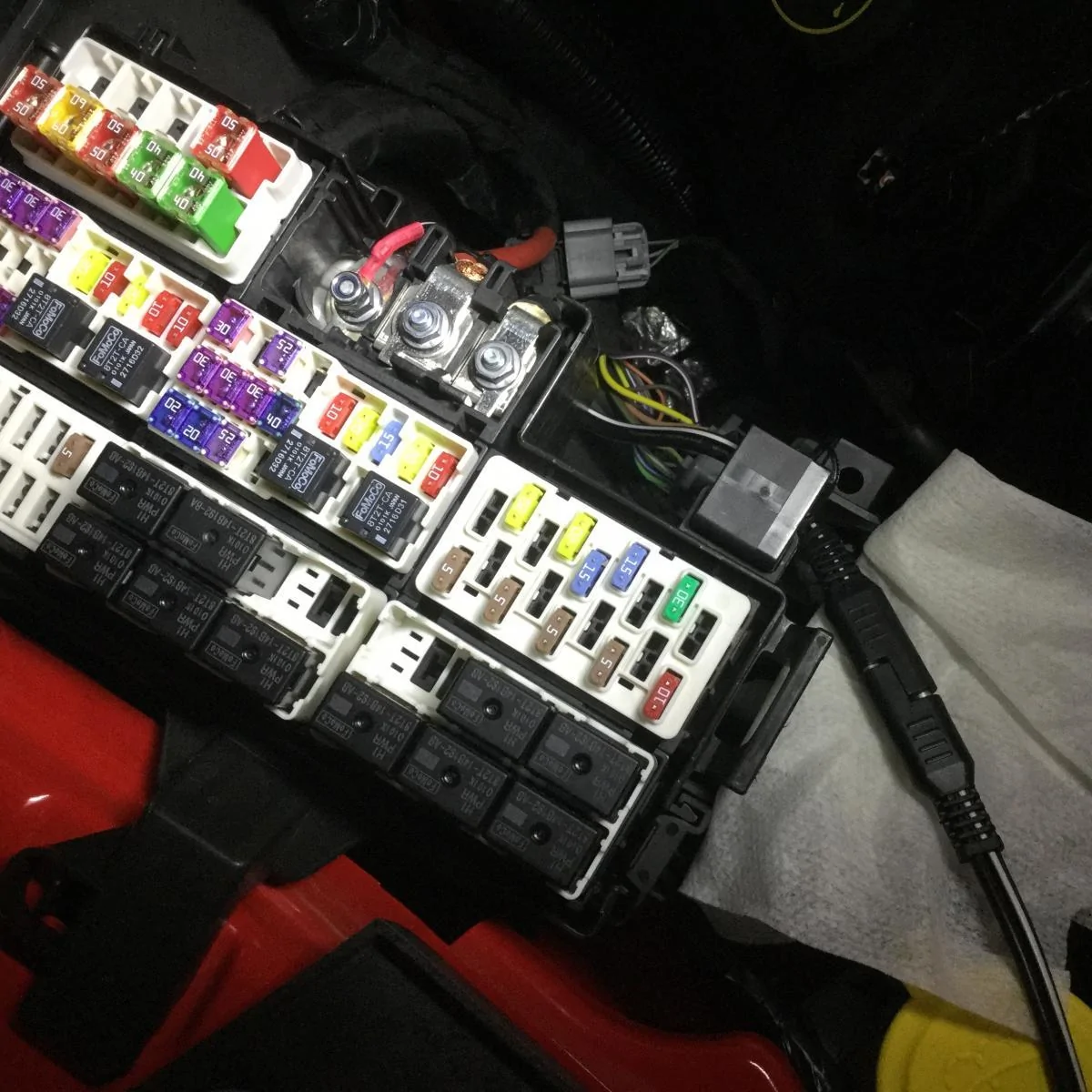

I posted the pix where the wires were connected to the positive terminal on the fuse box and a nearby ground on the strut tower (top left corner of the second pix). Works great and is convenient to connect the tender.

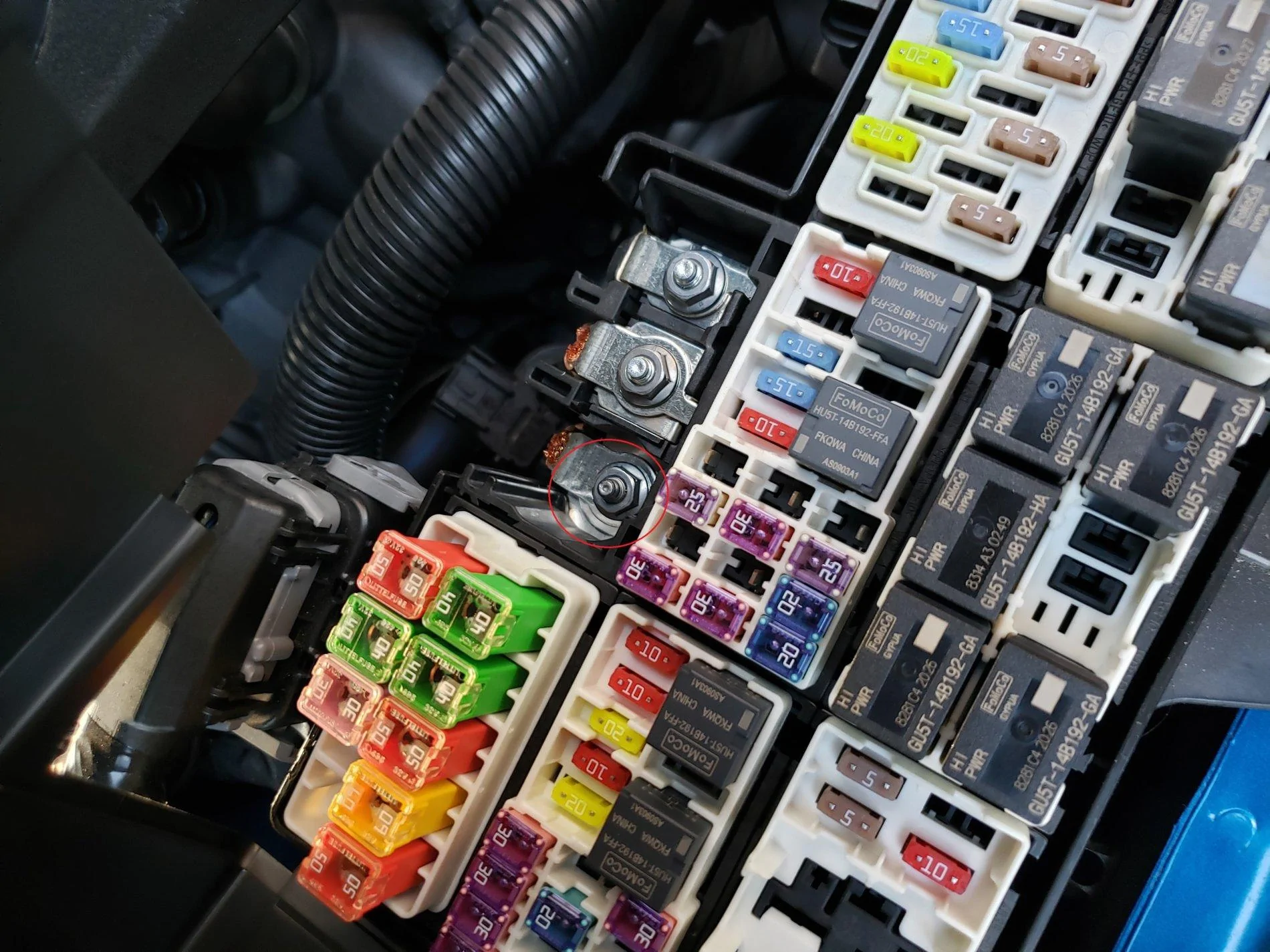

I'm just about to do this on my 19 GT. I bought a couple of M6 nuts with nylon inserts as someone mentioned and was going to put that on the wire to the battery from the fuse block in the red circle attached? For other ground on the fender will the ECU or Trans reset if I undo that bolt to put the ground connector on? Or does it stay attached more or less even when removing the bolt. Perhaps a silly question but I assume the fender bolt is self tapping and there is no nut on the other side underneath from that? I just don't want to goof anything up & figured I'd make sure by asking here first.
Yes, put the positive lead on the circled post.
The negative ground can be placed with the current fastener on the fender. It won’t come loose when you first remove it.
Thank you sir! I got it on this afternoon. I couldn't use a spare M6 nut as my car didn't have enough thread exposed to make it bite when I tried to tighten it which was weird. So I removed the factory nut on the fuse block and slid the ring under that nut and tightened it back up. I had the lights flicker a few times doing that which freaked me out a little lol but I guess it lost contact a couple of times until I could get it snug. I used the shock tower the same as you did and it seems good.
My only gripe with the Battery Tender connector is the fuse block on it is not very far from the positive ring clip so its a bit stiff to close the fuse box lid unless I make sure the fuse thing is in the right spot. Another inch or so would have made it easier for sure. But its fine in any case I just would have preferred a bit more length before the fuse.
