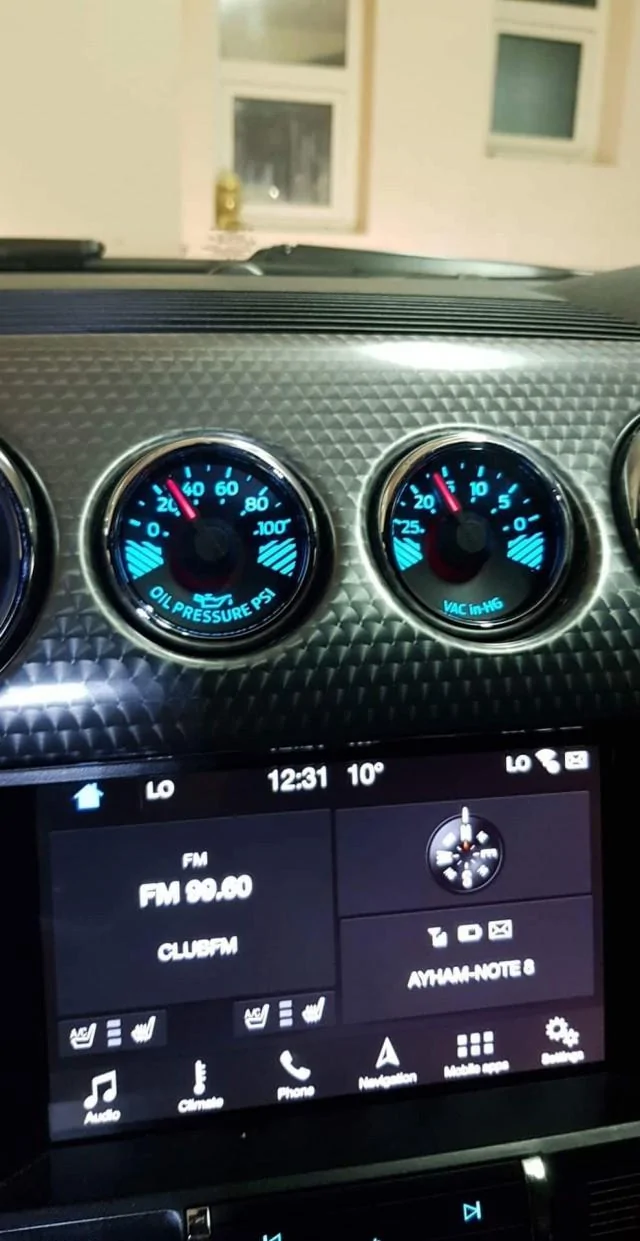

Just installed the PP gauges on my new GT, I was wrong the oil pressure gauge works ONLY after a tune!

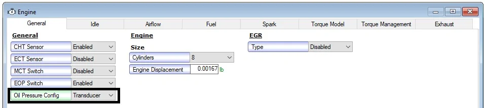

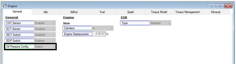

As stated, you do have to change a couple of things in the tune for the ECU to broadcast the actual oil PSI reading after installing the gauge pack. The non Performance Pack GT's that utilize a dummy 'switch' have the tune set to recognize the simple open/closed oil PSI switch (8psi setpoint). When adding in the transducer and making the oil pressure actually 'live', the ECU has to be changed to recognize the actual live psi/voltage measurement.
Stock non PP settings before the swap:
Settings on a stock PP Transducer settings (and required after PP Gauge Pack Install):
So you installed no hardware for the oil pressure. your tune brought it alive does it move up and down when you hit the gas? because I honestly don't care if it's perfectly accurate. I like the looks of it and I won't mess changing all that other stuff if the tune will bring it alive
