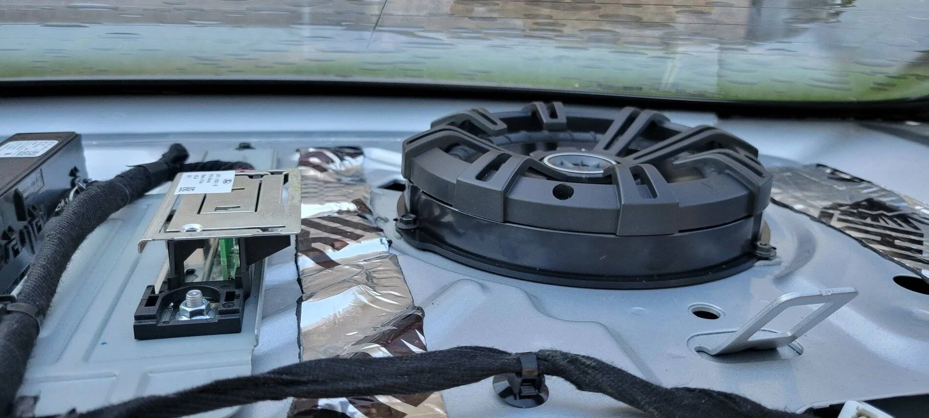

Like so many people I have been left wanting just a little more from the stock (9 speaker) system so after different issues in the past and reading posts I kinda deduced that the only speakers that are easily replaced are the lower door and rear deck speakers bc the system will make weird noises if you change the ohm rating.

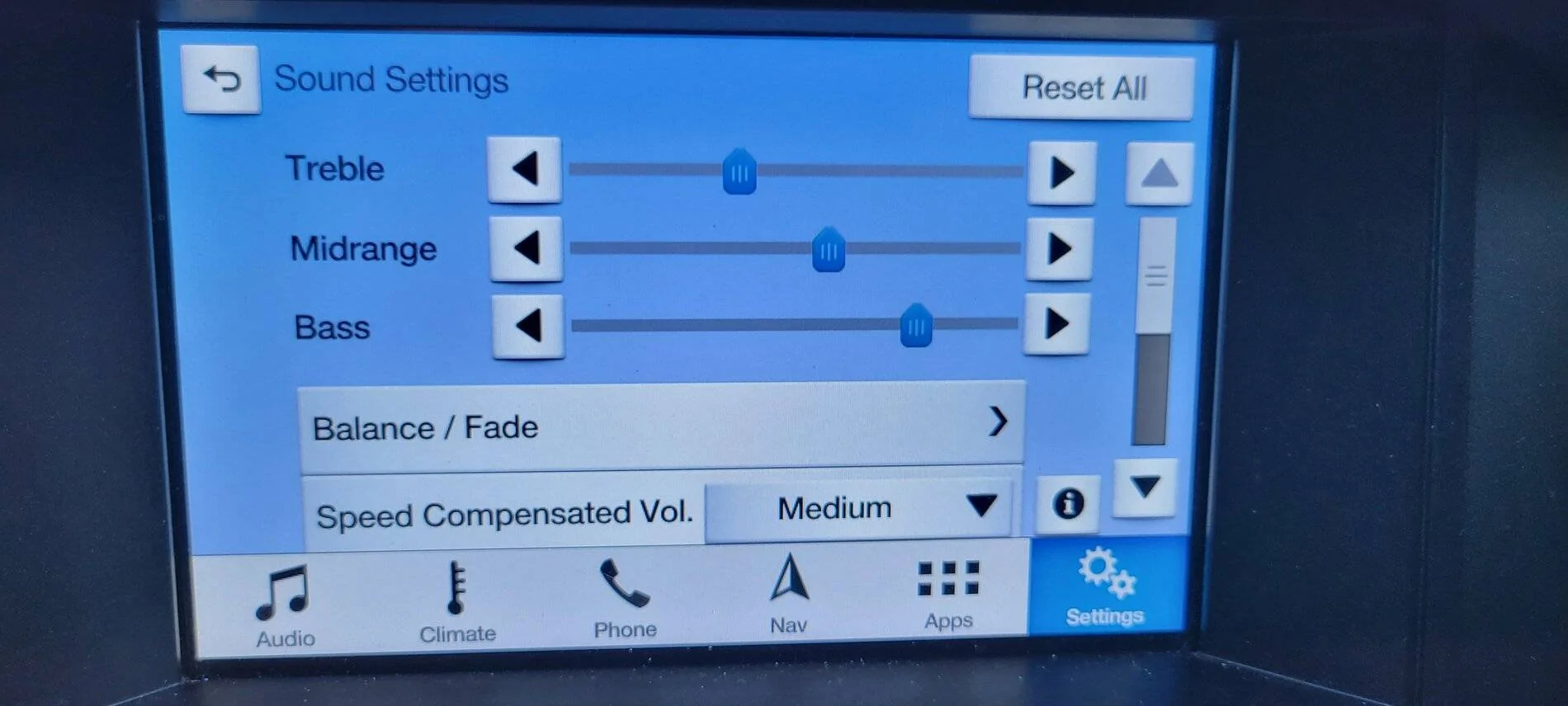

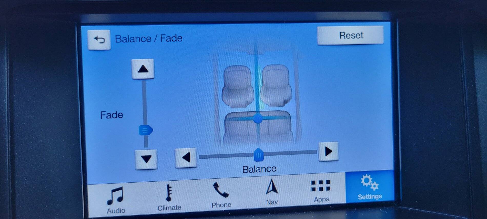

I'm not likely to get an 8ohm or other rated ones for the tweeters, so that leaves me with the 4ohm speakers. I hate the eq and it's center staging eq with has highs in the front and lows in the rear. (Even the 12 speaker rear coaxial aren't good)
I ordered a pair of kicker 6-3/4 w-way speakers from Crutchfield
to better balance the eq. And NOW I'm cooking with gas. Everything plopped in place (plop sound not included, must supply own fx) without hissing, whining, or other noises.
They fit in without modifications, just need to tweak the eq again. after that I think I'll be happy with it for a while.
Just thought I'd share the info considering Ford did not make it easy. Now on to the other things.

Ok, I have to ask. Why replace the rears and not upgrade the speakers in the doors and dash.....after all, they are the ones providing 95% of what gets to your ears.
Viscosity6 5
Viscosity6 5
Feb 18, 2021
18 Mustang
The 2 way 4ohm speakers for the rear are much easier to find.
I dislike the front staging and isn't balanced(front to back).
The factory Ford system will have noise issues if you change the ohm rating.
Finding the 8ohm replacement front speakers isn't easy(or cheap).
Also, I don't need a whole new system if only a few will do.
