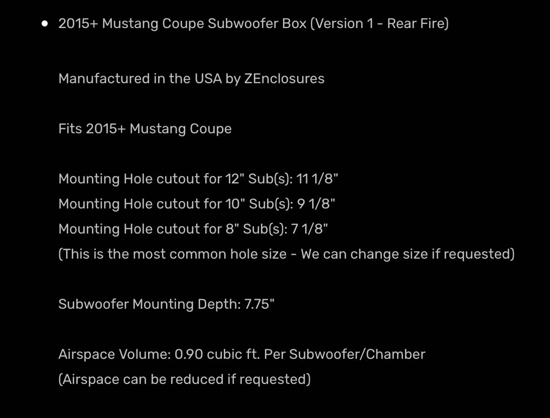

I have two JL Audio 8W7’s and I’m having a hell of a time finding a box!

Contact zenclosures.com for one of their Type 1 boxes: https://www.zenclosures.com/2015-Mustang-Subwoofer-Box-p/mustang15t1rf.htm Just send them the hole diameter for the 8W7s.

PS - I looked at zenclosures, that box is only 1.5 cubic feet. 2 8w7’s require 1.87 cubic feet sealed. :/

Two 8W7s, sealed, needs 1.75 cubic feet per JL’s recommendations.
You are leaving out driver displacement which is .06 for the 8w7. Which makes Gross vol. per sub at 0.935
I’d contact them about a minor box size adjustment.

OF5.0 so I heard back from zenclosure and they won’t increase the vol. of the box. Their box is 1.74 cu. ft. I need a min of 1.87. I went and measured the trunk opening and I get 12” at the narrowest 42” wide and 18” tall. Then I was like hmmm what about behind the seat? I got 16” high, up to 15” deep and 38” wide. Did a quick calculation and a 14x36x9 box = 1.872 cu. ft. There seems to be plenty of room. Did I measure something wrong? I don’t see why they will decrease the vol but can’t increase it a little. I’m stumped.
Getting a custom box made sounds like your only option. The box size opening behind the rear seat is hampered by the metal drop downs on both sides under the rear deck. You are also limited on box size due to the trunk opening. Zenclosures’ Type 2 box only fits in the trunk one way or so it seems. The box construction is very good other than their terminal cups, but that’s an easy fix.
