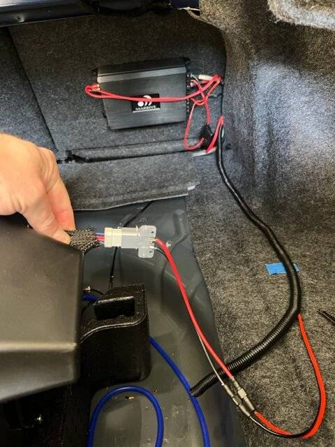

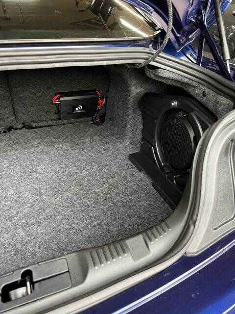

Pleased to announce my OEM subwoofer add-on project is complete. Since I already had an aftermarket amp and sub added to the car a couple years ago I decided to continue using the aftermarket amp with the OEM subwoofer I found. I turned the gains down on the amp to be safe and it still pushes plenty of bass.
I added some pics showing how I wired the OEM subwoofer with the aftermarket amp. I removed the main connector from the OEM amp so that I could salvage the OEM connectors from the subwoofer and amp. I then hard-wired the OEM amp connector to the aftermarket sub wiring.

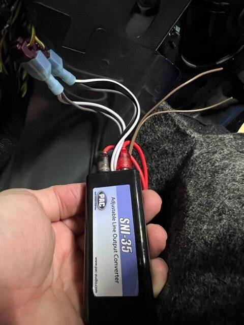

I also added a pic of the aftermarket signal unit that is wired into the factory rear speakers to assist anyone trying to do this project from scratch.
I cleaned up all of the wiring and I now have a near-OEM trunk with no ugly wires with great sound. Very happy with the outcome
