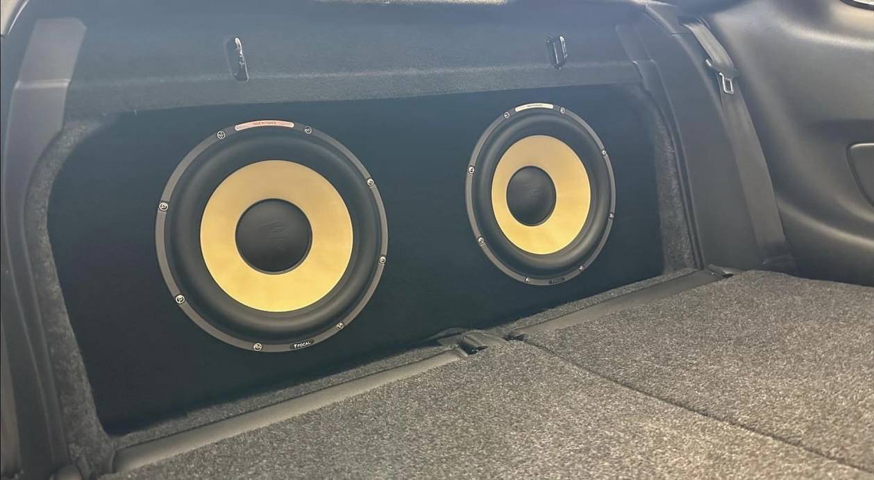

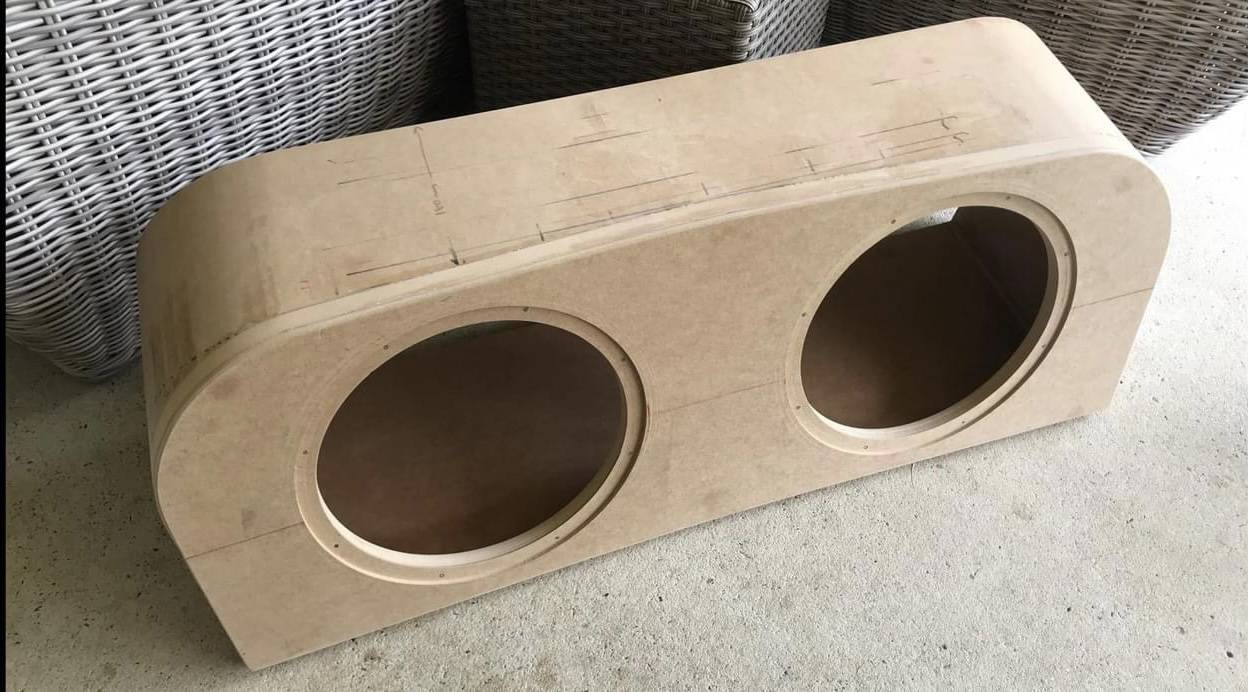

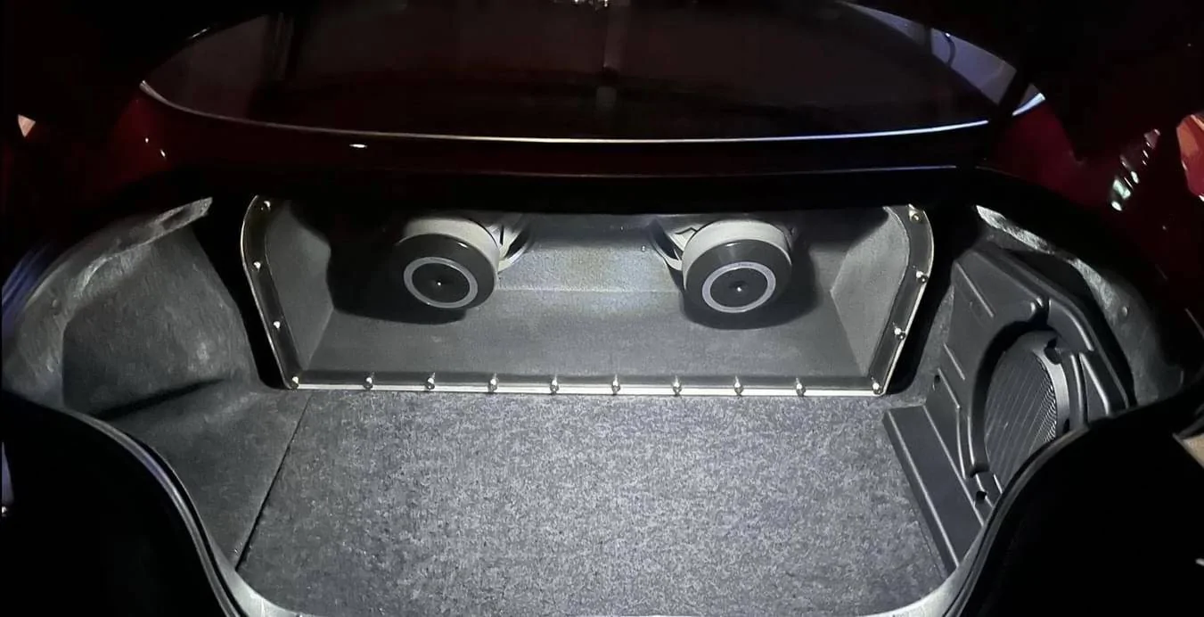

I ended up making my own enclosure up for my twin 12” Focal KX30s as they needed a bit more breathing space than the prefab enclosures could give.
front facing sealed sounds loud and punchy if you can properly seal off the boot, which I wouldn’t trust the Zenenclosures to be able to do as they use a panel on the front face that mates up to a standard shaped box. I’d probably chose a rear firing box in that scenario.
in the pics you can see that the custom box shown has kerfed edges which perfectly fit in behind the rear seats with no gaps, which enables a good seal for front firing subs without bass cancellations from the boot area.
the custom enclosure size is exactly 2.2cuft empty. Check the zen enclosure size dimensions as they may be a bit smaller. Other than that they should look similar to the pics shown when finished 👌
hope your system goes well once it’s installed and send us some pics of the end result!
