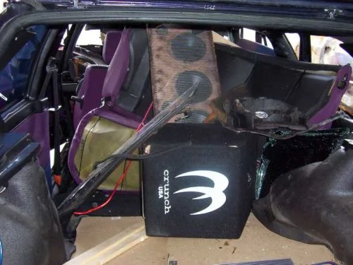

Well, that accident was with a speed of around 70 km/h (around 43 mph).
The subwoofer was press fitted between seats and closed boot opening, so according to the guy that had that accident the subwoofer couldn't move in the trunk.
Now i don't want to know what will happen if you driver with double that speed which will quadruple the kinetic energy of that subwoofer box in case of an accident compared to the energy that was released in that accident. The seat latches wont hold the weight in this case. They are just not strong enough.
Don't underestimate the kinetic energy that heavy objects can generate in case you decelerate to almost a dead stop within a second (like in an accident).
http://h-3.abload.de/img/umfallmithutablage3jwq3eb7.jpg
Someone calculated that the kinetic energy of a first aid kit equals around 25kg in case of an accident with around 40km/h (25mph).
Don't get me wrong. If that box in the pictures had a wedge shape it wouldn't have been so severe, but still... better tie it down somehow than being sorry later.
I also do not understand why the Mustang doesn't have some lashing eyes on the sides of the trunk. Would make it far easier to secure things that people might have in their trunks, especially if they're heavy.

Very informative.
Random- Made in USA, the product did its job! CRUNCH

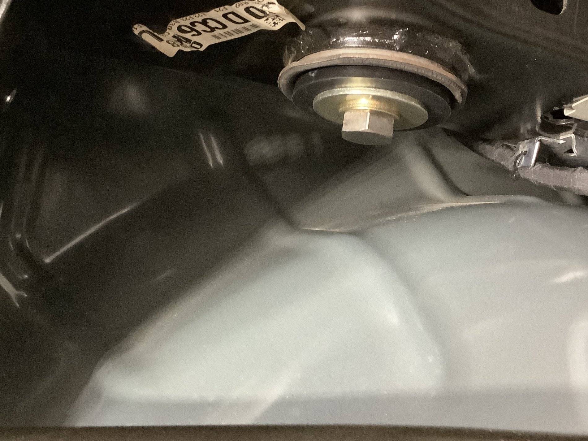

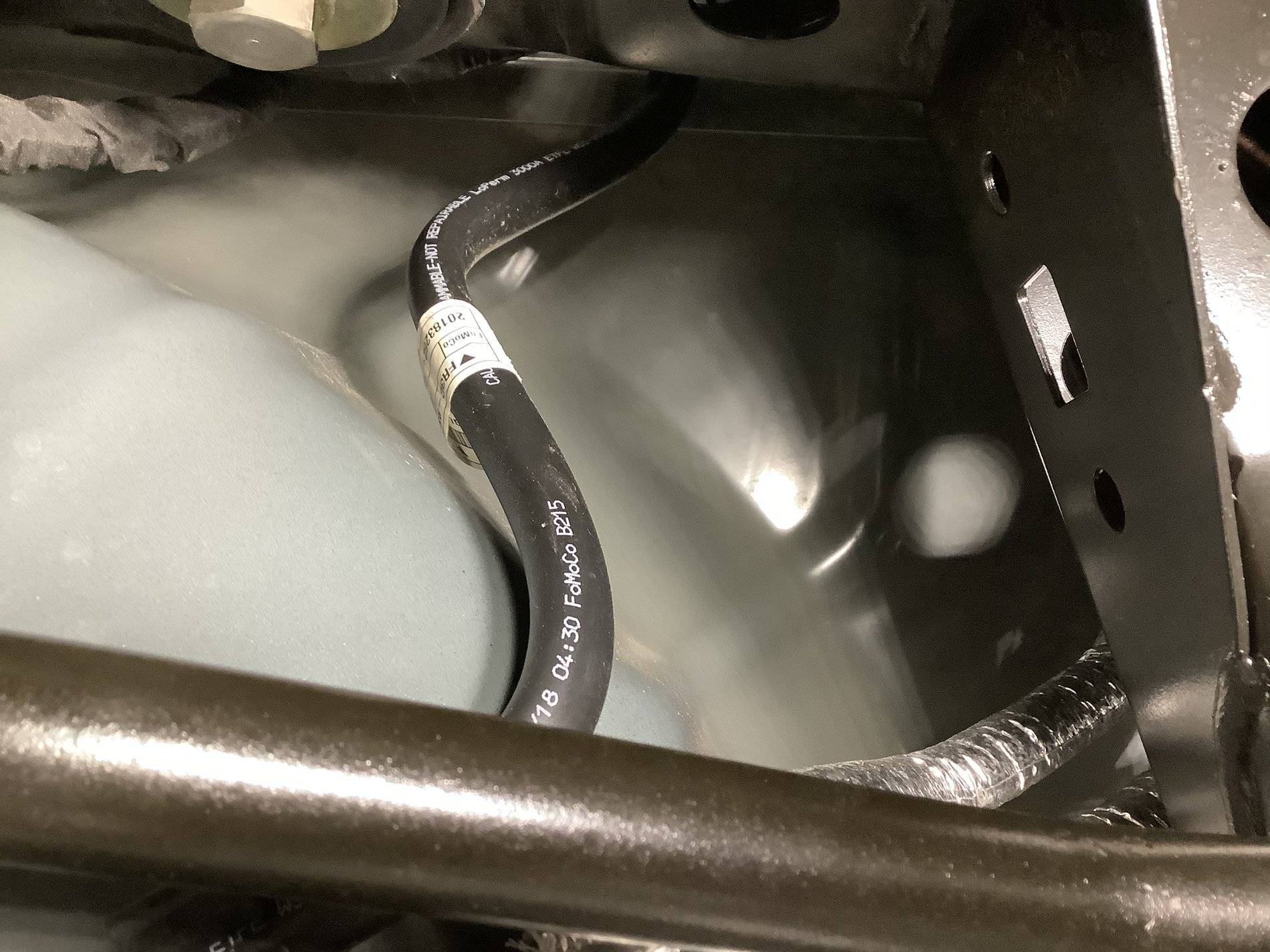

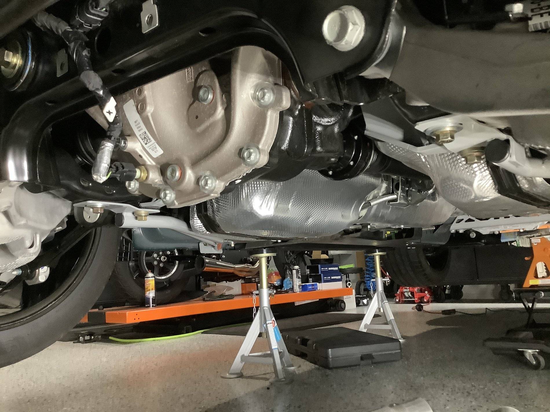

The fuel tank should not be an issue for you at all. Here are pics on either side of the spare tire well. As you can see, there is more than enough room to safely install threaded inserts.
Right side pocket area in front of spare tire well.
Left side pocket area in front of spare tire well.
Fuel tank; way forward of differential.

Thank you very much, @NGOT8R ! Greatly appreciated. BTW, do you even drive your car? I could eat off that undercarriage!
So it looks like the fuel tank is underneath the left passenger seat, behind the driver. Of course I'd be extremely careful and drill from the bottom, but I should be able to sink a couple of inserts in this general area, circled in red.
