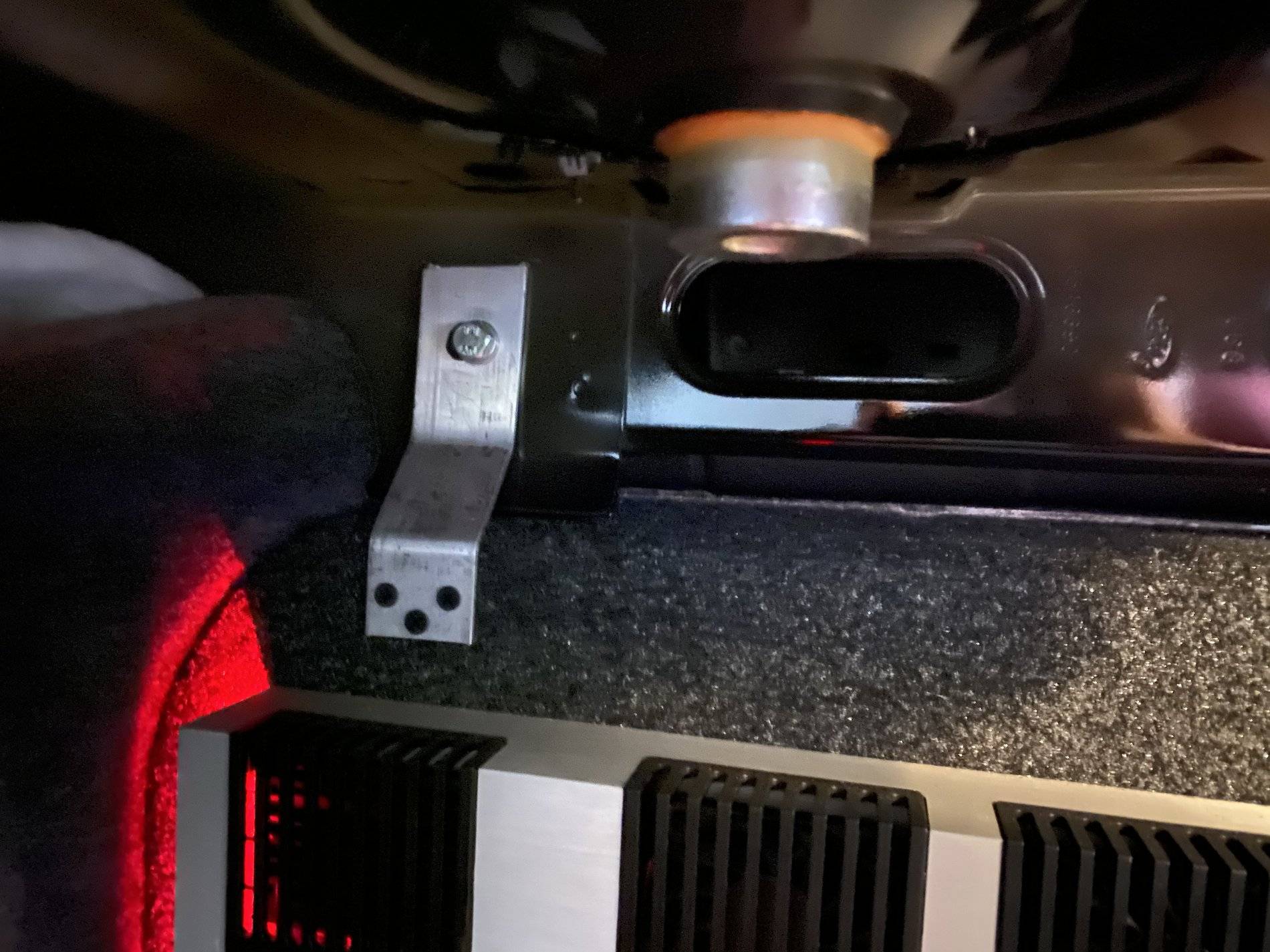

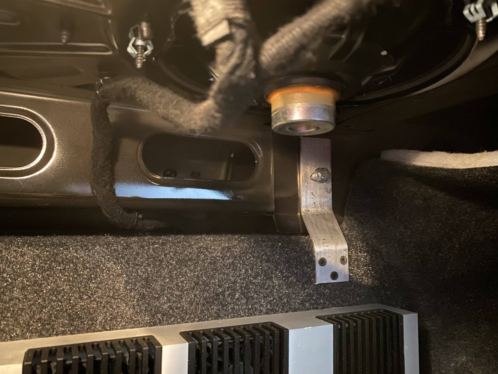

Get at it ...jk , we all work at our on pace . Some more pics from the trunk side , sorry not the best , the sun was giving in me fits . And I'm over 750 rwhp and this thing will not move on a hard hit .
I too am using a Zenclosure, although it’s not as tight fitting as yours. I had to use metal straps to keep it firmly in place. The bolts went through existing holes if I remember correctly.
