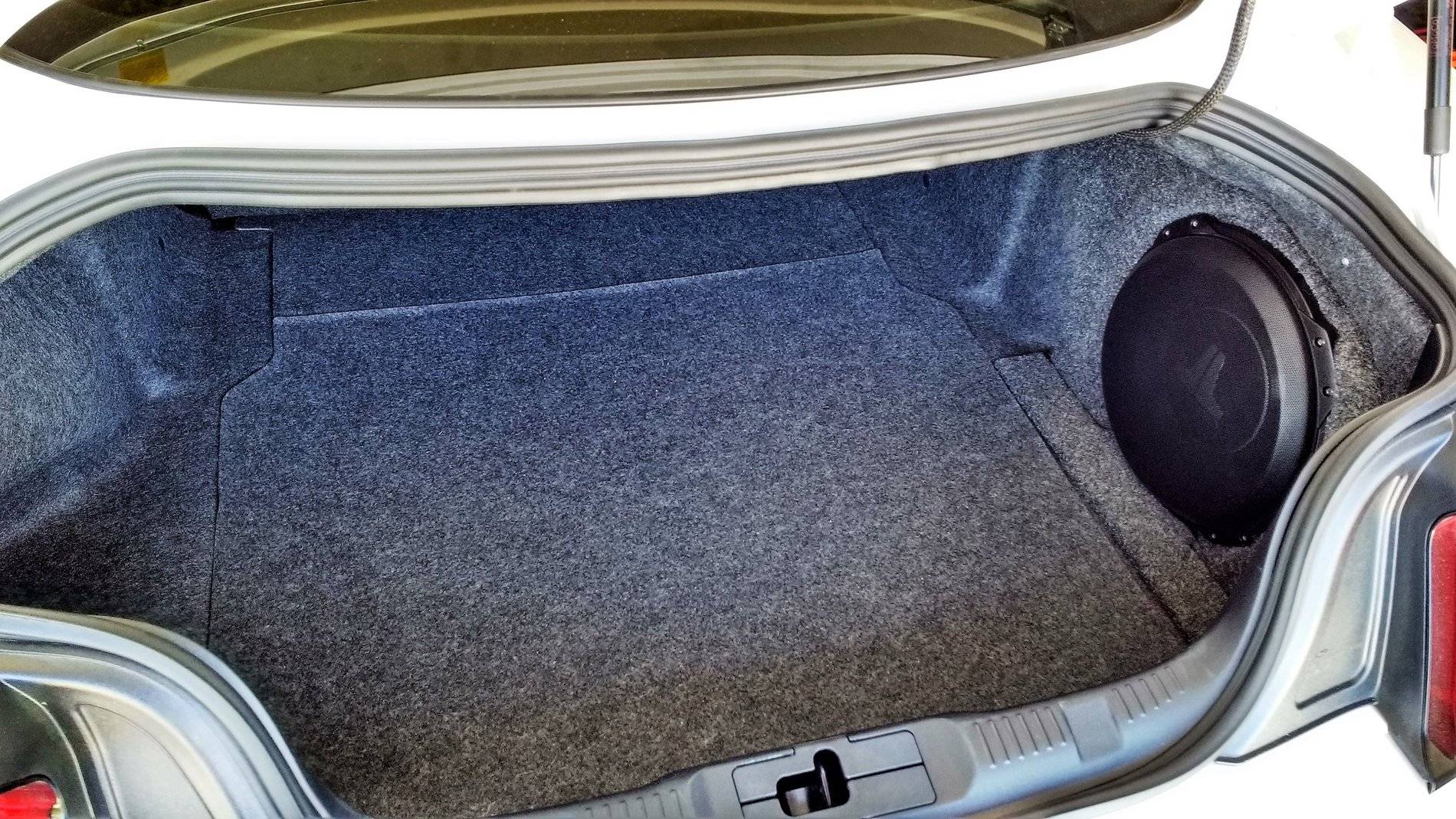

I'd be a bad OP if I didn't post a pic, so here's my boring pic of my Stealthbox in it's home. It's bolted to the floor and corner behind the taillight using factory mounting points.

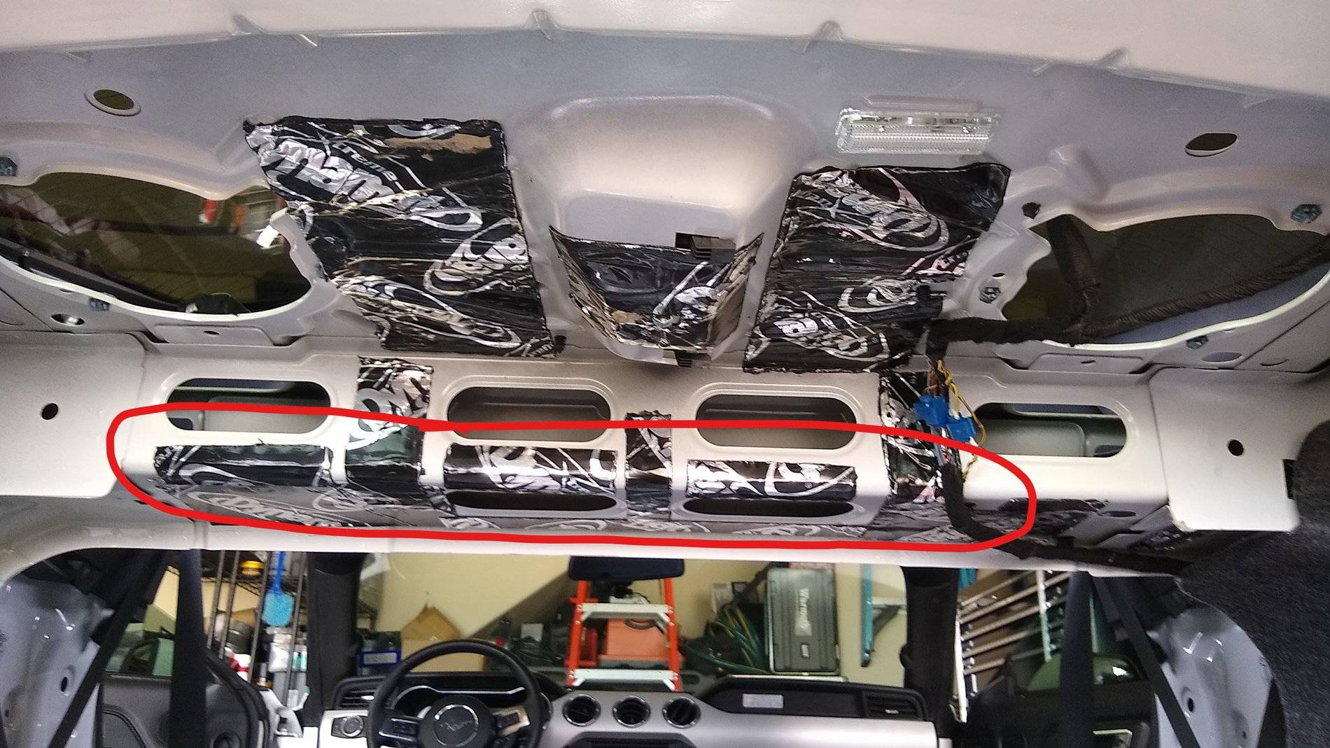

I use lashing straps attached to the ISO mounts for child seats. Make sure to strap them down hard and tight. Don't bolt into the floor as the tank is right beneath that area. Too risky.
You could bolt it to the metal above right behind the seats, i.e. an upside down bolt, but only if the enclosure is tall enough.
For this i would take some metal pieces, drill holes into it aligned with holes in the metal above the enclosure and cut some threads into it. then bolt down from the inside of the box. Use at least two metal pieces with two bolts each to distribute the load. Use washers to get it sealed.

That's a great idea. Some metal L-brackets bolted to the top of the sub box and attached the metal brace under the rear deck.
This part here, circled in red.
Put some threaded inserts into that brace and bolt the box to it.

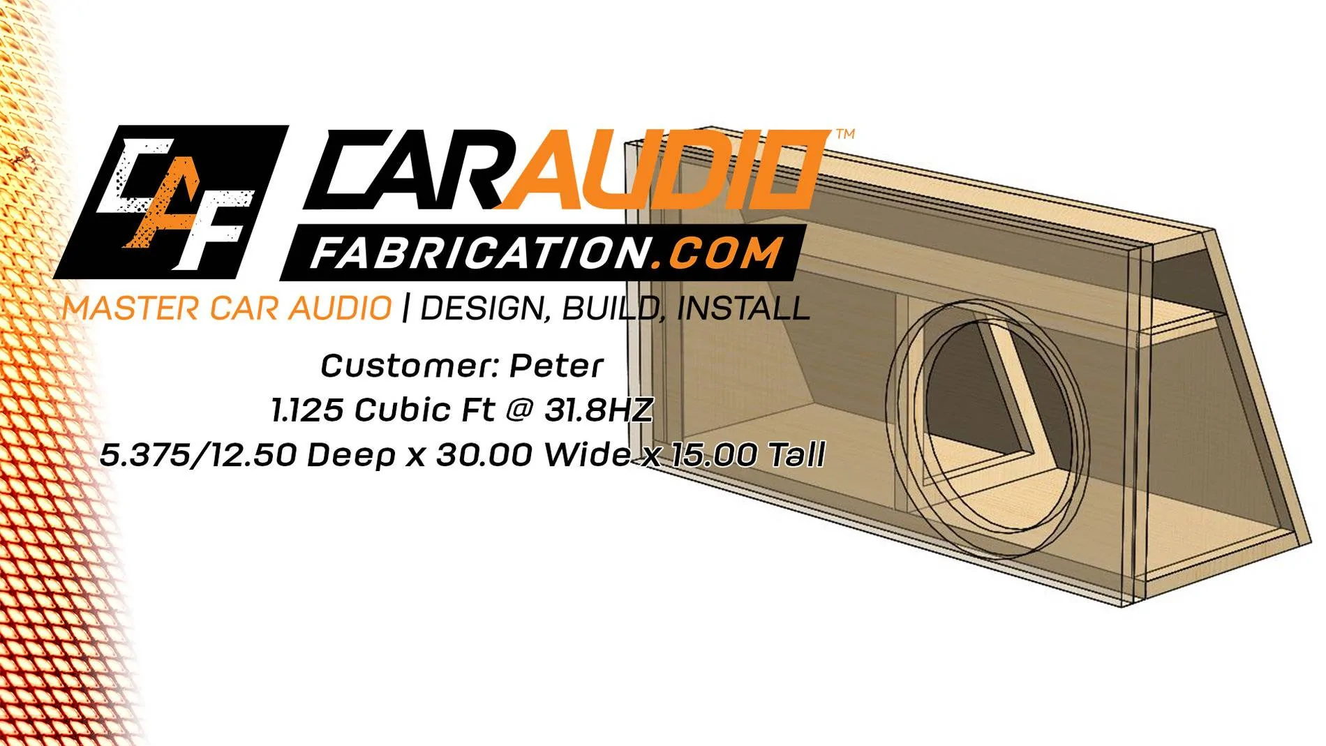

No threaded inserts, but put some metal brackets in the hollow area and bolt the enclosre through the metal into the brackets with two threaded bolts each. This way you distribute the force over a larger area and the shear force needed to rip it out is way larger due to the larger area, similar like Marc is doing in one of his videos (he bolts to the bottom, not the top, but the principle remains the same).
Got my blueprint from Marc last week. Friend of mine will build the box within the next two weeks. :)

:) I've watched that video at least half a dozen times. GREAT usage of the stock rear seat mounting locations. I'm very paranoid about the sub box moving (as if you can't tell) and possibly becoming a projectile in an accident. Nobody "plans" on getting into an accident...that's why they're called accidents!
Thanks for posting a pic of your custom build specs; your top/bottom measurements of the slanted back are within 1" of mine. Knowing my expertise with numbers, yours are probably better to go with. :frown: What sub are you using?
That's the same style box I'd have him design for me, if I went that way. I'm going to try and design it myself. This is probably the 20th box I've ever designed in my life...not my first rodeo.
I'm in the beginning stages of designing the box for my 12W6. I have the max overall dimensions (and the resulting airspace is too big...a good problem to have). But now I need to downsize the box while keeping the port the same area. You know how it goes. Change one dimension by an inch and the whole thing goes to sh1T. LOL! That, and I've never done a trapezoidal box before. Only your standard square boxes from tiny to massive.
The math SEEMS easy, but then you have to start making cut sheets and the angles and well, I'm not very good with numbers. You give me a diagram/schematic and I can fix it or build it. But numbers and I don't get along. At all.

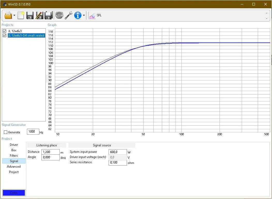

Remember, my box is for a JL 10w3v3, so a good bit smaller than the 12w6. Guess a ported enclosure for a 12w6 is a good bit larger, so i would think about going sealed for the 12w6, especially if you've got enough power to drive it. Go a little bit larger than recommended though. JLs usually like a bit bigger enclosures than specified by JL.
F.e. WinISD recommends 40Liters sealed instead of 29 as recommended by JL. Differences between both volumes are small though. If you add cabin gain you get an almost perfectly flat response down into the mid-20Hz. with a 30 liter volume enclosure in the simulation(don't know how many cu ft that is... we use the metric system over here ;)). And you can feed 700 Watts of power into the driver to reach Xmax at 20Hz.
