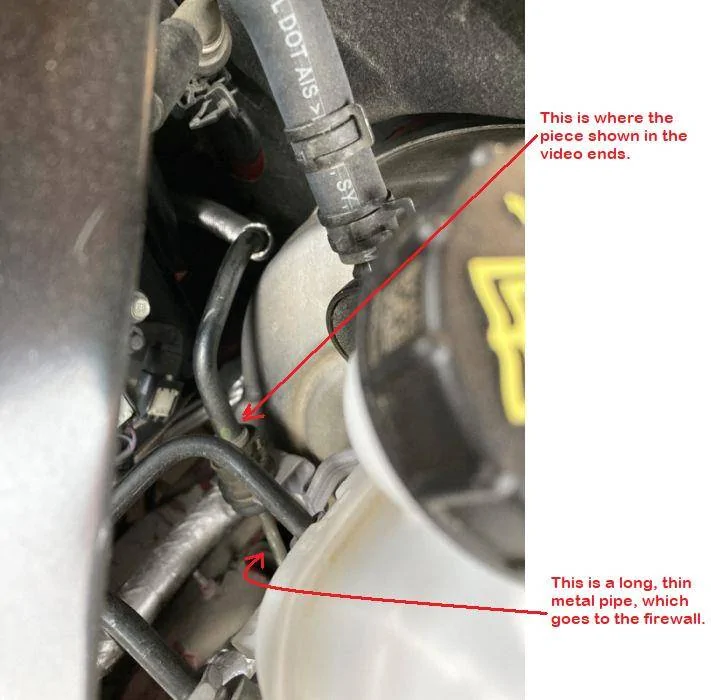

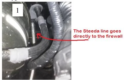

The instructions state that the line should be disconnected at the firewall. And indeed, one of the pictures in the PDF file shows the new stainless steel line going all the way to the firewall:
In the presentation video, the original line is shown beside the Steeda one:
But my 2020 GT seems to be a bit different. What I see in the latter picture, namely that black, crooked rubber tube partially covered in heat insulation, doesn't go to the firewall. Instead, it goes into a thin metal pipe, which in turn is connected to the firewall.
So, now, my questions:
1. I guess that in this case the instructions should not be followed literally, should they? I mean, there's no point in disconnecting the metal pipe from the firewall and replacing it together with the rest of the line. Instead, I should keep the pipe and disconnect the rest of the line from it, and connect the new line to it. Right?
2. The existing clutch line doesn't look or feel like rubber. It feels like hard plastic. It doesn't look like it might expand and inflate like a baloon, like Steeda says. Not at all. It may not be made of metal, but it still looks as sturdy as it gets. Did they perhaps change it in the 2020 MY? If so, then does it still make sense to replace it with the Steeda line? I wouldn't mind buying some insurance, but will I really need any extra insurance, given how sturdy the existing line already is?

I've asked Steeda. I'll leave their answer here, in case other people have this dilemma in the future and stumble upon this thread.
"S197 cars had the firewall connection to the left(outside) of the brake booster, S550 connect on a bracket to the right(inside) of the brake master cylinder/booster. Do not remove the bracket for the install, simply remove the retaining clip/pin at the line connection and remove the line.
The rest of the instructions will be the same for both model cars. The clutch line will be slightly longer than the factory line due to flexibility in mounting and the need to have just one part number for the S550 model."
