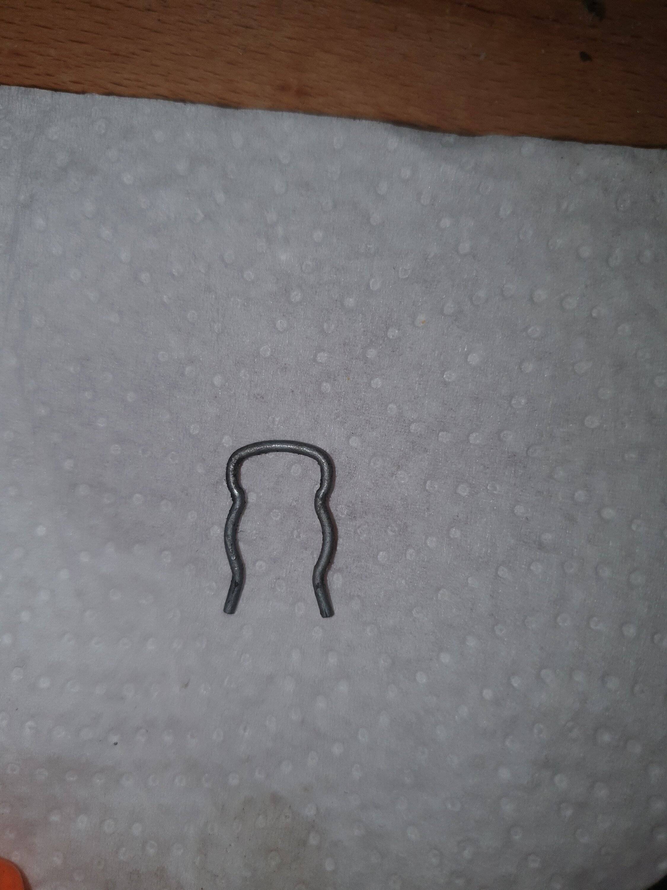

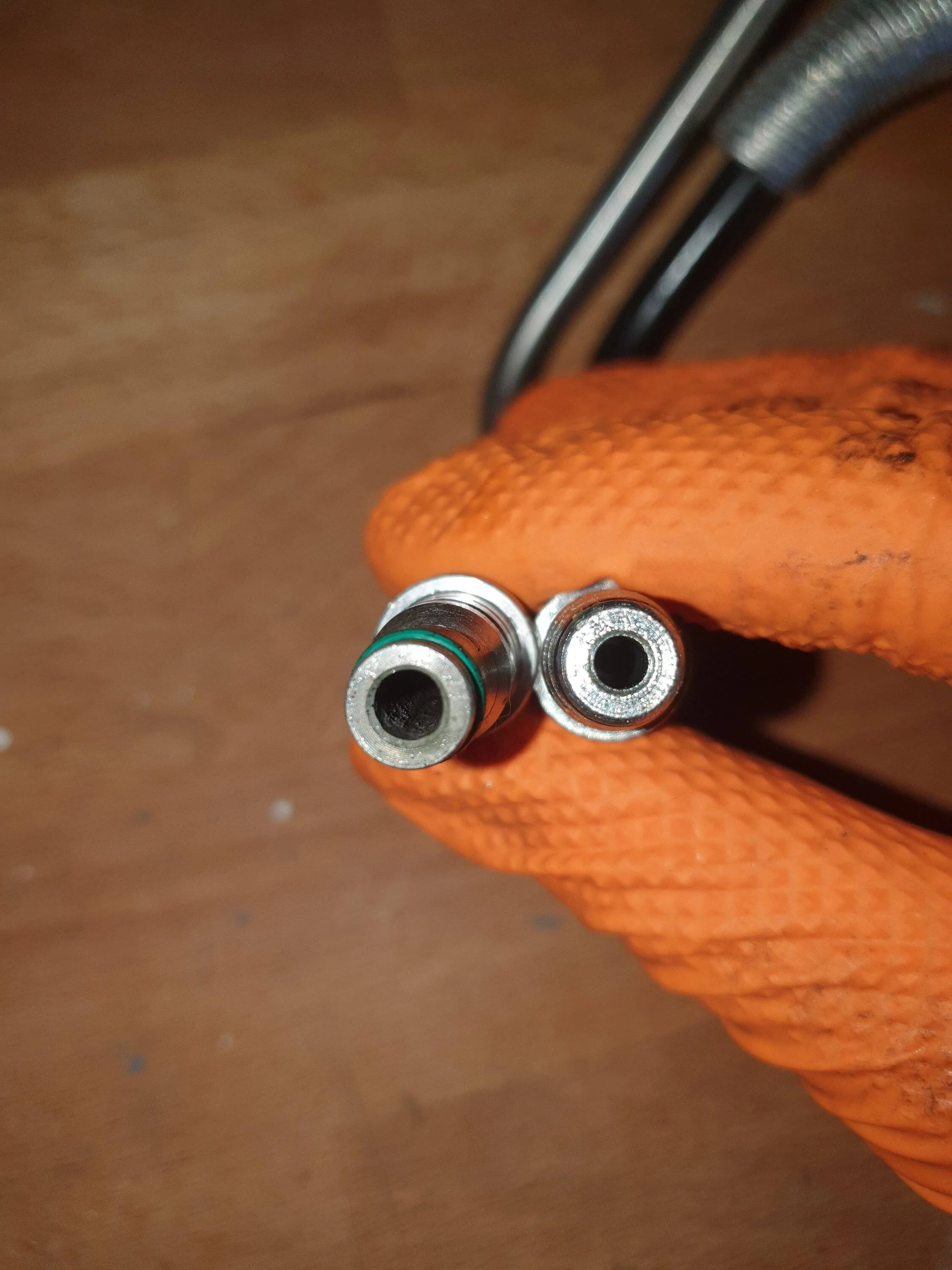

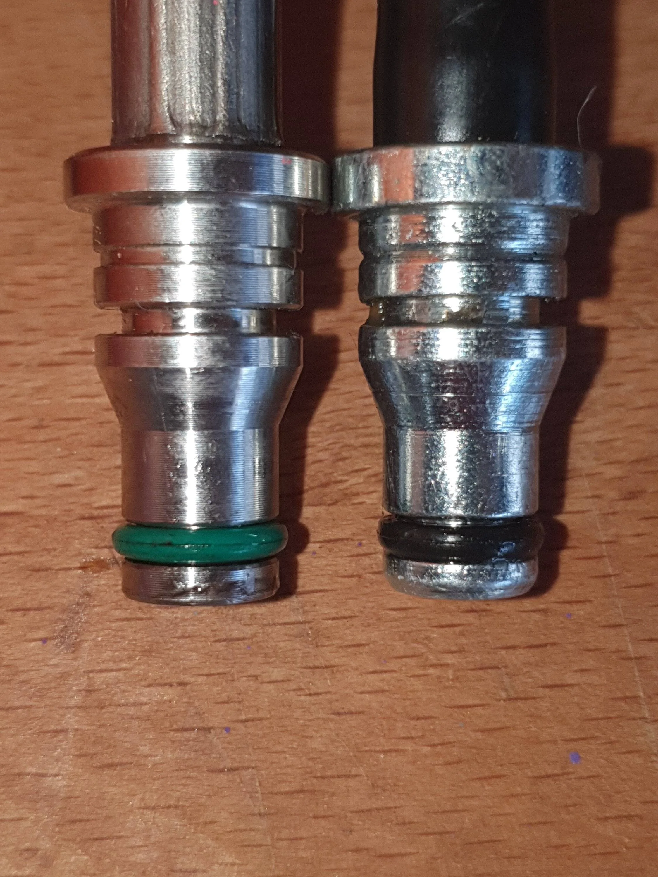

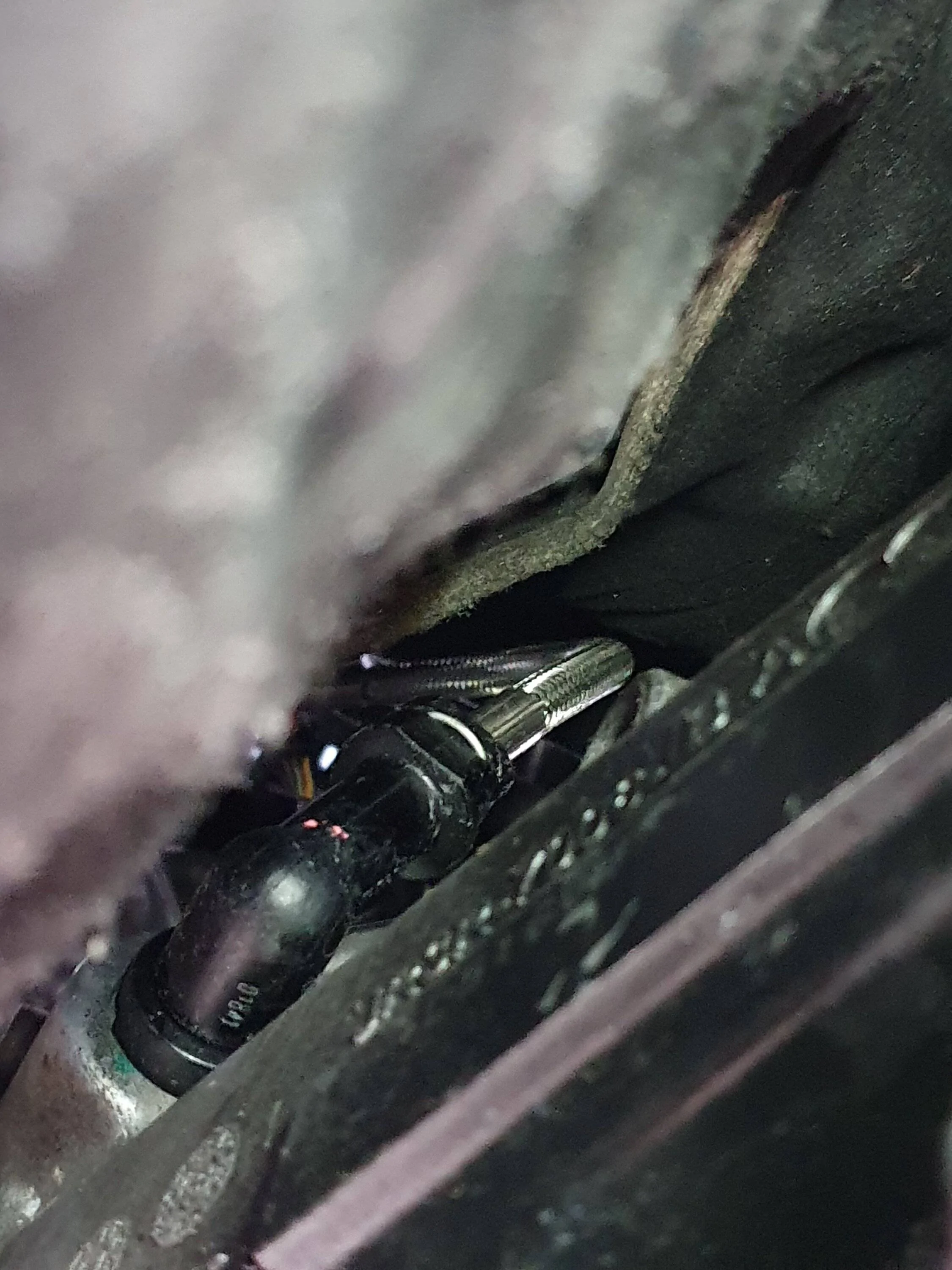

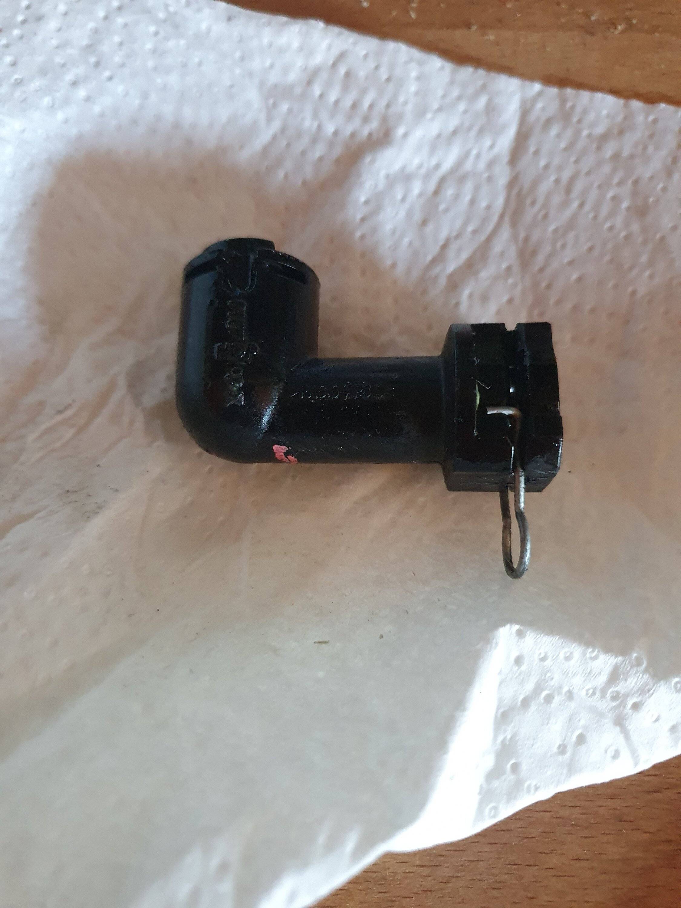

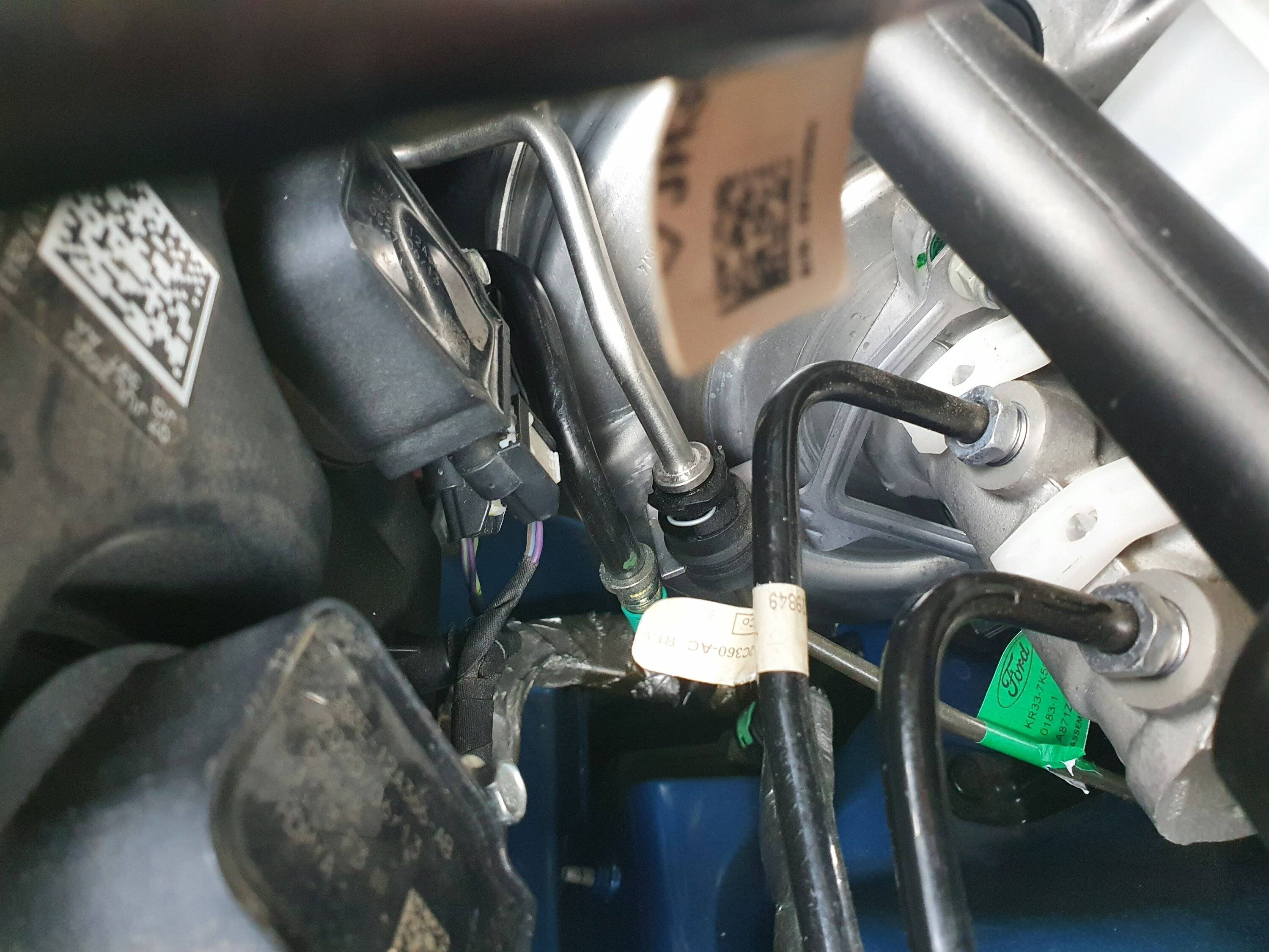

I have installed the clutch line by J&M Products a few days ago. Nice product and not too problematic to install. Gives you more consistent shifts but it will not solve all shifting problems. Next step is to switch to a new transmission fluid and after that will try to get a new clutch eventually but that will happen next year.
left: j&m, right: oem
small clip that is easy to lose
angled connector:
clutch line installed at top side (the oem line is still attached):
clutch line installed at bottom side:
if you want I can post a video in which I remove that clip while it jumps happily into the darkness hiding somewhere on top of the transmission.
