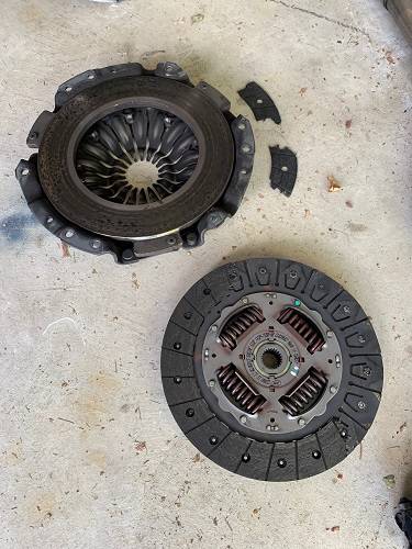

I below out something last night at Track Night. I missed 2nd to 3rd, got in to 1st, realized what happened, jammed the clutch back in. After that I had full pedal but it wouldn't shift well, had to speed match to get it back into to gear. So I assume the clutch wasn't disengaging. I finished the session. The clutch held fine under acceleration. When I drove home, I had to start it in gear, it would creep a little bit, then the pedal kind of had "pop" feeling and went to the floor and after that now only the last 1" or less of travel feels like its "trying" to disengage but it doesn't.
Sounds liked I might have blown out the throw out slave cylinder after reading these threads on this type of issue. I don't see any fluid leaking anywhere.

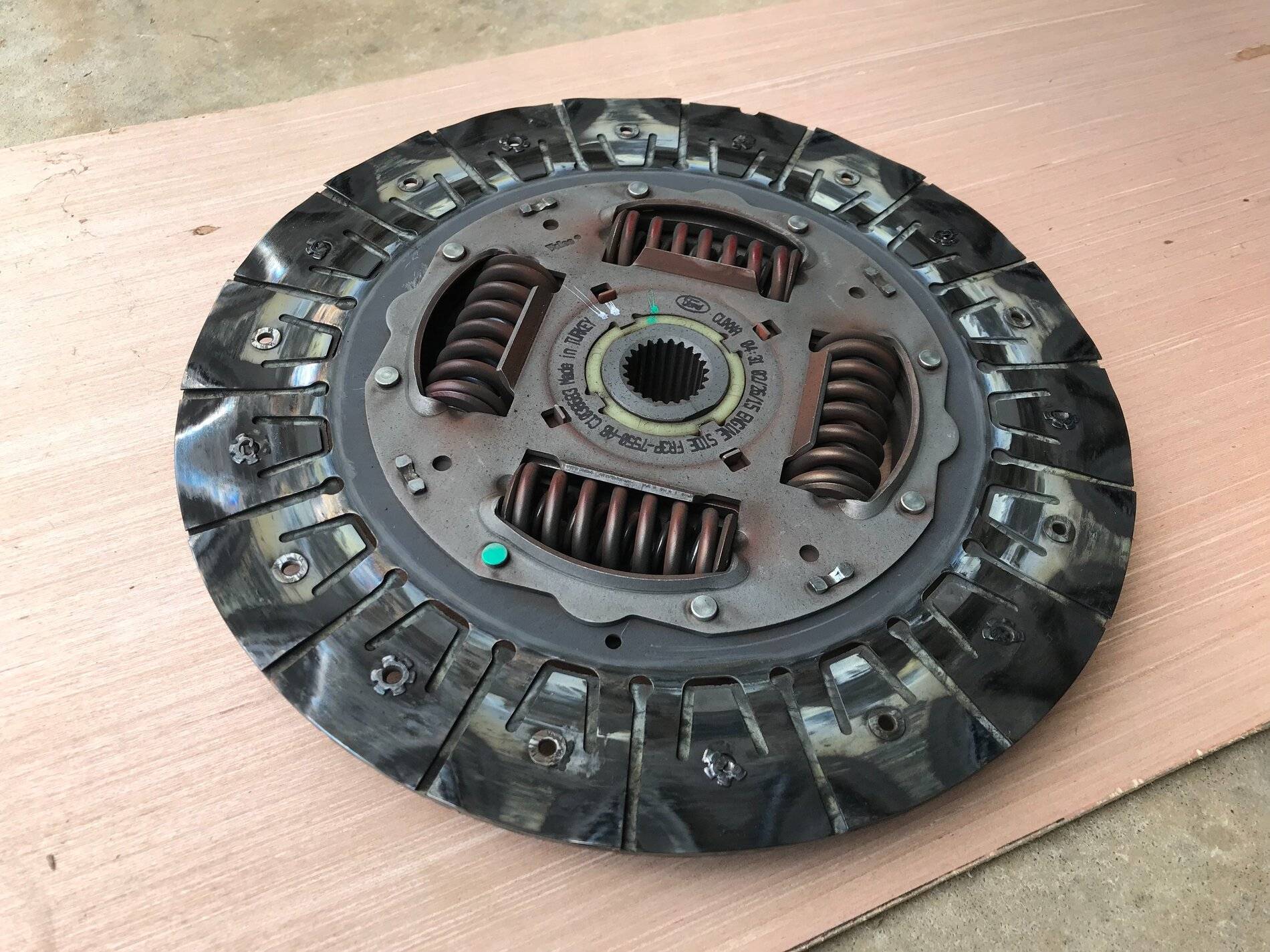

Stock clutch? My guess is high RPM shift north of 7000. Similar thing happened to me. Friction material was jammed in between pressure plate and flywheel allowing me to drive home.

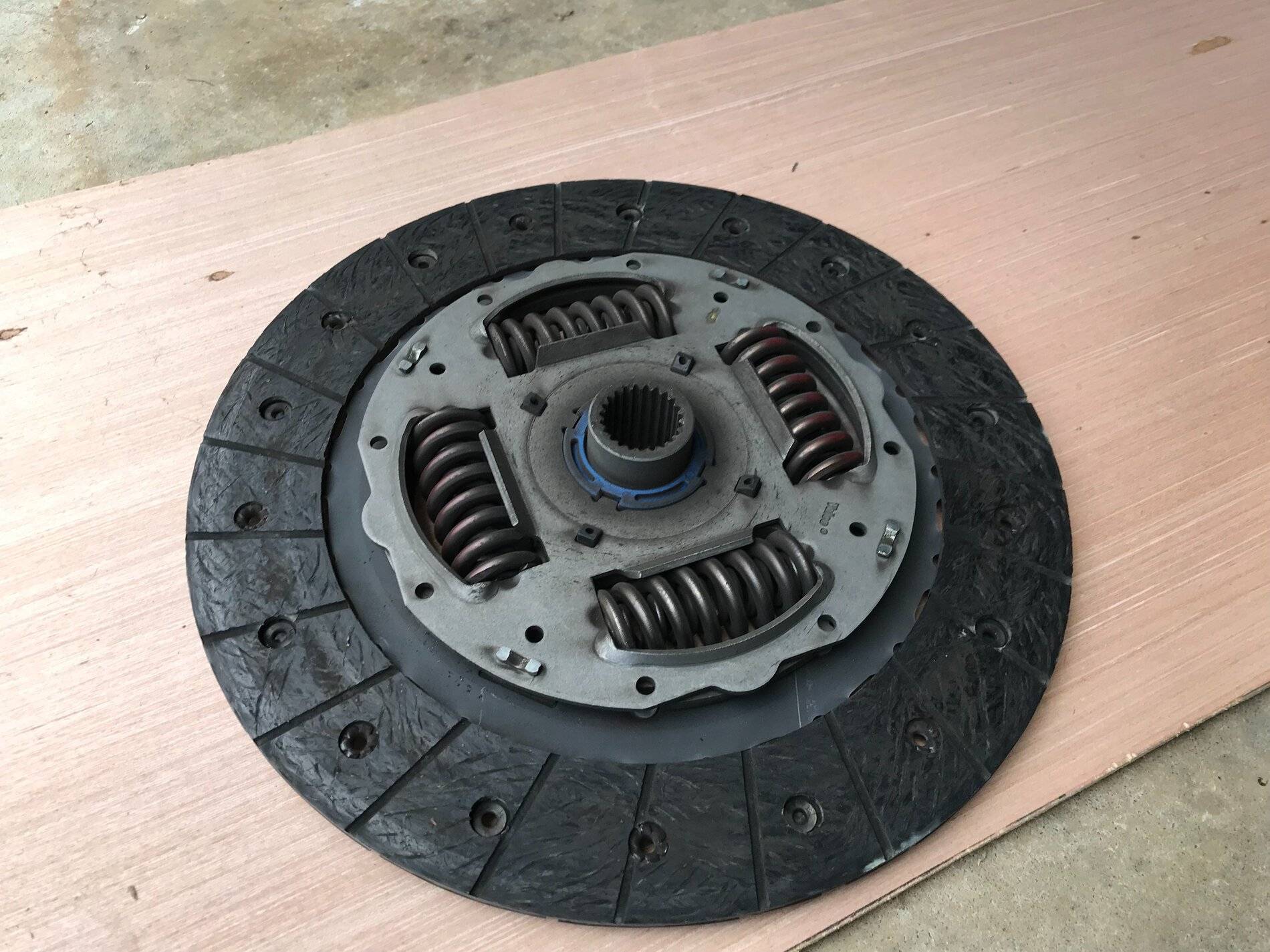

Quite easy to kill the stock clutch on the track..
Vaporized one side of the clutch plate..!!
